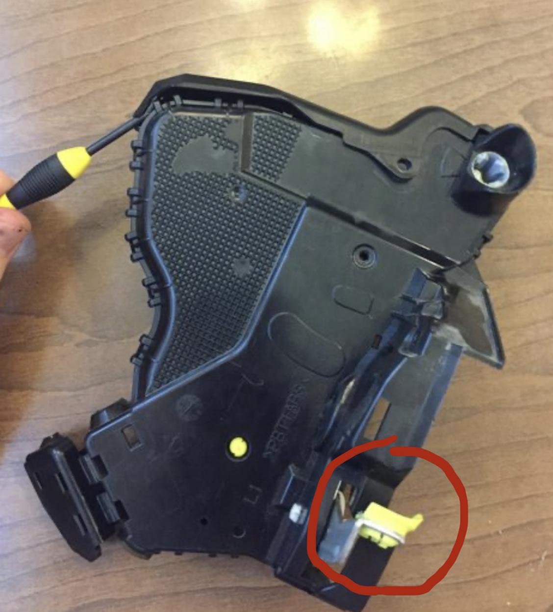

Edit: Not so fast my friend! I had the issue where my door wouldn’t open from the outside. I could hear a “clunk” when I tried to do it. The rod that dangles down from the exterior opening assembly has to fit into the hole that I’ve got circled in the picture below. I DID have to take the panel back off, peel back the weather proofing plastic, and take out the torx bolts, but didn’t pull the actuator back out (obviously). Hope this helps if anyone else has trouble.
On a prior page I followed up to another member using my write up which mentioned the need to line up the physical door handle rod, but it is easily looked over!
The exact posts (I didn't take pics when I fixed this step) from the other member (@mo8ftbl - great assist) are: https://www.toyota-4runner.org/2856103-post24.html and https://www.toyota-4runner.org/2811228-post22.html which explain that you don't have to take the panel all the way off again - just remove the grommet in the door to view/access the aligning of the rod within the plastic housing in the actuator. I will update the original post to make this more clear!

Swapped my driver's door actuator today. If you follow this guide, especially the pro tip about taking the locking mechanism out so as to make inserting it back into the new actuator a piece of cake, the whole process will likely take you less than an hour. The most tricky part if there is one is putting the panel back on, specifically the initial hanging of it on the ledge.

I had the "key doesn't work after I put the door together" problem, but I could not understand the sequence of pics in this post, I think it's me, because this thread was very helpful. I replaced the door actuator 2&1/2 years ago, but been too busy to really work on this... now, with covid-19 things are a bit quieter...
In case someone else has the same mental impairment...
You see the pics in this:
So, what I figured out after I took the door panel off again today, is that when you unscrew the torx thing "all the way", the part of the outside door handle that the key goes into comes off/out... now that I know, the pic in the post referenced is very clear... anyway, then you line up the cross/X at the end of the key part with the socket, maybe put the key in & wiggle a bit while pushing in, and bingo, now the key works... tighten up the torx and all good. I just had a mental block when I read the posts & looked at the pics.
Now, however, the inside door handle does not work... <sigh> I took the panel off 4 or 5 times, and it seems like the ball at the end of the cable is getting pushed forward out of the socket it's supposed to sit in. I can push the cable in & set the ball in place and see how the lever pulls it & pushes it... just seems like the ball is not captive enough, perhaps a piece of the ball cage broke off...?? time to look at some pictures again, zoom in, search the forum.

looked at some videos, last one on youtube by tacotunes (thanks!) about removing the door... and I realized that I had switched the cables. Green goes on the bottom. Careless of me... but anyway, all's well that ends well. I can use the key & both door handles work. <sigh>

If you go this route, make sure it is working before you close the door and put the panel on. My first one I did perfect but my next one I messed up. Luckily I didn’t put the panel on so I was able to break apart the housing and release it with a screw driver. I needed to buy a actuator from rock auto anyways. If I do it again, I am buying the whole thing from rock auto instead of replacing the small piece that fails.

As for lining up the rod into the latch/tumbler, if you remove that grommet, you'll be able to look inside the door and see where the rod meets up with the physical mechanism. It's kind of a funny shape (if I recall correctly) and the rod has a little jog in it. Just make sure you get that bottom piece into the hole on the internal mechanism, and I think you'll be fine. I'll see if I can pull the grommet in a few and take some pics for you so you know what to look for.
