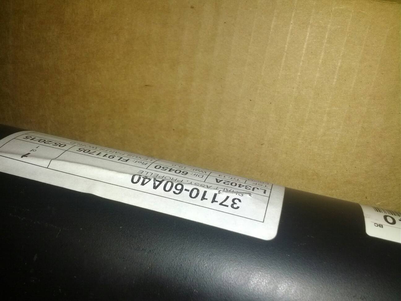

Received my driveshaft on Friday and made an appointment for Wednesday. Hopefully once the dealer installs this, the noise will go away. One thing I noticed is that there is a staple on the shaft over the dealer destination sticker. Hope it doesn't cause any issues uploadfromtaptalk1433159665698.jpg

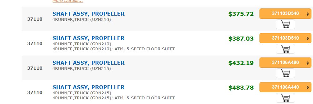

Looks like there are about 4 different versions of this driveshaft, maybe for the different drivelines (2WD/4WD, V8/V6?). Did you order the part by using your VIN? This is just an idea, but from previous posts it looks like you ordered this from a Lexus dealer. The Lexus only comes in V8 driveline, you have a V6.
All the previous post suggested the 37110-60A40 part so I went with it and did not order by VIN. Also I just saw this thread about this part on a v6 and KC4x4 saying that this part is to short. applying lexus drive shaft tsb v6 4runner get rid clunk
The correct part I need after speaking with the service advisor is 37110-6A440 and looking at the attached image it is the most expensive. so technically my dealers part price was not too off.
