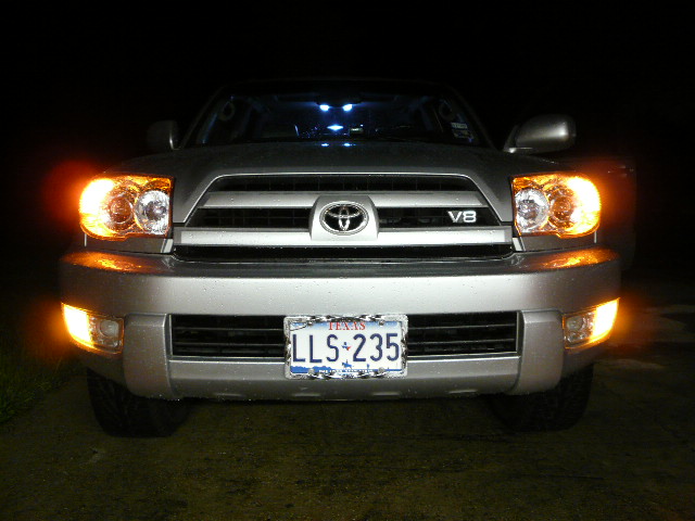

I got around to doing this the other day after I remembered that I had the extra sockets that came with my replacement DRL/signal lamps since my others were cracked when I bought it. I moved the DRL sockets from the factory lower to the upper ones ( I changed out the 03-05 headlamps and put in the projector headlamps ) then with a little solder, wire and loom, I hooked the lower ones up to run with the parking lights.
So let me know what you think. I will be doing the rear fogs soon.
Here's the pic
