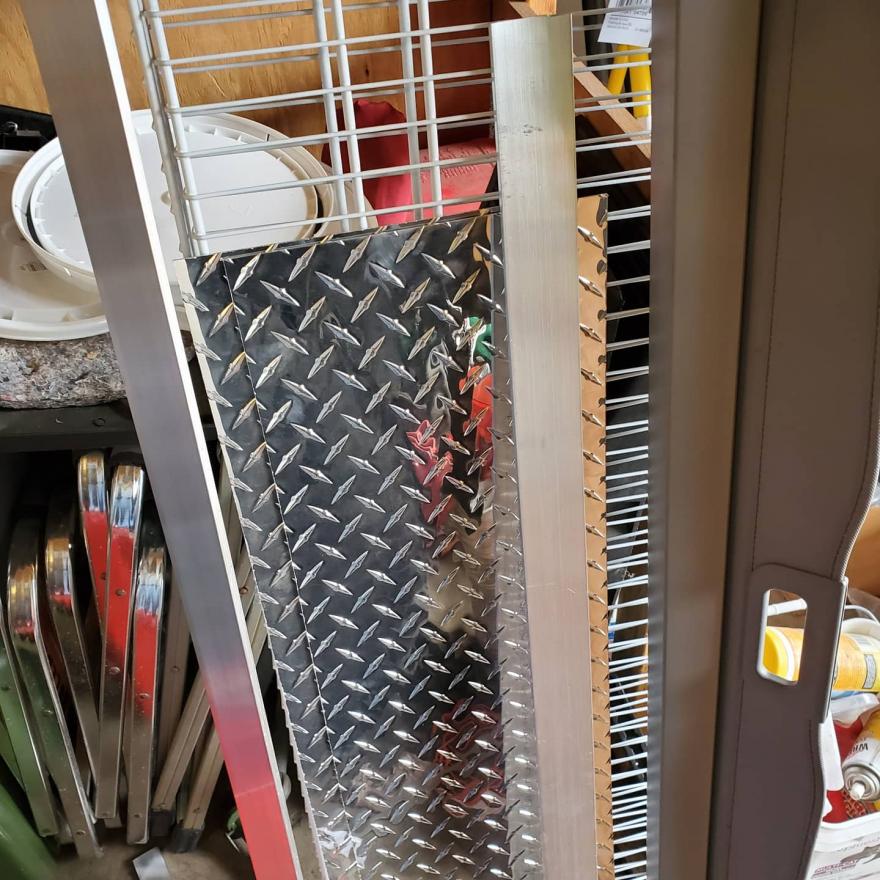

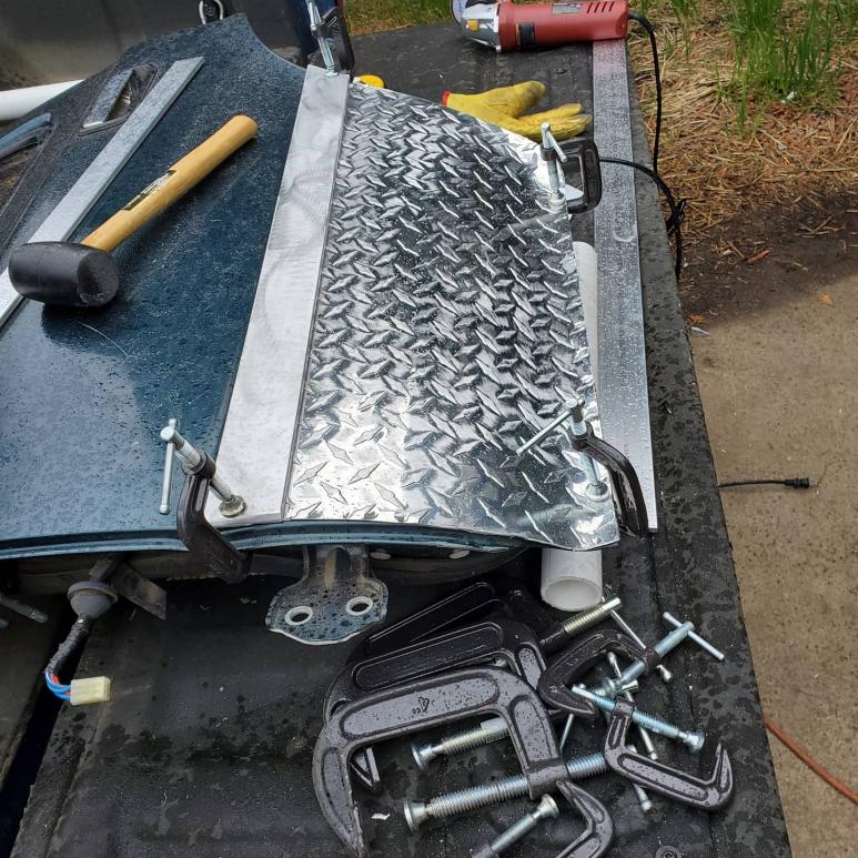

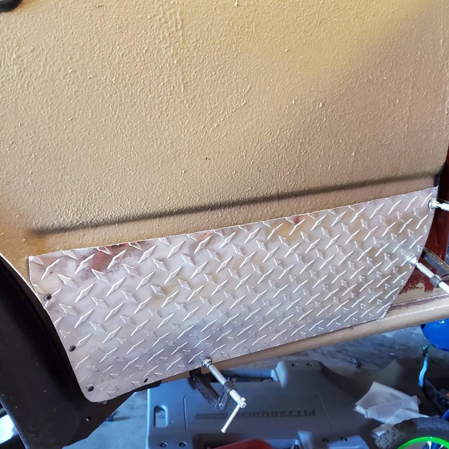

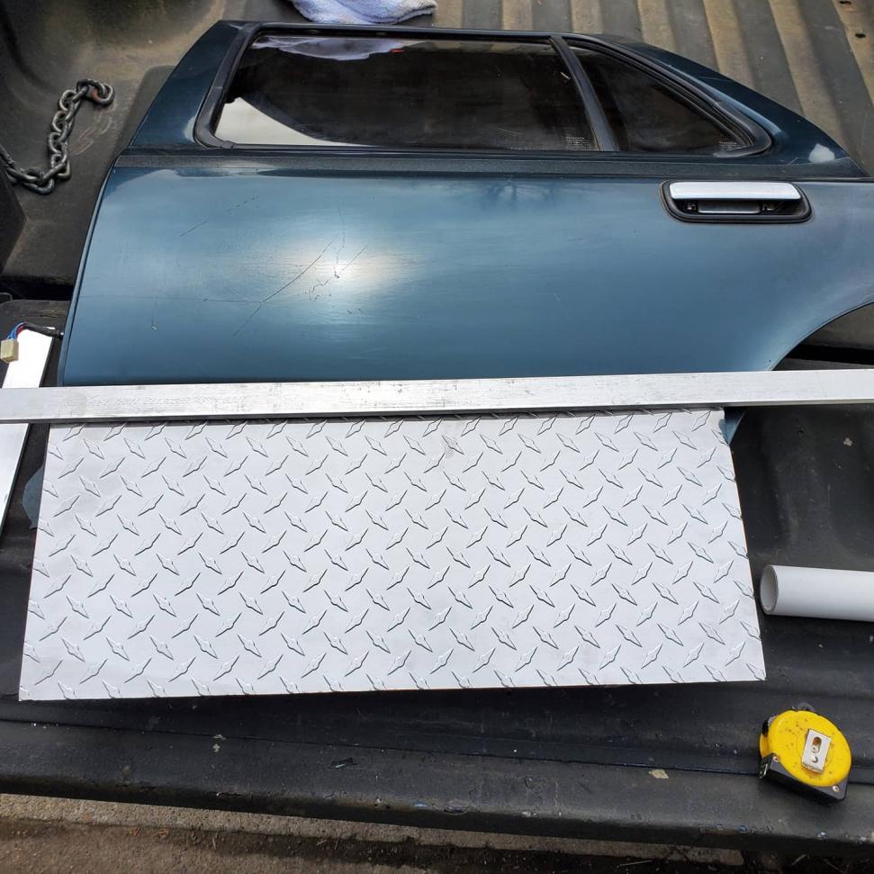

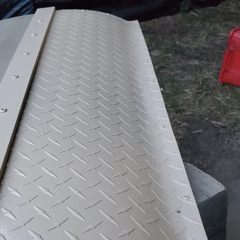

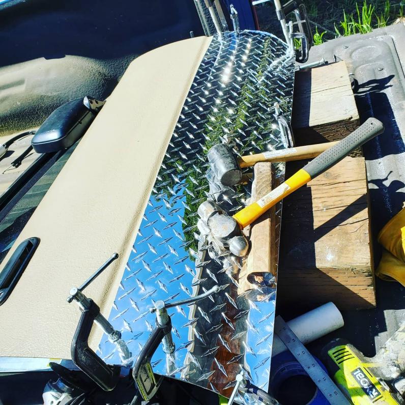

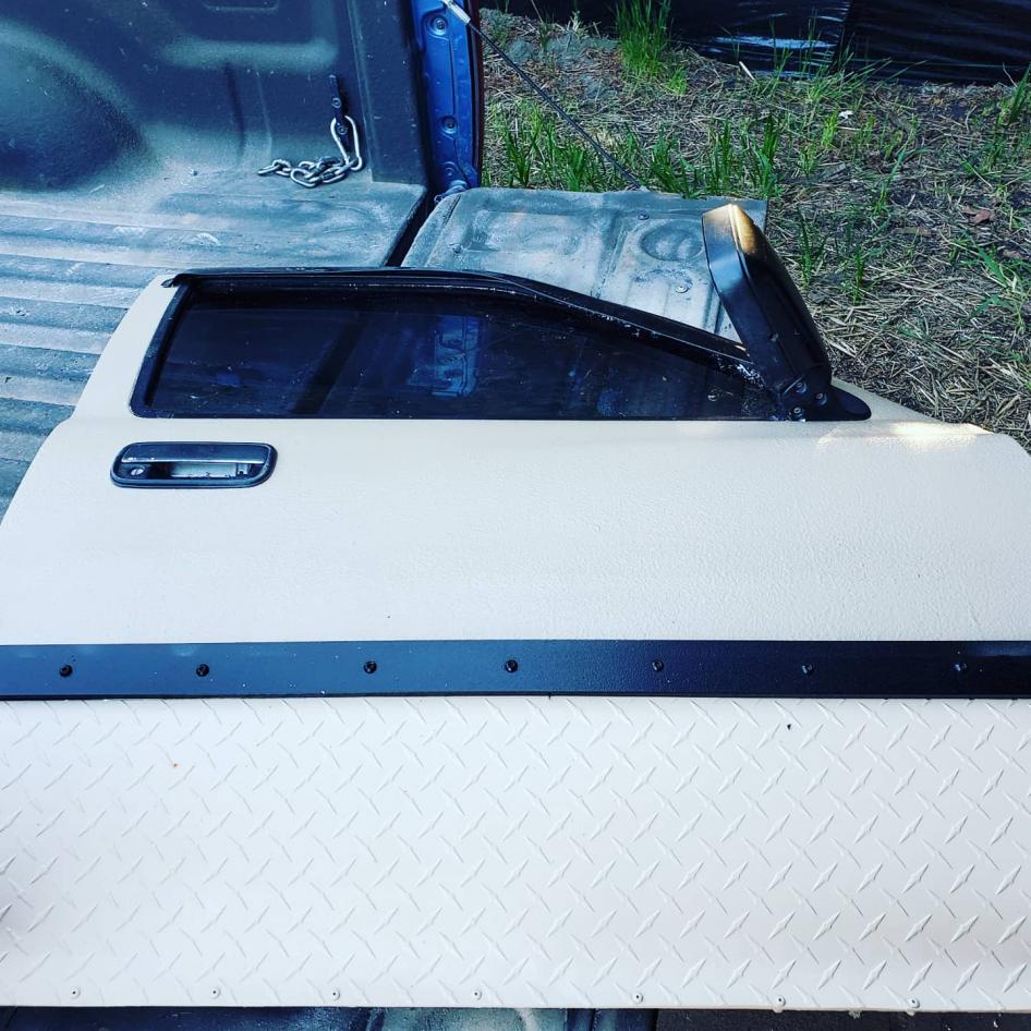

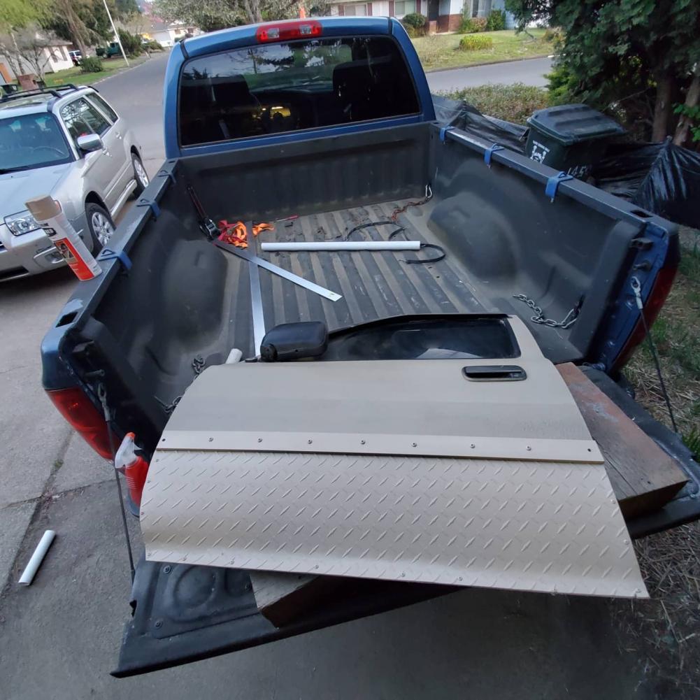

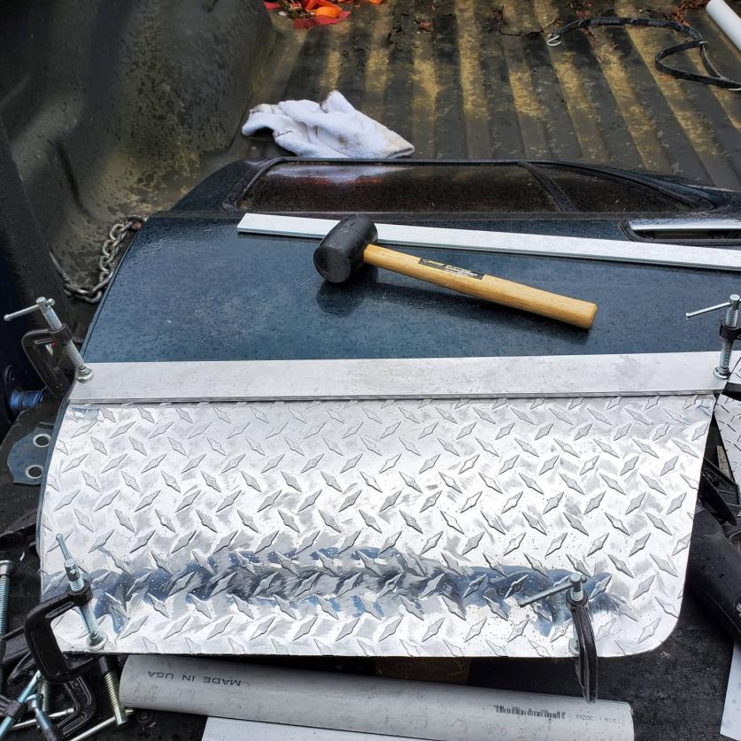

Got bored and decided to see if I could form some diamond plate to fit the curve of a door.
For years I have liked diamond plate on the lower part of a door.
Busted out an extra door to use as a form, a rubber mallet and some clamps. Pound the aluminum and than cut to fit.
It actually fit the curve of the 2nd gen door pretty good.
I used some 1/4" thick aluminum stock to act as sort of a door slider for idiots in the parking lot. Borrowed the door slider idea from [MENTION=67615]Dirtco[/MENTION]
I'll need to strip the aluminum later on since I got a little impatient and didn't wait long enough for the paint to dry.

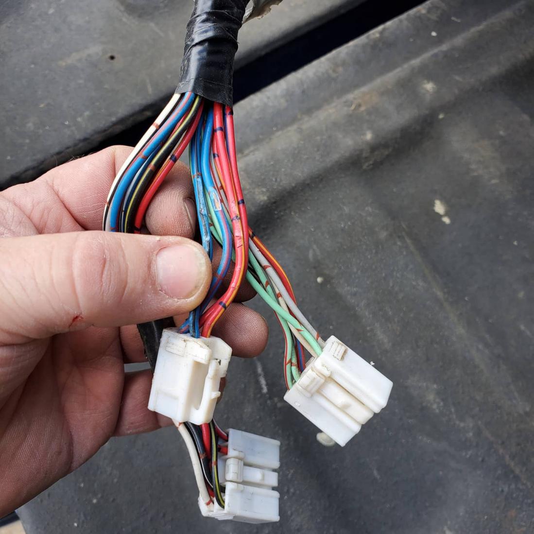

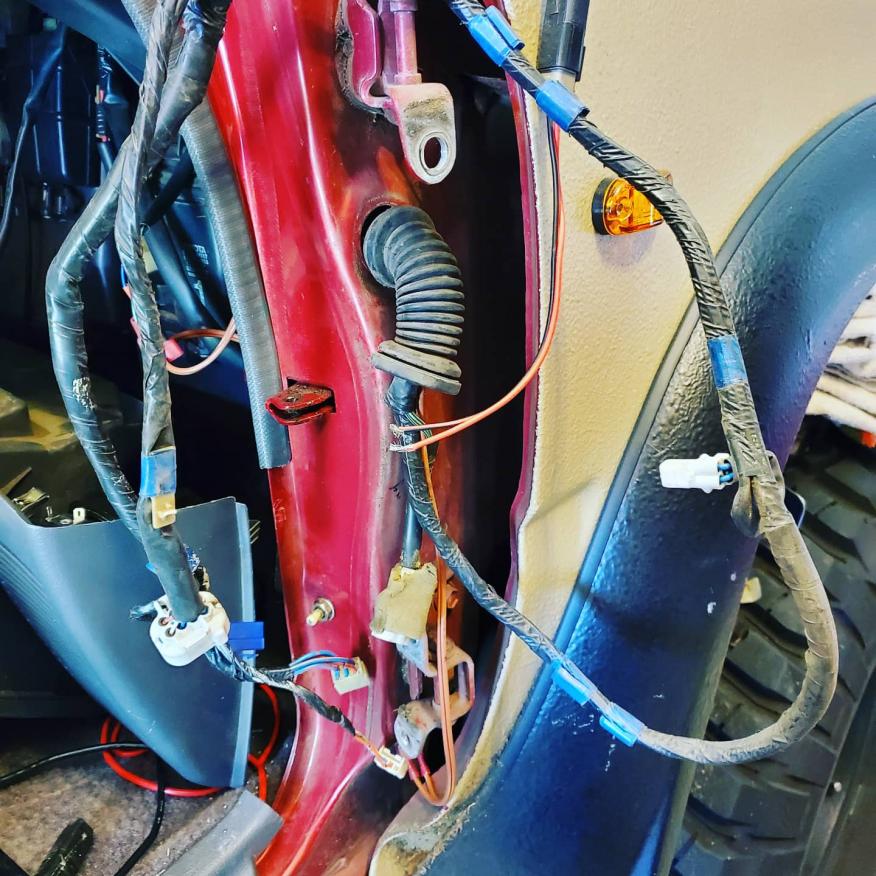

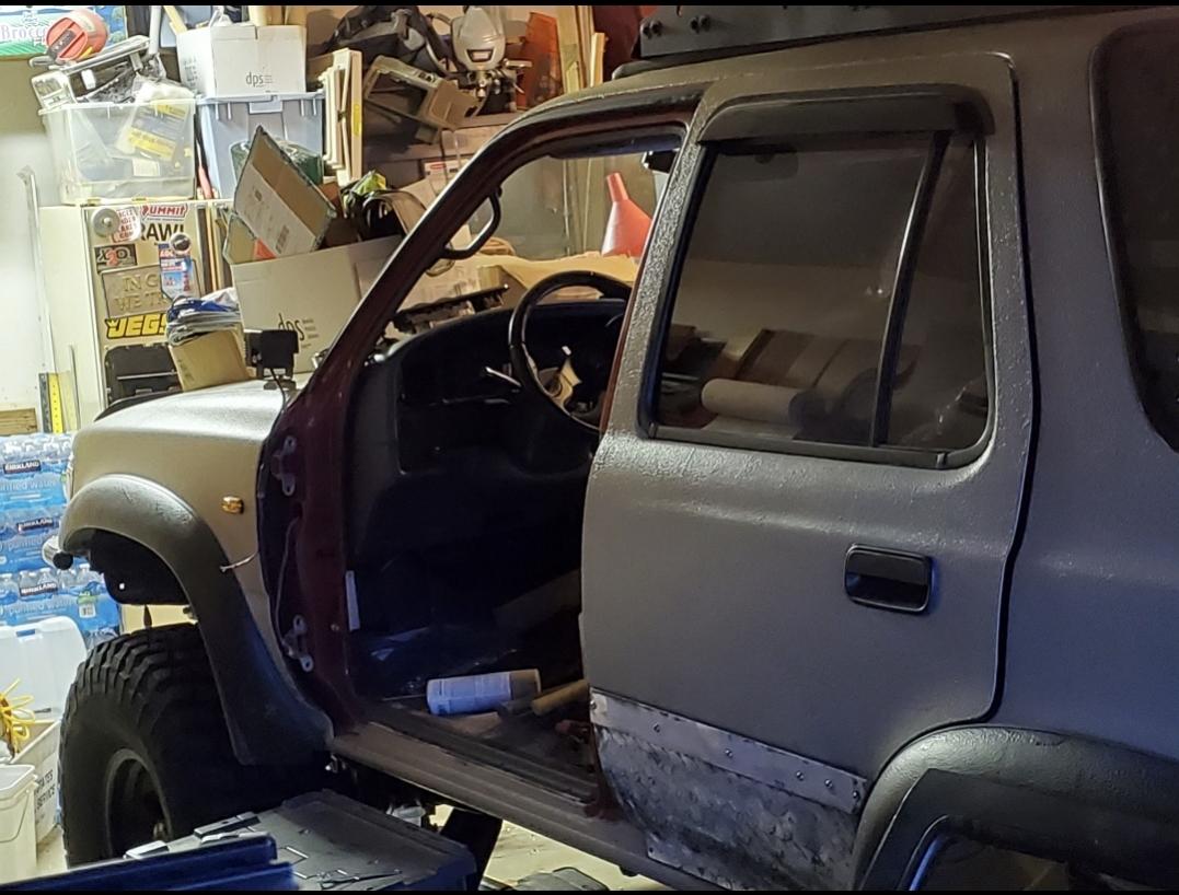

Got a late start working on the totally unnecessary diamond plate on the 4runner door project today.
Ended up taking the driver's side door off. And of course forgot there is 3 plugs on the door harness instead of 2 so had to fix a couple of wires I accidentally stripped.
I took vacation tomorrow from work so hopefully I can get this door back on and at least one other door done.

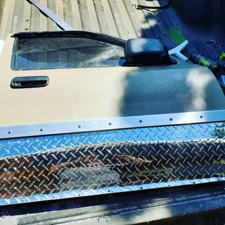

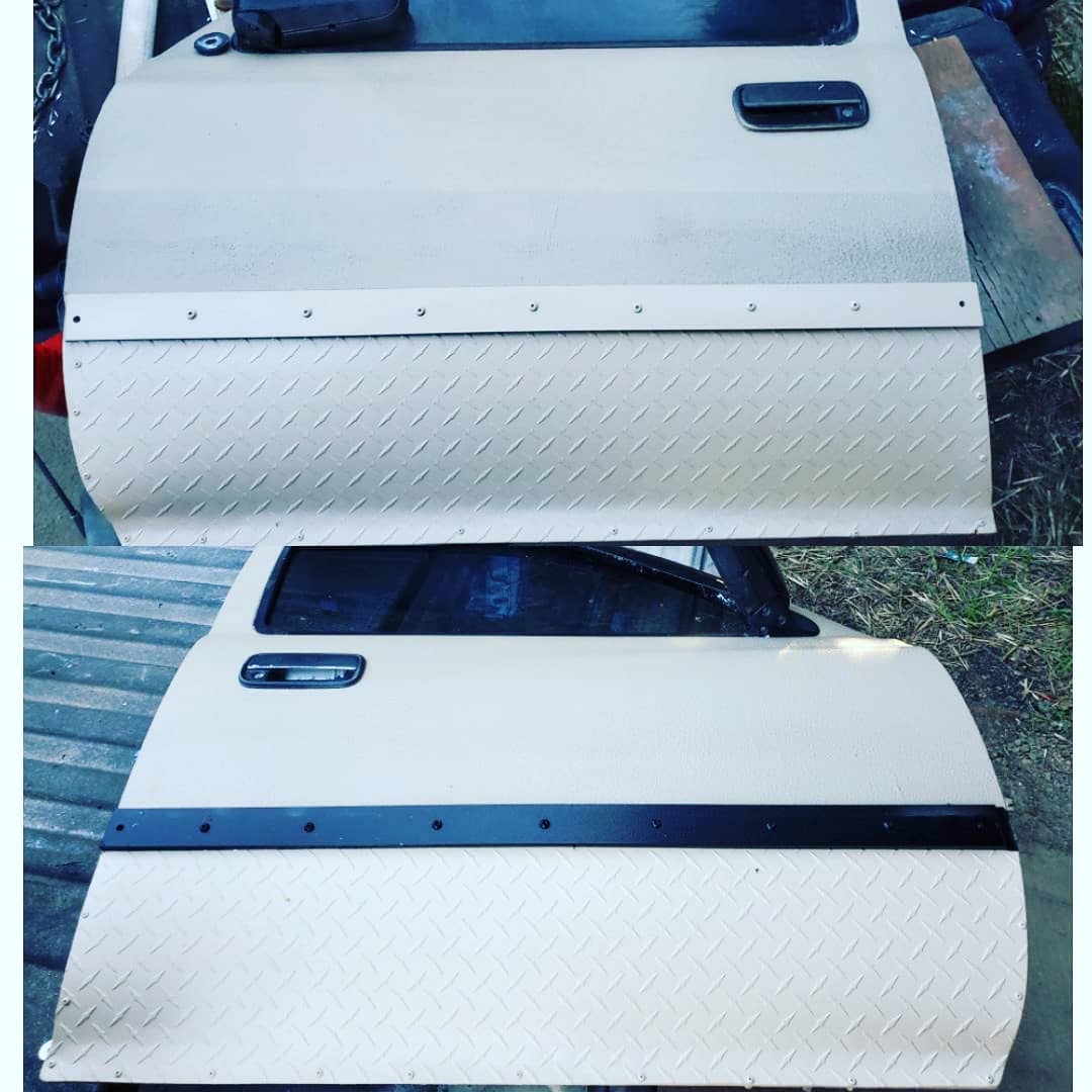

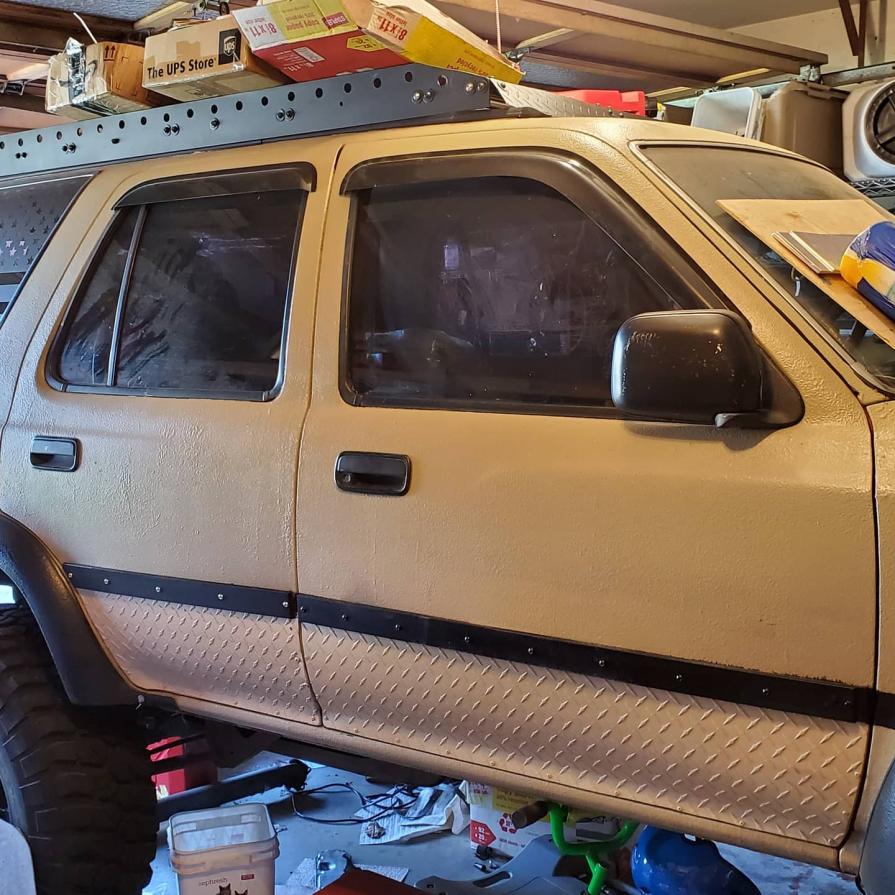

Day 3 of the #covid19projects that is totally unnecessary but keeps my mind off the BS of the world.
Tried to pull the passenger side harness from the firewall but looked like I would have to pull more of the dash than I wanted.
So plan B was to pull the door harness out of the door.
Gonna be a pain to re-install but oh well.
The diamond plate I had left over was a bit thicker than the stuff I used for the driver's side so had to use a bigger hammer and a piece of old railing. Beat it into submission and it seemed to fit the curve of the door nicely.
I almost wish I had left it polished, looks good..if i hadn't #monsterliner this thing i probably would have left it.
The missus suggested painting the door slider black. Actually sort of like it so I may hit the other two doors with it.
I only work 2 days this week so will hopefully have this thing wrapped up

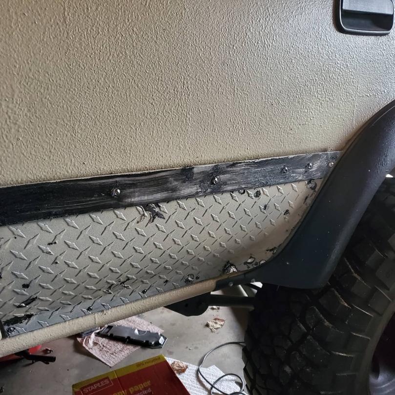

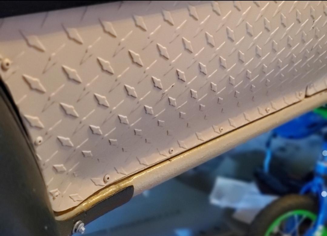

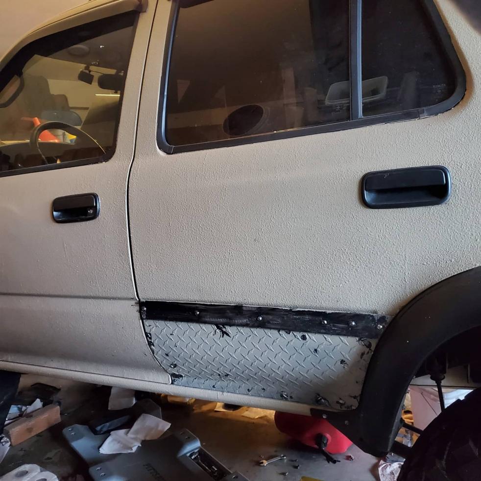

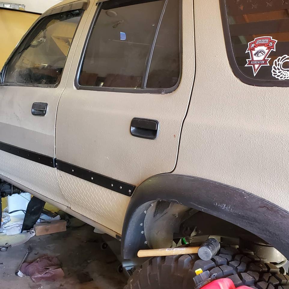

Got the front doors hung and the wiring harnesses back in.
on the passenger side back door I decided to see how it would go forming the aluminum with the door still on the truck. It was a pain in the ass but actually went faster..
Not perfect but I like the way it came out.
Door sliders should offer great protection from people in the parking garage at work. It was one of those fun see if I can do it sort of projects to keep my mind off the BS of the world.

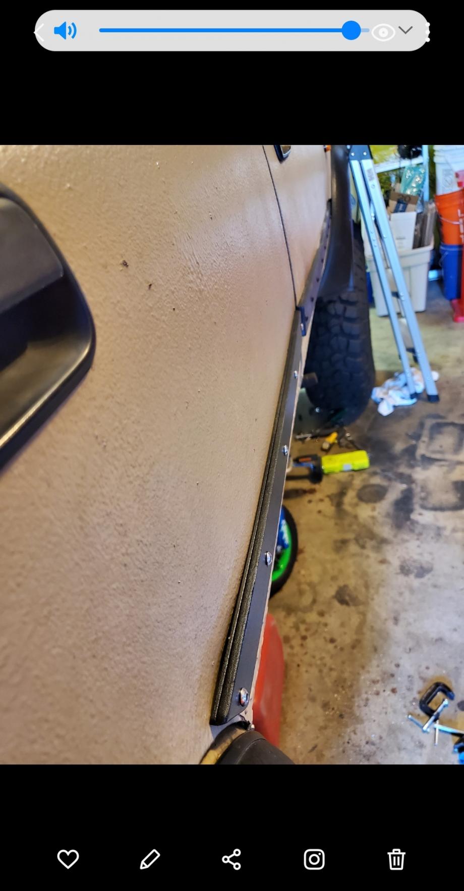

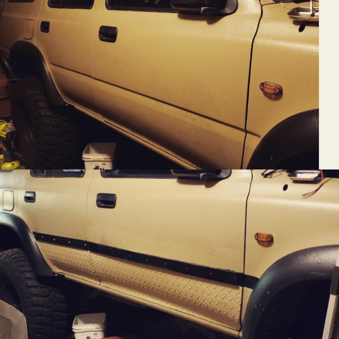

found an older side shot so did a comparison.
other than some of the black bleeding through i like how it came out. I will probably order some more desert tan monstaliner down the road to do the rockers

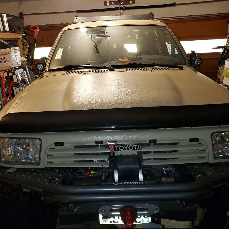

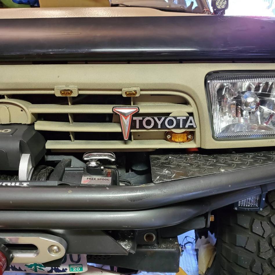

Swapped grills this morning, trimmed it a bit tighter around the winch solenoid box
Got the 81 Trekker's grill emblem in a better spot

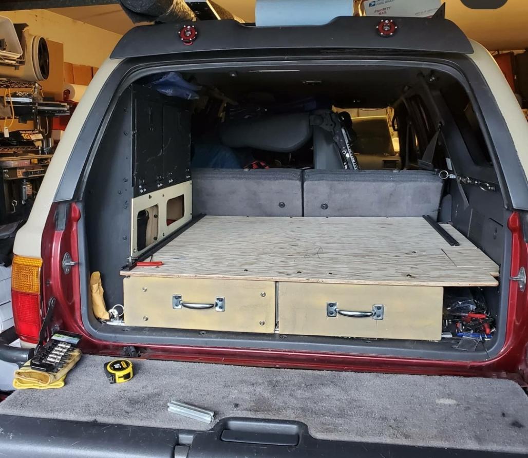

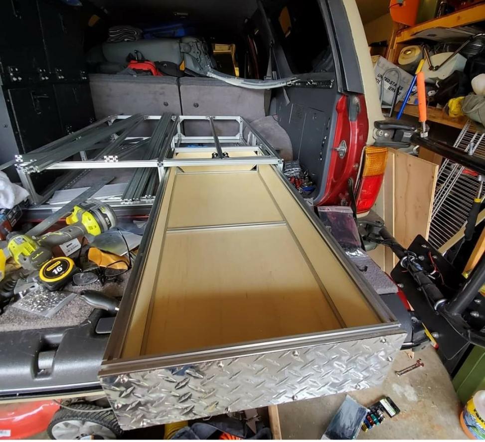

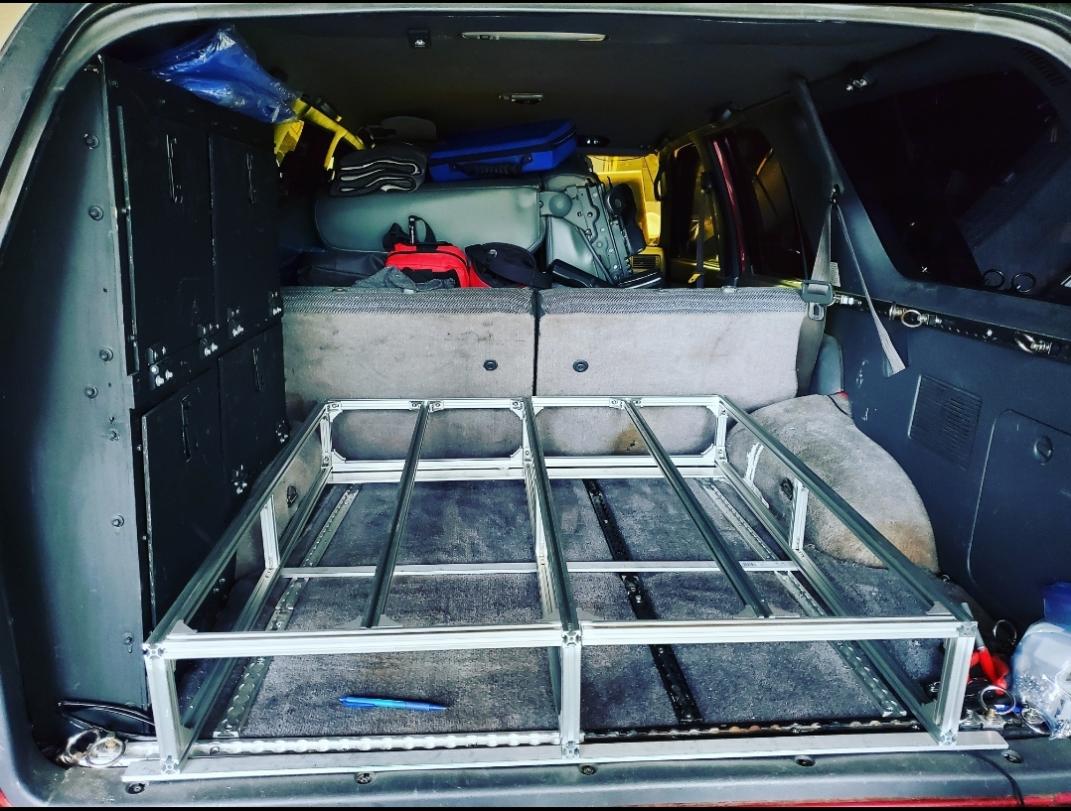

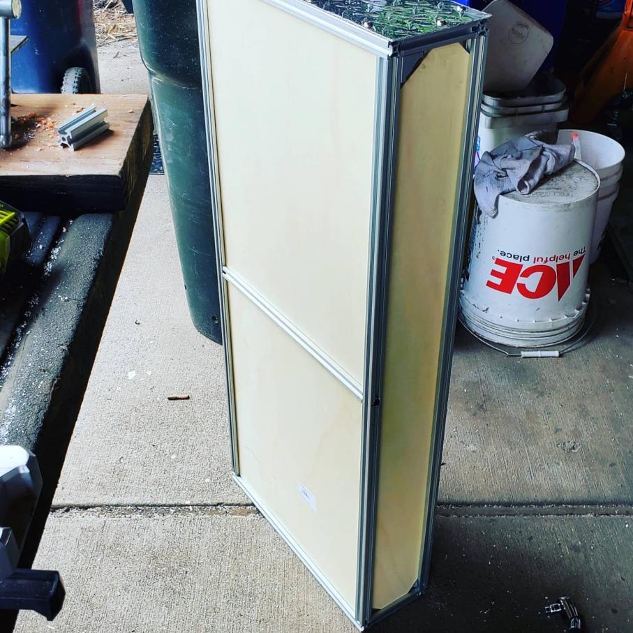

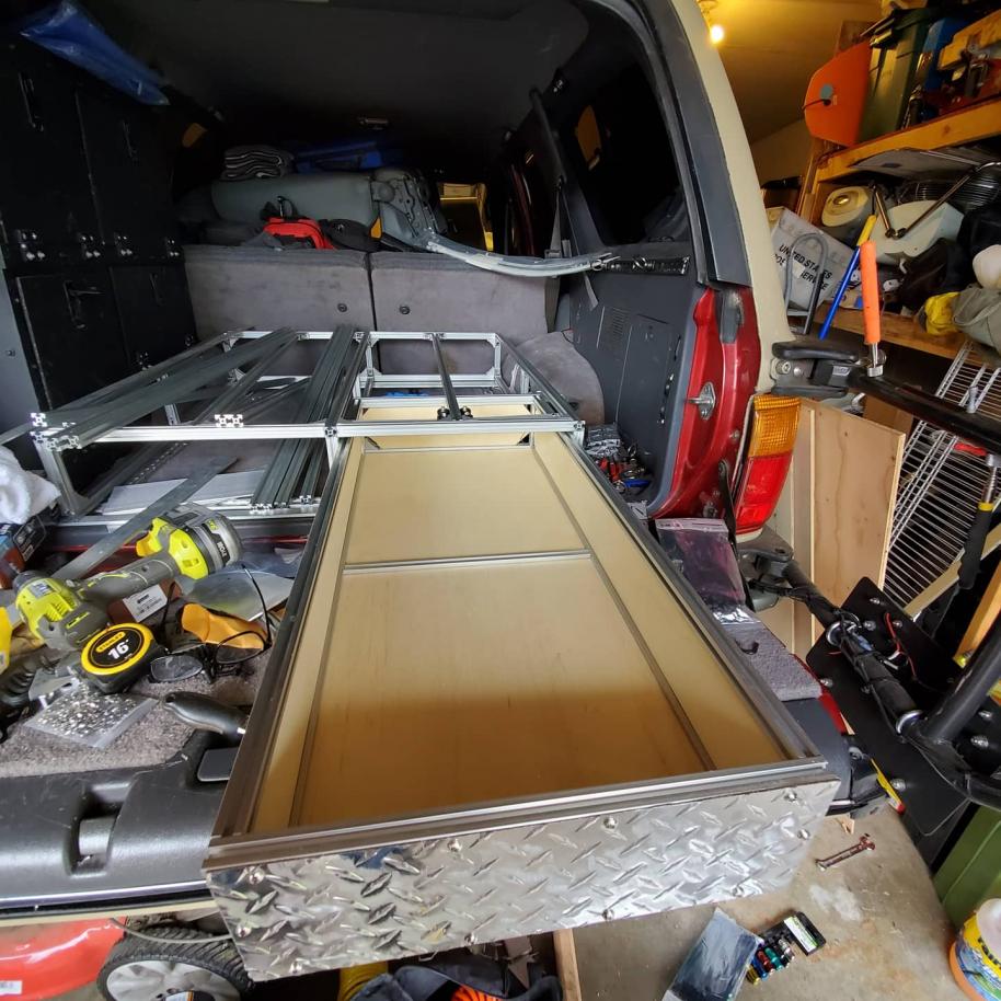

Also had a pile left over 8020 so Decided to give building a drawer unit a shot.
2 drawers, will end up being 16"x6" x 38" deep.
It will be low enough to still get Kenai's crate on top of it and still have head room for sleeping in the back.
I think I will have enough material left to extend it for a sleeping platform with storage underneath.

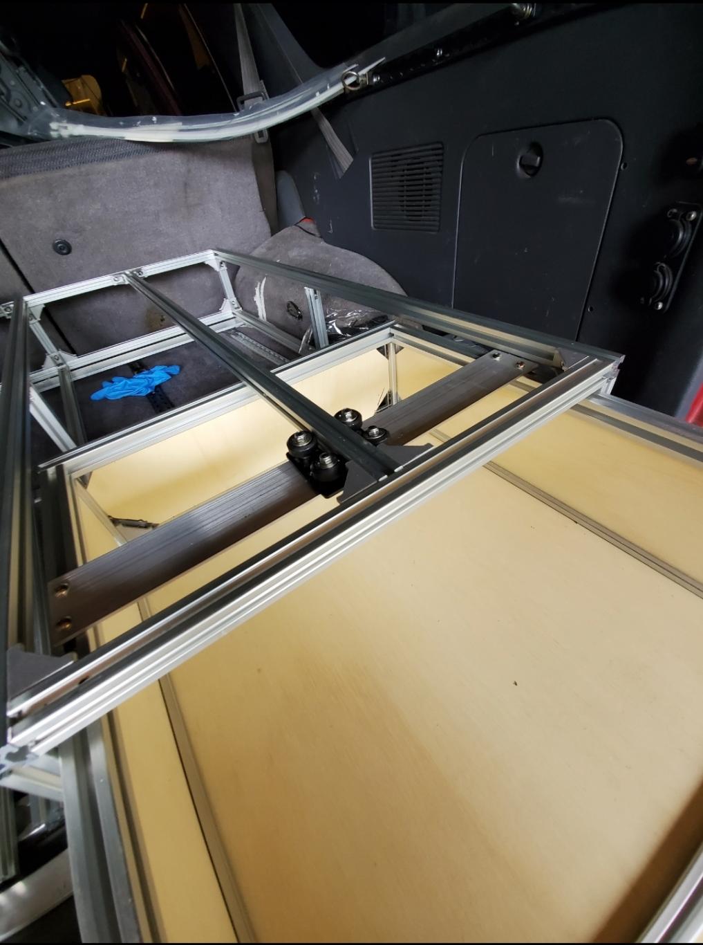

Got one drawer built and all the stuff cut for the other drawer.
I went with a non traditional drawer slide, trying out an overhead track idea. No clue if it will work or not.

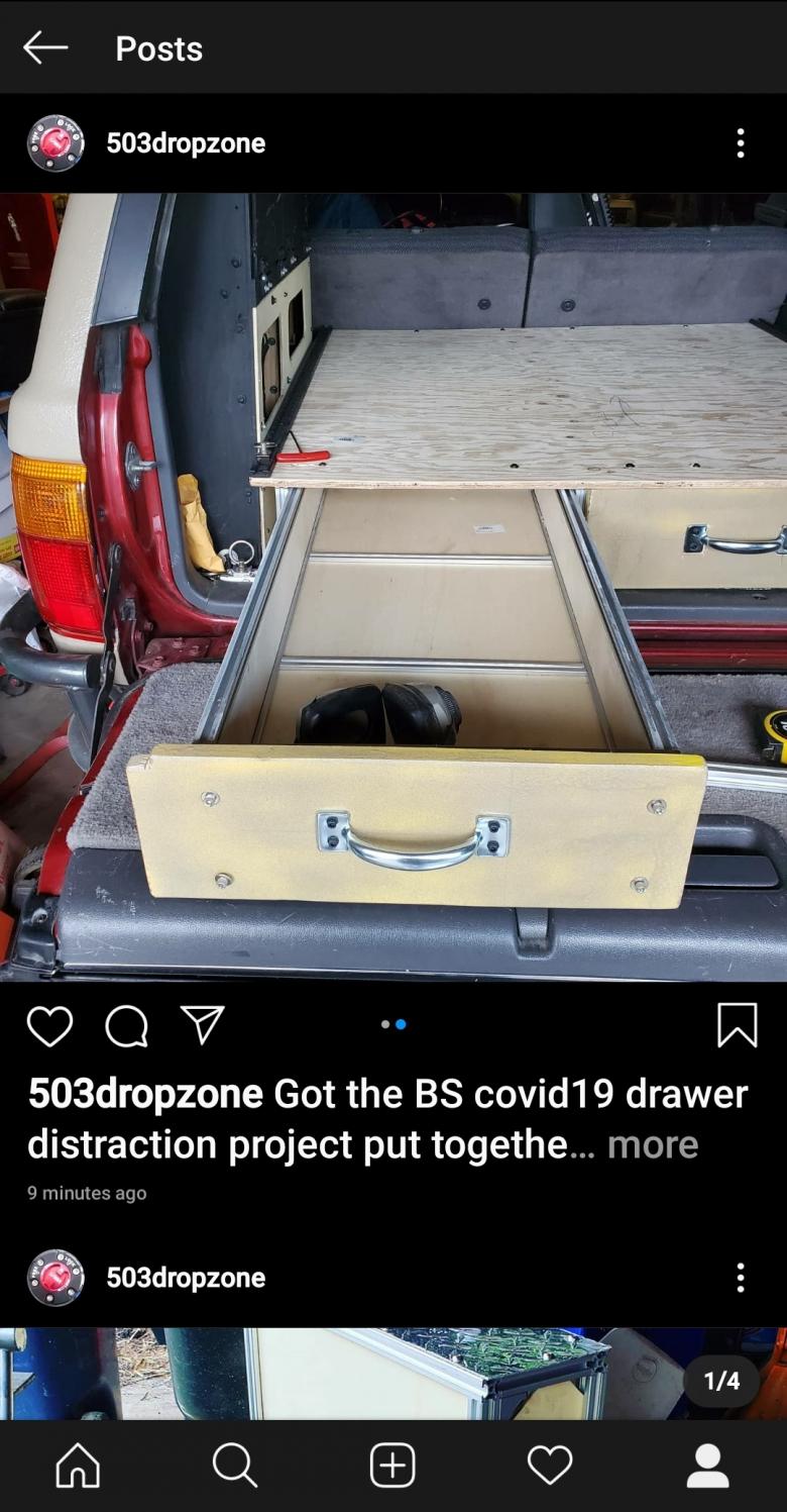

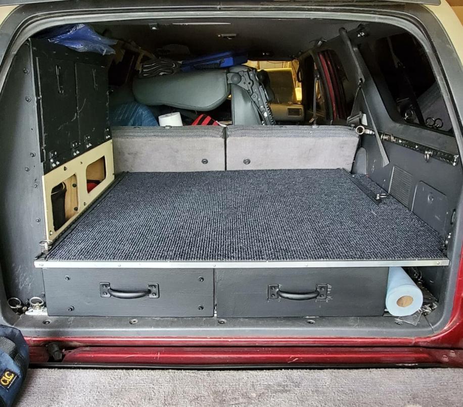

Got the BS covid19 drawer distraction project put together and installed. Need to paint and slap some carpet on top. Ended up taller than I wanted but overall happy with it.
2 drawers, inside dimensions 6 × 16 x 37"

Slapped some carpet on top and added some aluminum channel on the edge

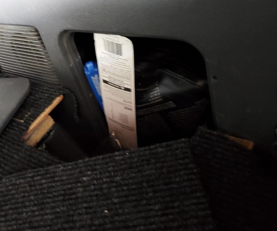

Someone asked if I still had access to the passenger side cubby- yes through a small access plate, I may had hinges sometime

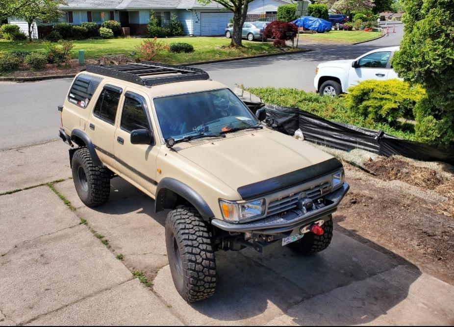

Did a little revamp on the roof rack. Using 8020 makes an old fart feel like kid with an erector set again.
Version 1.0 was only about 34" wide and was very low to the roof. That was fine but difficult to get bungee cords/rope around a crossbar. It was also a bit narrow.
Version 2.0 is 38" wide, 72" longand sits about about 1" above the roof line. May not seem like much but will be better in the long run.
Passenger side pic is old narrow rack
Driver side is the wider rack

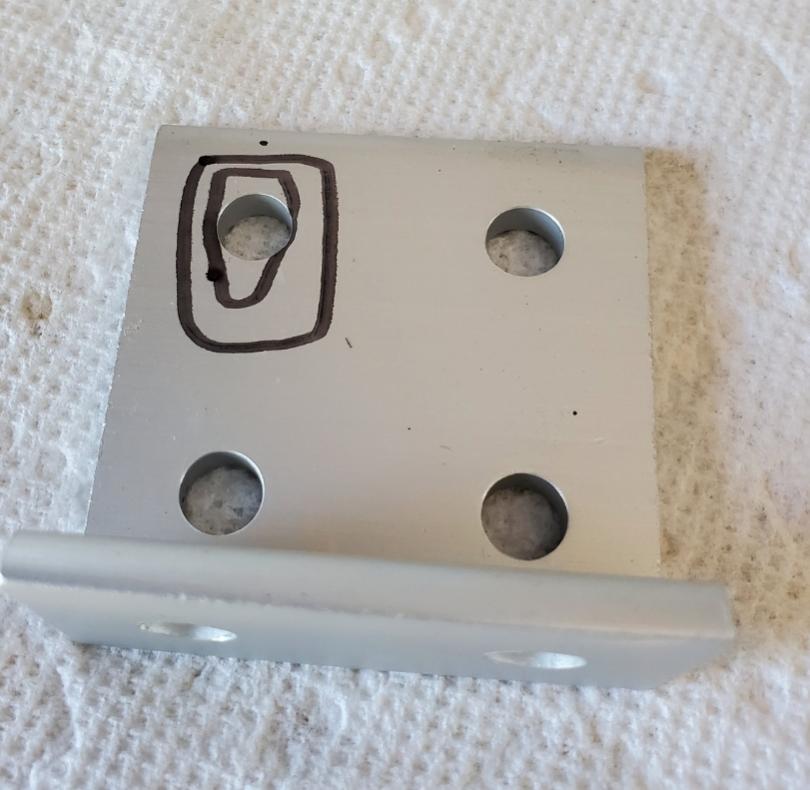

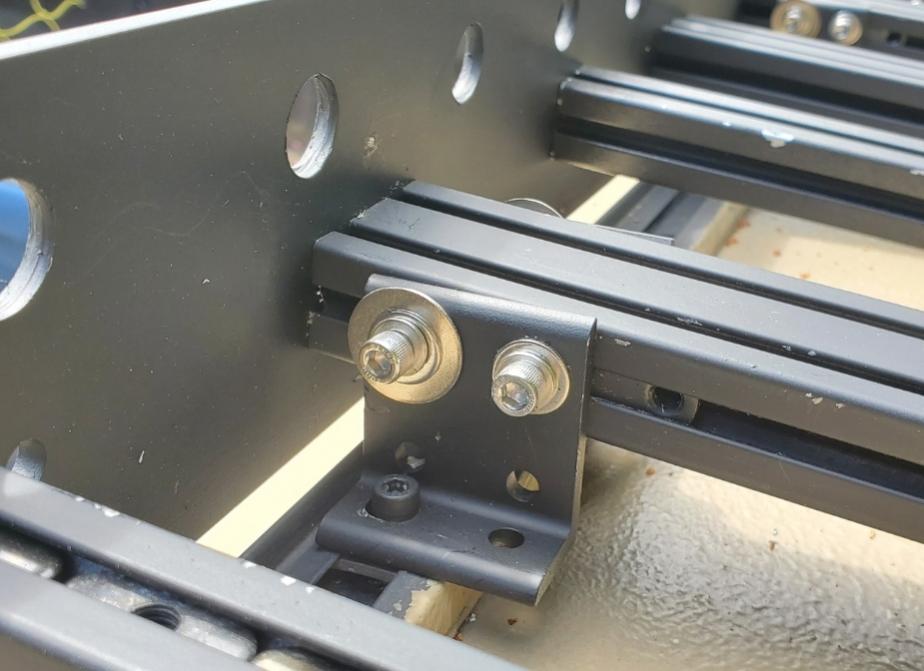

I have all the 8020 10 series parts and two 1/4" alu plates in my cart for my own new roof rack, but I'm hung up on exactly how to manage the small angle on the side of the roof. There are some 8020 hinge pieces available, but I'm unsure as to their strength. Looks like you have some brackets as risers, but it's unclear what's happening behind the side plate. How are you managing that little bit of angle? Thanks again!
sorry for the slow response, been busy with work and a couple of big back yard projects, i will get a picture of what i did for that tomorrow.
No rush and no problem! Always appreciate your help when I've reached out. I've been super busy myself and glad to finally have this new rack underway. I've been wanting to get that basket off the factory rails and crossbars for forever and finally did it last weekend. Had a little cleaning (a lot, actually) to do up there afterwards...
I know it’s been a while since you posted about the spare tire swingout but how is it holding up? My boss and I are going over how we’ll mount it and he’s skeptical about bolting straight to the body with the bracket behind it. I personally don’t have any qualms about it since I believe they were bolted that way with a brace behind them from the factory but I figured I’d ask. Congrats on the shed btw, I’ve been following the progress on the Gram.
I used some 8020 brackets on each end, I elongated the outer hole(hence the bigger washer) slightly to allow for the curve. If you go this route be sure to make left and right side brackets. I ended up with a couple of extras before I realized my mistake.
Hope that makes sense and the pics help
