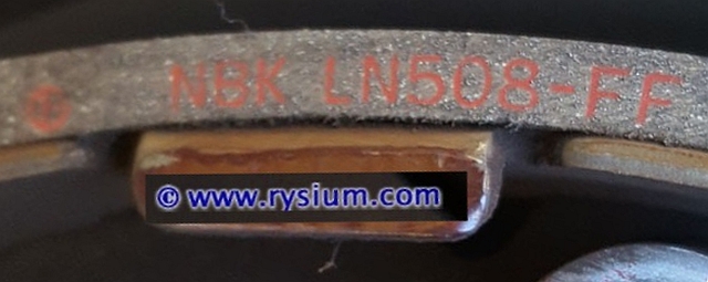

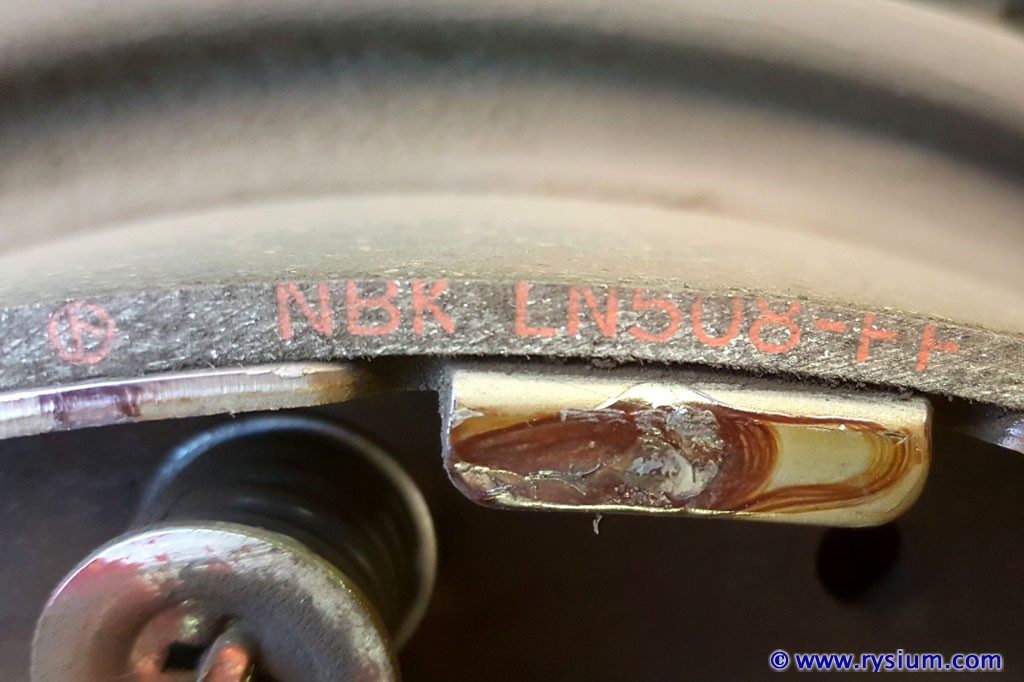

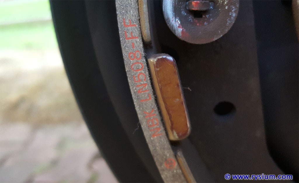

Here is the original shoe I have in my 1995 Tacoma that came with the truck. You can't get more OEM than that :dance:
If you have a problem with reading markings from the image it is:
NBK LN508-FF. Definitely FF grade.
The other shoe (same wheel) has the same markings.

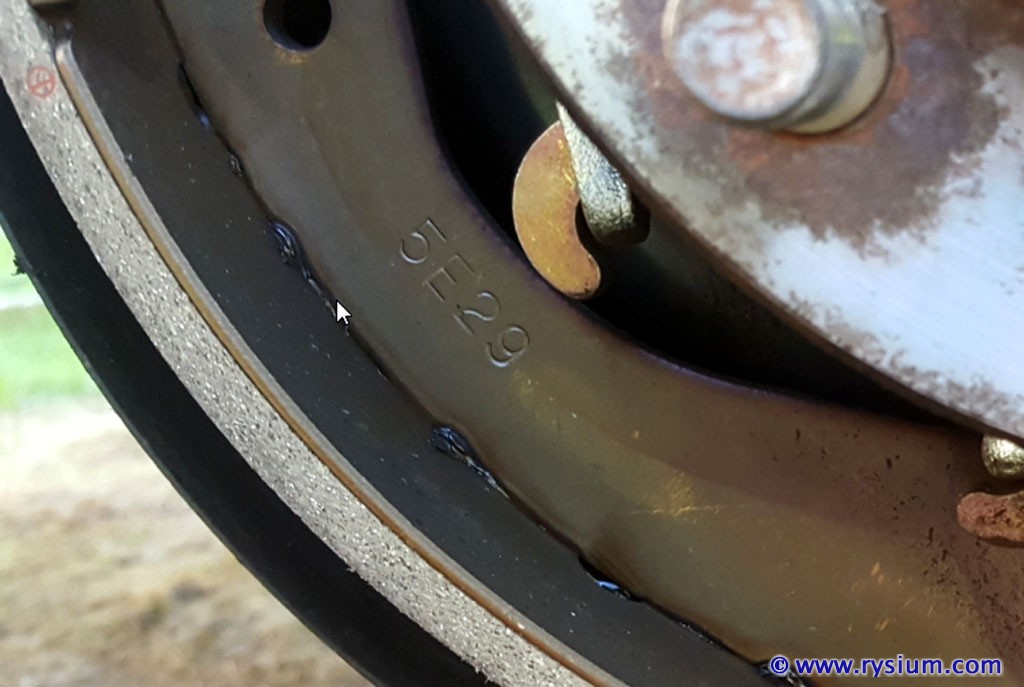

I also saw the marking 5E29 stamped on the metal - I don't know what it means
Thanks. I appreciate the effort and I'm sure others do too because that tells us three things about the friction material.
If you have a problem with reading markings from the image it is: NBK LN508-FF. Definitely FF grade.
Thanks for the level of detail on both shoes.
I have never seen a car have different grades on any wheel, at least for pads, (have you?) so, I would assume the fronts are FF also (based on that experience only though).
I don't know what that stamped number is, but the "NBK LN508 FF" was exactly what I was looking for, because it confirms the OE pads are made of material with FF friction coefficients.

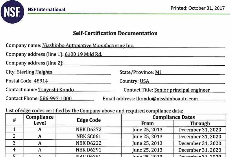

From the Automotive Manufacturers Equipment Compliance Agency document previously posted, that exact number cross references to the OE manufacturer "Nisshinbo Automotive Manufacturing, Inc.", and an AMECA compliance registration number of "160426".
That same AMECA compliance number of 160426 cross references to the following 19 edge code markings for pads and shoes sold in the US over the past 3 years, so, if by some miracle, you run into those numbers on a pad or shoe, they're the exact same friction material.
  • NAC D9011 FF
  • NAC LN508 FF
  • NAC N2009 FF
  • NBK D9011 FF
  • NBK LN508 FF
  • NBK N2009 FF
  • NSA D9011 FF
  • NSA LN508 FF
  • NSA N2009 FF
  • NSC D9011 FF
  • NSC LN508 FF
  • NSC N2009 FF
  • SABC D9011 FF
  • SABC LN508 FF
  • SABC N2009 FF
  • SAC D9011 FF
  • SAC LN508 FF
  • SAC N2009 FF
  • SABC LN508 FF
I'm on the phone with AMECA right now trying to get further information about our shoes based on the information above.

I made a more zoomed in and straightened and full-pad thickness picture of the one that you previously posted included below. Let me know by PM if you don't want it here and I will delete it. I included the credit to you in the picture where it's just zoomed in, and straightened for easier reading for others.

The nice thing about the DOT Edge Codes" (also called AMECA Edge Codes) is that they tell you three things outright and they make great search terms!
although I applaud your in-depth investigation into the details of finding a truly comparable friction lining material.
Thanks. I was hoping this number would be a "holy grail" where I could use it to better compare two brake shoes in my hands.
To get a better handle on how to interpret the numbers, I called the main number at AMECA.ORG in Maryland at 202-898-0145 and spoke to the engineer in charge of that "AMECA Edge Code Markings" cross reference.
It was a long discussion, the net of which is that this code isn't really for the consumer. The engineer said it's kind of like the so-called "serial number" on a tire, or on a package of baked beans, where if something goes wrong, the government has a way of tracking down whose fault it is. In addition, he said that the SAE J866 Chase Test is really a quality metric, and not a performance metric, even though friction is an outcome of the Chase Test.
The engineer did give me all sorts of personal insight into how to buy brake pads but overall, he said you can't extrapolate very much real-world decision-making data from the DOT Edge Code.
Of course, if you miraculously find two pads with the same DOT Edge Code, then there's a 100% chance that it's the same friction material.
Or, if you find any pads with any of the 19 DOT edge codes that cross reference to the same AMECA registration number 160426 then they too are exactly the same friction material.
That's because the AMECA registration number 160426 is for a specific 1-inch square piece of friction material that can be used on any brake pad or shoe.
But that's really as far as a consumer can go with the edge code, he said.
He knew about all three of the Michigan police studies of EE and FF brake pads, where those in-depth police cruiser tests also said it's hard to extrapolate real-world performance from just the EE or FF friction code they tested.
The AMECA engineer said that there are from 10 to 30 compounds in a brake friction material, where he opined that Toyota spends enormous energy with what he called the Tier 1 companies (e.g., Nisshinbo for Toyota) optimizing the compound for each vehicle; but the engineer said that the aftermarket suppliers (e.g, Centric, Wagner, Akebono, Axxis, etc.) centralize on about a half dozen to a few more than a half dozen formulas for all their offerings.
In summary, the AMECA Edge Code is only "slightly" useful to a consumer, as it tells the consumer the most information only if numbers match, but if they don't match, the only three things it tells the consumer are the manufacturer, the friction coefficient, and the registration number for the specific friction material.
BTW, I was tempted to call the Nisshinbo senior principle engineer himself (Tsuyoshi Kondo, +1-586-997-1000, [email protected]) who submitted the 1-inch squares for our particular friction material on October 31st 2017 for repeat testing, but I didn't have the nerve to call him for more information, especially after the AMECO engineer told me this information is mostly for law enforcement and government use, and not really intended for consumer use.
The one thing the AMECA engineer told me over and over again though, is that what we'd want for comparitive purposes, has been studied and studied by the "smartest guys on the planet", and nobody can agree because of conflicting interest.
So he symphathized with our needs.

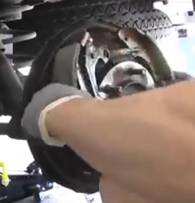

Also, after watching the video that started this thread, I came up with this right-hand-rule that I hope should work for everyone, which is to place your right hand in the hitchhiking position and point your thumb horizontally in the direction you want the shoes to go ... toward the rear for loosening the shoes away from the drum, or toward the front for tightening the shoes toward the drum.
Based on what I saw in the original Timmy the Toolman video, your four fingers of your right hand will always curl in the direction that the toothed adjuster needs to be spun.
The easiest way to install the rear brakes is to pre-assemble them and slide them over the axle.
That's a great idea which I will try when I do this job in an upcoming warm weather weekend.
For an example in practice, this thread has a video by chipsahoy which shows that pre-assembling procedure in real time.
To spare you most of the dubbed-in-and-out music, you can skip to time 592 seconds
https://youtu.be/TywVkpCDcCA?t=592
