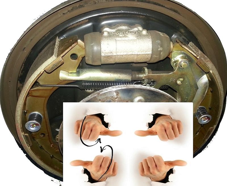

Its annoying difficult trying to determine if one side needs to be adjusted more or less than the other.
I came up with this right-hand-rule that I hope should work for everyone, which is to place your right hand in the hitchhiking position and point your thumb horizontally in the direction you want the shoes to go ...

The original right-hand rule is an electromagnetic basic rule that all physicicists and electrical engineers know, but the RHR also works well when you're upside down as it works for bolts too (it's the same end result as "righty tighty lefty loosy").
If you want a normally threaded bolt to go in or out, you place your thumb in line with the bolt and in the direction that the bolt needs to go, and your right hand fingers will always curl in the direction that you need to spin a normally threaded bolt.
It's the same here, where you have to treat the adjuster as a bolt, where going "in" is going to the "rear" of the vehicle.
Facing the adjuster bolt from either the outside of the vehicle looking toward the lug bolts or from underneath looking toward the backing plate, you "hitch hike" with your thumb pointing toward the rear to adjust the shoes "inward", and you hitchhike toward the front to adjust the shoes outward.
  • Remove = hitchhike to the rear
  • Adjust = hitchhike to the front

The right hand rule works well especially when you're upside down as it works for bolts too (it's the same end result as "righty tighty lefty loosy").
The Right Hand Rule works when you face the front of the brake drum (from the outside looking inward) to tell you the direction to spin the toothed wheel to expand and contract the brake shoes.
We probably need to hone the right hand rule a bit because it works only if you're FACING the outside of the drum.
It's the opposite if you're looking at the drum from inside, under the frame, and from behind the drum.

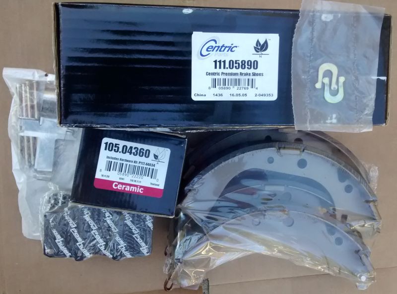

I bought the CENTRIC 11105890 from Rock auto.
Nobody wants to get the wrong size shoes, least of all me, so I appreciate that reference to an actual model number that I can sink my teeth into to replace the OE #160426 NBK LN508 FF Nisshinbo shoes.
I called Centric at 626-961-5775 today and asked for technical support, who confirmed what you said in that the "OEM Quality" equivalent Centric shoes and pads are:
  • Rear shoes, Centric Part Number 11105890, ceramic
  • Front pads, Centric Part Number 10504360, ceramic
Based on a descrepancy shown below, I spoke to three progressively more senior Centric technical support people, all of whom knew all about the Michigan police cruiser studies, SAE J866 Chase Test, and SAE J2784 compliance, and the AMECA Edge Codes (aka DOT Edge Codes).
Centric kindly gave me the DOT Edge Codes after calling the warehouse who read them off the shoes & pads:
  • CENTRIC 11105890 shoes = 111AA9101FF30N17 which means 111AA formula, 9101 factory, FF friction, 30th week of 2017, N type material (low copper)
  • CENTRIC 10504360 pads = 15AA2256FE48A17 which means 15AA formula, 2256 factory, FE friction, 48th week of 2017, A type material (high copper)
While both our front and rear "OEM Quality" replacements are termed as "ceramic", their composition is very different where our "N type" rear shoe is described here but it's mainly that the 1-inch by 1-inch by 1/4 inch burnished square supplied to AMECA for materials compliance contains less than 0.5% copper by weight - while our "A type" front pads are mainly more than 5% copper by weight.
