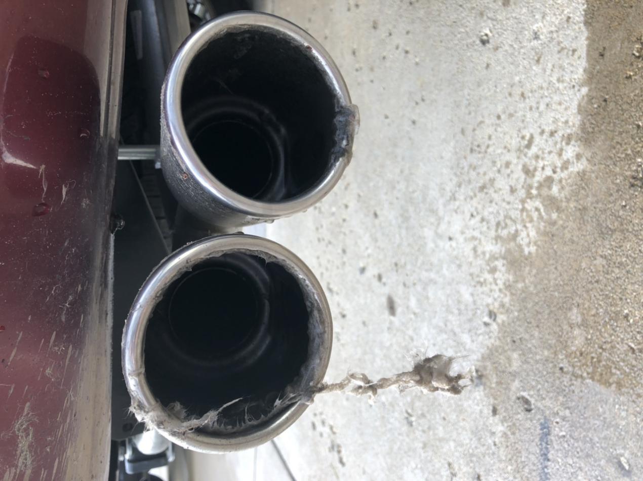

I noticed this morning while waiting for the puppy to poop that there is material hanging out of the exhaust tips.
Is there a break in period for headers/exhaust that would cause this? Is it the new gasket burning off excess from the headers? Or is this a sign of something wrong?

Photo below, didn’t post originally.

If its not packaging material or plastic wrap from around the exhaust tip you didn't remove before installing, its probably muffler packing material.
It was installed packaging free... how much of this stuff should come out of the muffler?

From your picture it looks like your tips were wrapped in plastic.
The material I pulled off looks like insulation, no joke. It’s a fabric/foam type material. Insulation packing makes great sense. I’ve done some reading today across multiple vehicle platforms and a break in makes sense. If it continues I’ll call Gibson and ask.
