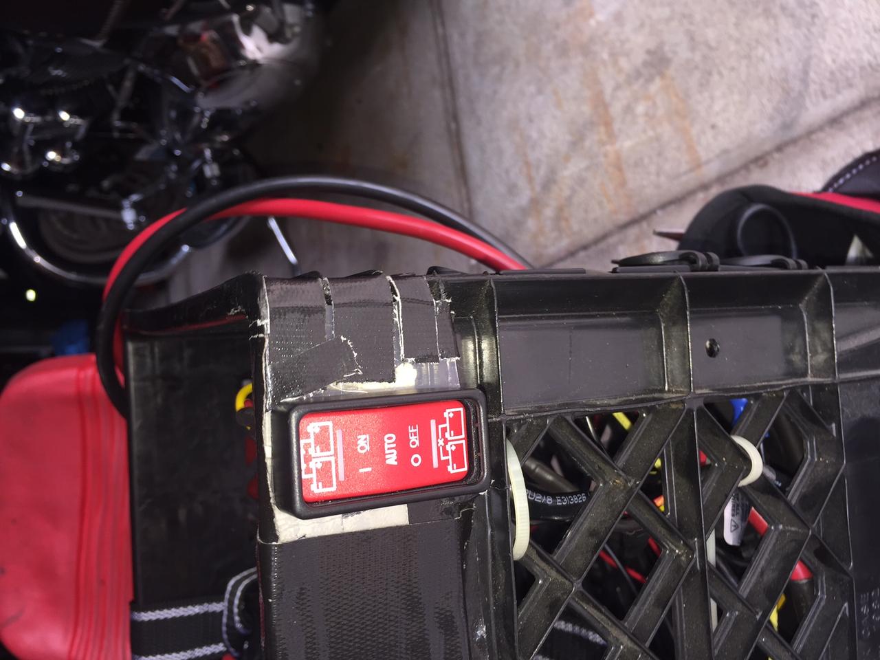

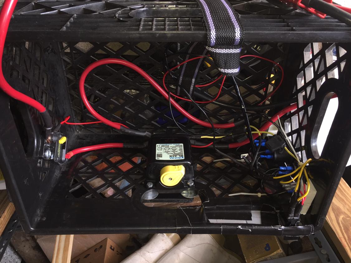

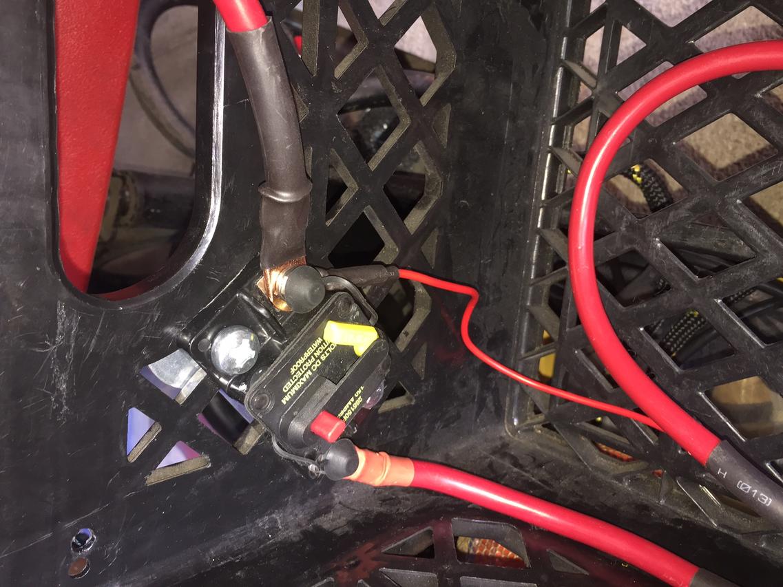

Thanks to all for the great information. I wanted a NL Portable Power Pack but could not justify the costs so I built my own. I used a Blue Sea ML-ACR, bus and switched fuses, an Amazon panel and my own cables. I ran cables (2 Gauge) to the back of the 4Rrunner and Anderson connectors.
It took me a couple of weekends to run the 2 gauge and assemble, test and package the parts. Blue Sea support was great and now just waiting for my Odyssey Battery to show up.

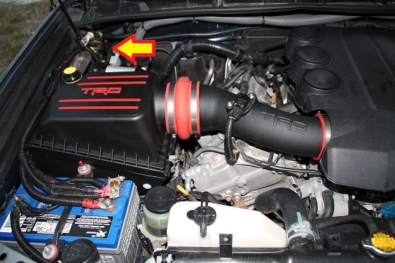

I'm installing a Painless Dual Battery kit in my '16, and the controller requires wiring into a connection that goes hot with the ignition switch. Any ideas on where in the engine compartment to hook up to?
Didn't want to start a new thread.

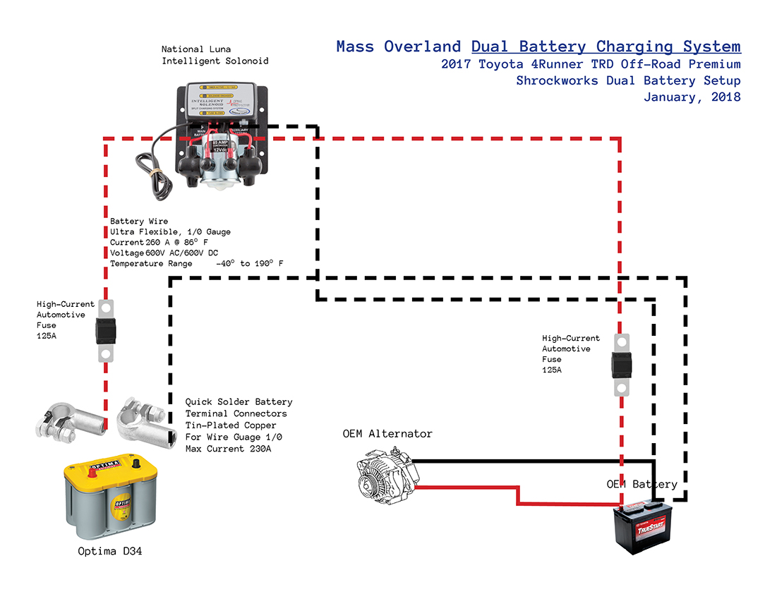

Needed to see if someone, or more than one, can confirm that with this setup I won't burn my car and myself with it?

Looks fine to me... just curious as to why National Luna vs something from BlueSea
Nothing against NL, but I just think a DIY kit using BlueSea gear gives you more value.

Thanks a bunch!
Most people I've followed have used National Luna (Andrew St. Pierre, Overland Expedition). I've learnt quite a bit of how it works through their channels and also communicating with Equipt. Although, instead of using an sPod like most, I've decided to go with using Blue Sea circuits.

Just my opinion but I think BlueSea ACRs are some of the most elegant solutions out there for dual battery setups.
Most ACR circuits are so simple anyways that it all starts and ends with the ACR itself and the BlueSea ones are actually quite intelligent. They have many different options based on application needs. The voltage display on the NL is nice, you could easily recreate that. Personally, I just like looking at voltages as I understand how it relates to state of charge… Keeps the setup simple and clean.

Comparing what BlueSea does for power distribution is a bit apples and oranges when looking at something like an sPOD or Switch Pro. You still have to consider the switching/relay portion as the BlueSea are more traditional distribution blocks with line level fuses. Bussman Cooper does an integrated relay / disto blocks as well… I like them very much.
I used BlueSea because I prefer to stay away from complexity for the easy of trouble shooting in the field, but the Bussman Cooper blocks with integral relay racks are right up there in my book, and if I knew about them before I built mine up, I would have taken that route instead.
Be sure to look at the BlueSea LVD as well… another fantastic must have IMO depends on what types of loads you intend on driving.
End of the day… no right answer, just different designs and criteria that generally drive decisions. Educating oneself is half the battle.

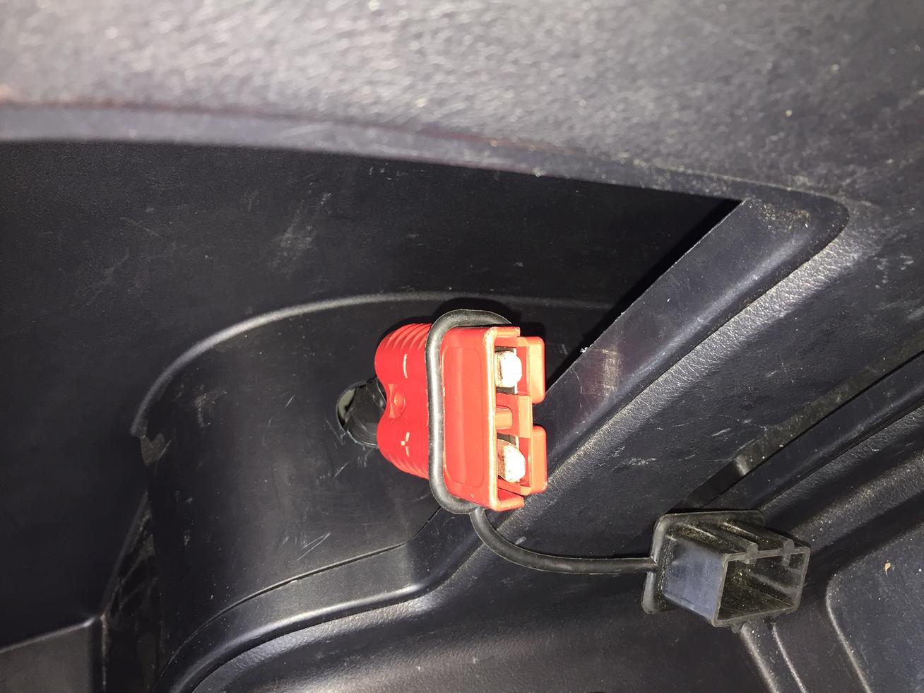

The key take away for the Anderson quick disconnects are flexibility… those connections are capable of 45A, but I have everything fused at 30A for external power.
Here is what the connector looks like…

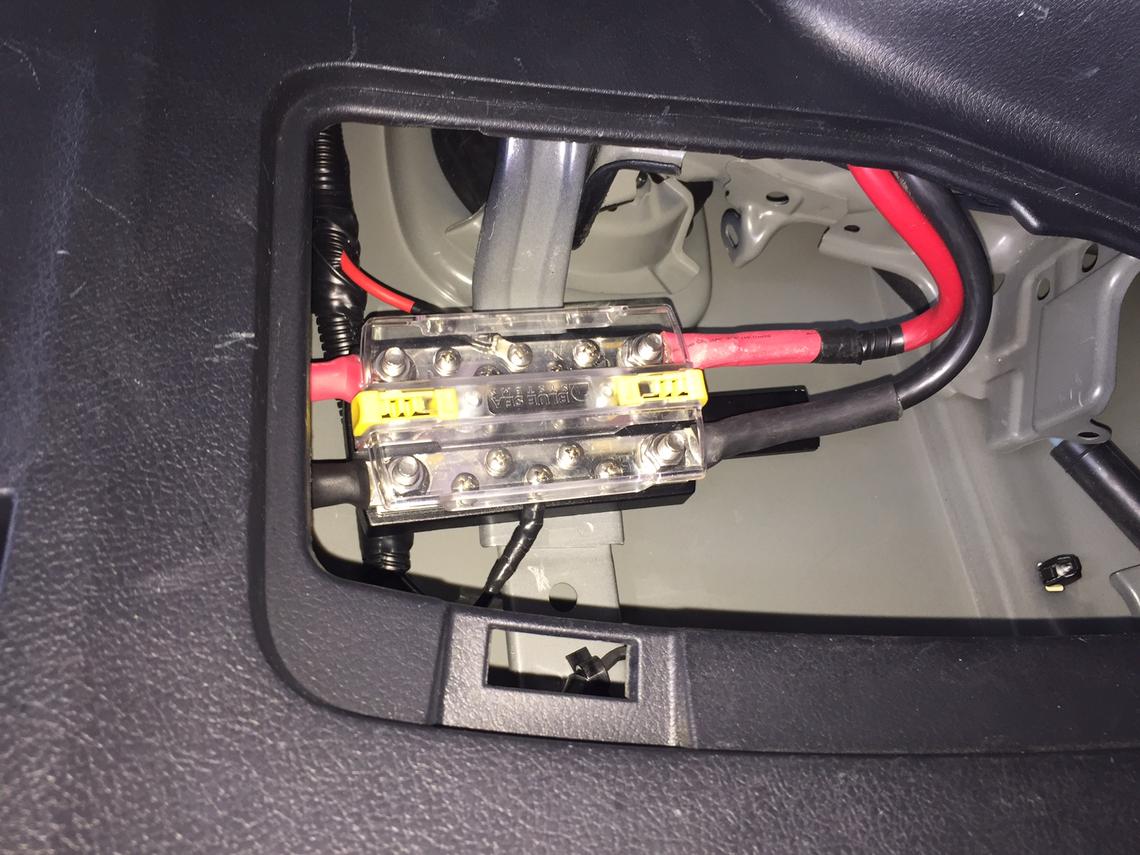

Low Voltage Disconnect in background and Fuse Block

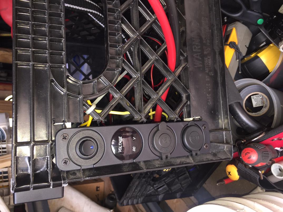

LVD control

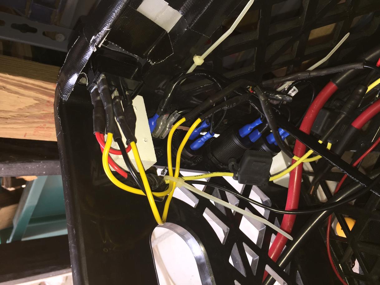

External ports for charging and maintaining... fridge, radios and other gear is often times "always on" even when sitting for days.

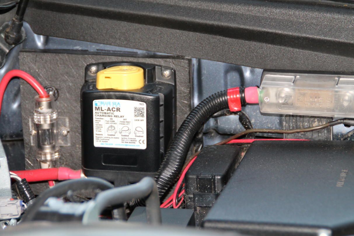

The ACR I used allows me to get extra run time, because the starter battery can be forced to participate in feedings loads. Such a great feature.
