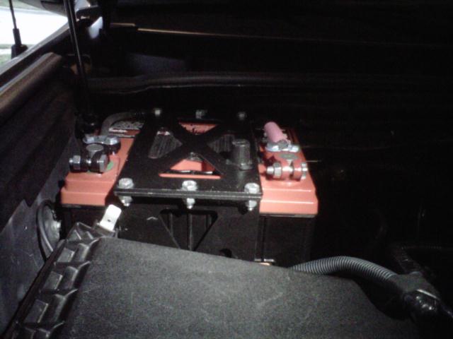

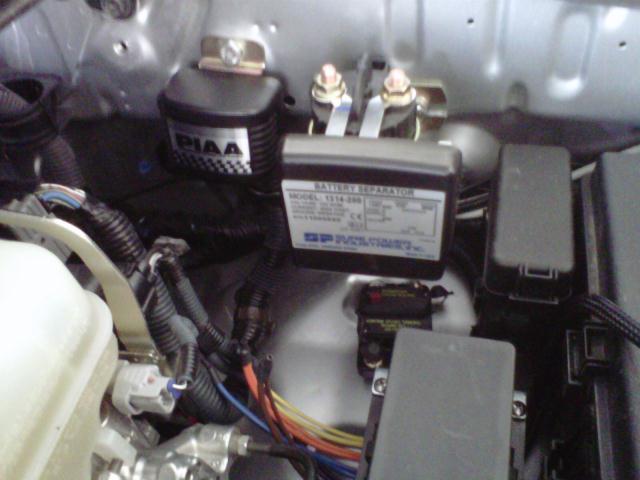

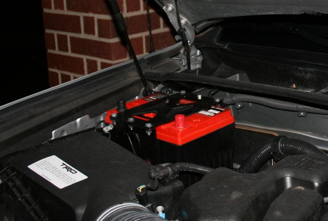

Machined out of 6061 T6. I am using a Odyssey PC1200, a few have asked why I didn't go with a larger batter. My answer is, because that "little" battery packs quite a punch and combined with my starting battery, offers waaaaaaaay more power than I would ever need. Plus, I still had to relocate the Power Steering fluid res., but I only had to move it over about an inch. My goal was to fit an aux. batt in that spot with as little disturbance to the OEM lines, parts, etc. as possible. That is a 100 amp breaker on the hold down and it is used in conjunction with an IBS DBS battery controller. Awesome system.
VERY NICE! Now that is what I would expect a $200+ battery tray to look like. Whenever you decide you want to make another one put me down for one. Just give me a heads up so I came pull the bracket off and send to you as I work out of the country everyother month.
