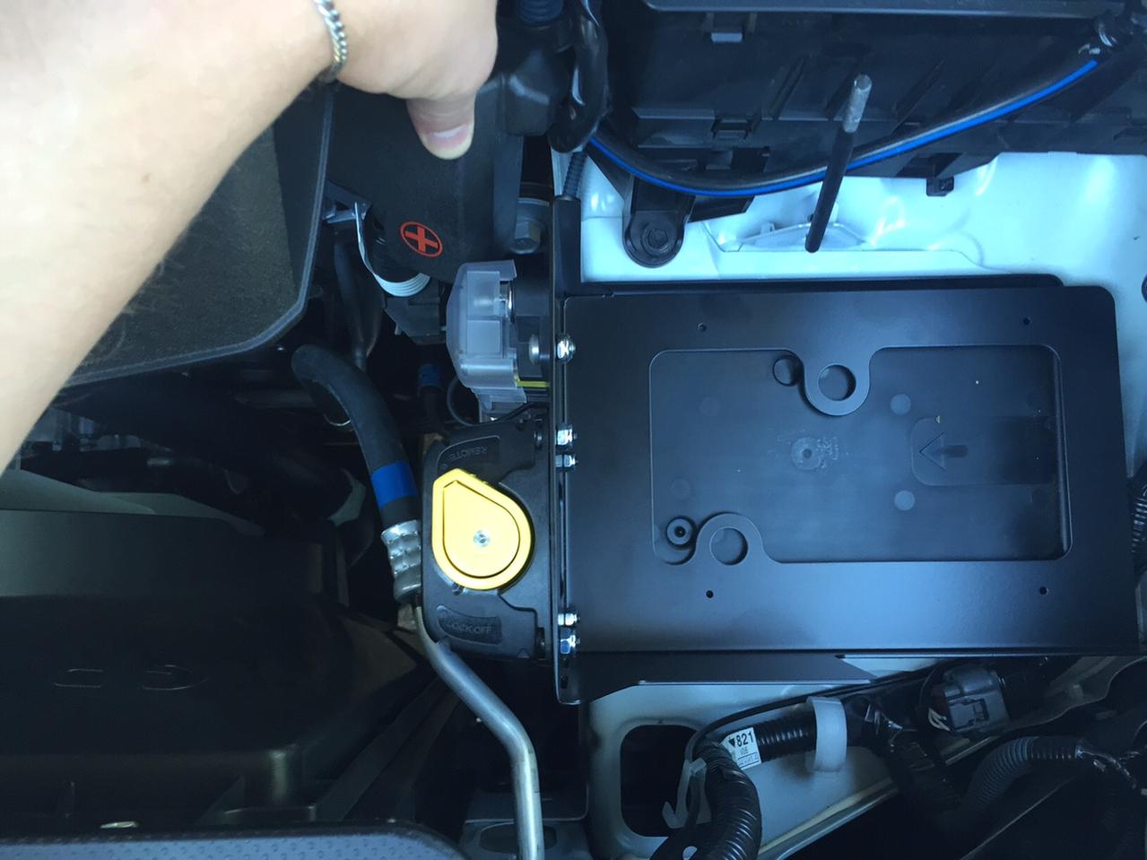

FYI, on the 2016+ Toyota changed an AC hard-line that that prohibited me from running a relay on that Shrockworks tray. You may want to call them with the dimensions of the solenoid you want to run to make sure it fits. I tried to fit a Blue Sea ACR there and it wouldn't fit without bending the AC line which I didn't want to do. I may be able to dig up photos if interested.

Nice, I love technology. For a smaller solenoid you can probably make it work, the relay I was trying to fit there is the size of a small brick. I'll look for those pics.
Found it in a communication with Shrockworks, you can see that the tray needs to shift over to the left to fit into its intended place on the factory battery tray. This works on earlier 5th gens but not on the 2016's. It's a Blue Sea ML-ACR #7622 if you want to compare its dimensions to your solenoid. You could potentially drill new holes and mount the solenoid elsewhere on the tray. It's a great unit, built very nice, just didn't fit unfortunately.
