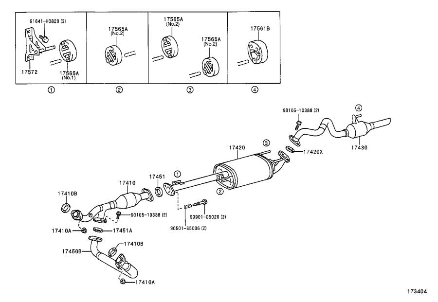

Here's the exploded exhaust system diagram, doesn't include exhaust manifolds/headers with attached cats.

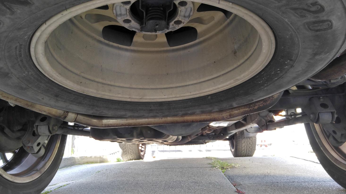

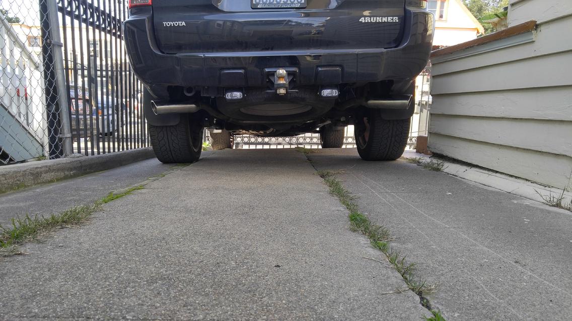

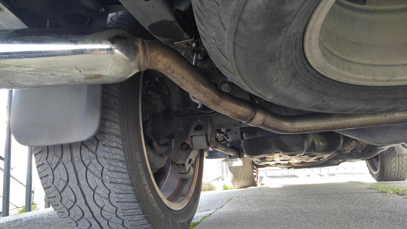

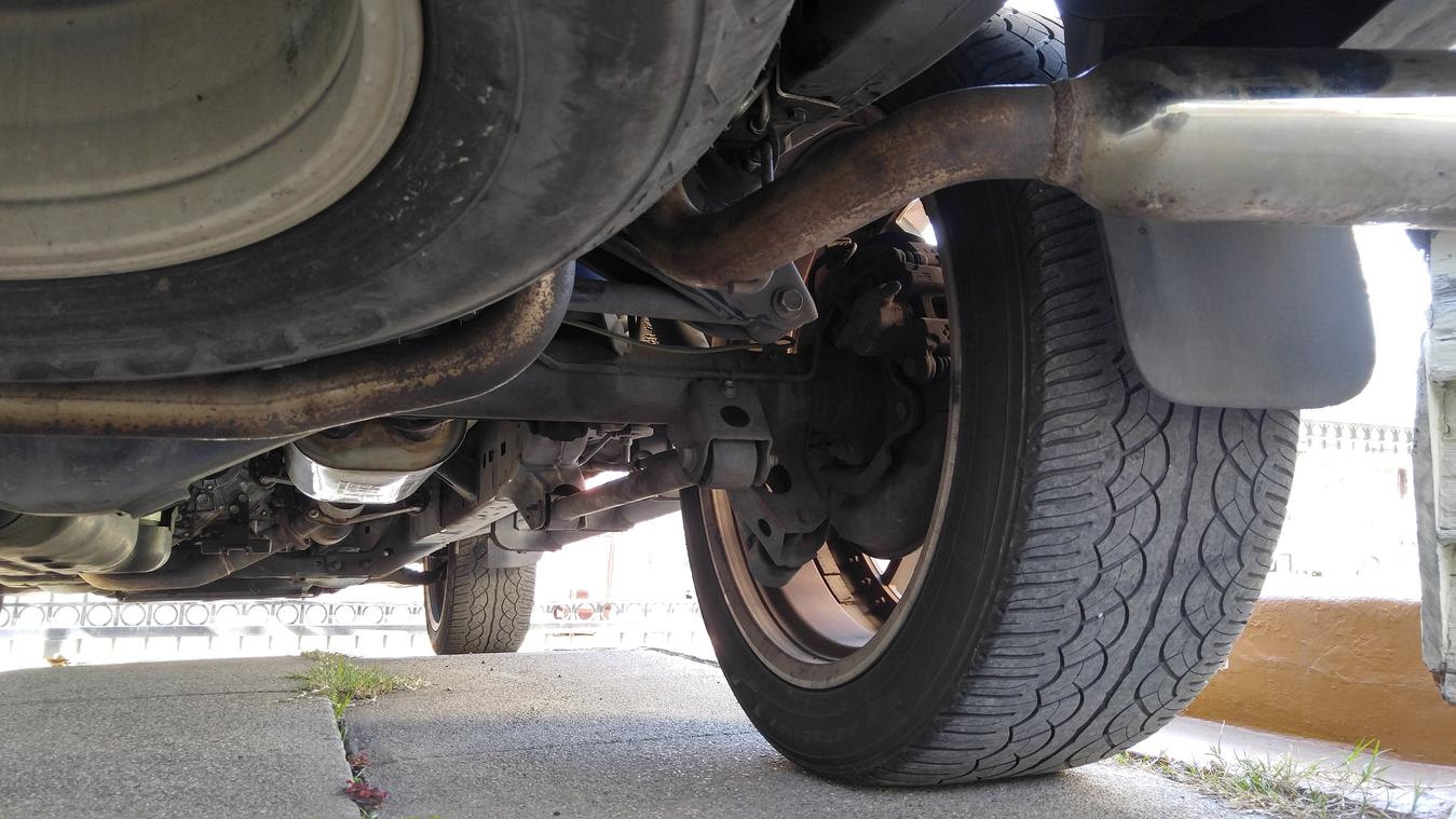

look up some borla dual setup, you will find how that left side pipe routing works. someone here took there spare out and have the pipe up the body. the borla left pipe exits like the passenger side, but its route along the axle and then the rear driver side.
i have a decent pic of how it its. but i have a v6.

The Borla dual exhaust is not a true dual exhaust, it only splits to a dual exhaust at the the rear of the muffler, otherwise the exhaust is still the OEM configuration.
I don't think a true dual exhaust is possible because of the fuel tank location.
Borla duals = very nice music !
I see the gas tank issue and therefore the L exhaust pipe must go over the axle before it can turn toward the driver side. Which also means no side pipes since you're already past the axle :( maybe a smaller spare would alleviate the space prob !?
