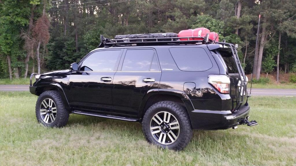

I would highly recommend you check out [MENTION=68079]drabbits[/MENTION] and Camelbak Metal Gear before you pull the trigger on that Gobi. I saved about half the cost of Gobi AND I think it is a better rack.
Like the Rack
Looks like a Gobi ladder on the back. How does the Gobi and the Camelback compare in quality, any idea? The camelback is less expensive but with Gobi's current offer of a free ladder, shipping and wind deflector there is not that much difference.
