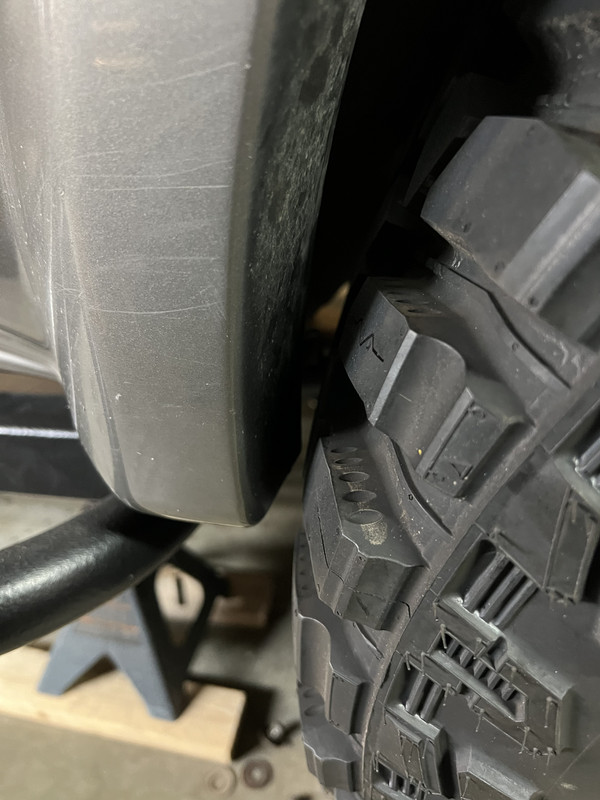

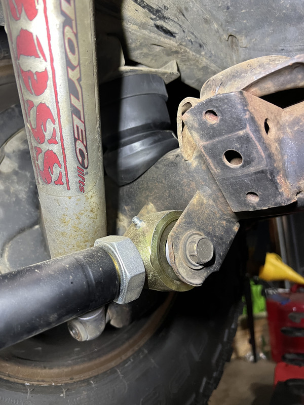

I wonder if the risk of tire rub goes up with the shorter one? I should have looked the bottomed out side the other day when i took these. These are the longer 5.25 durobumps on 2” lift, 265/75 tires.
These photos are very helpful. I’m also running 265/75r16s.
Based on those photos, I may just install what I’ve got and cut them down or swap them out later if needed.
