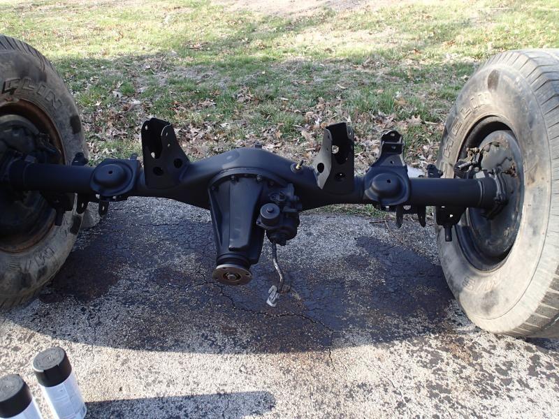

This wouldn't have worked here because they took the axles out, but I just put the wheels back on when nearly done removing it and lowered it back down. Then rolled it out from underneath no problem.
That's a great idea.
Actually viewing this now ... Question could u not have just pulled the 3rd member and swamped them without removing the entire rear-end assembly
Like [MENTION=56948]rich dog[/MENTION] said, you would have to alter the axle housing to make it fit. It's fairly involved. It's much easier to just get the whole axle housing.
Rolled the old axle out^ and used my spare plus stole my husband's spare as well to roll the new axle into place. It was a one-woman job.
This option would be what we would've done, if we didn't want to use my axle shafts into the elocked axle.
Makes complete sense and you had more people to boot.
I swapped shafts after I got the 'new' axle in, you know how easy they are to pull and I had to change the spares out anyway.
