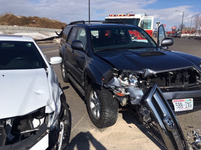

I will not be performing this trans flash soon.
Their fault, they pulled into traffic without looking, no traffic light. Yea I'm okay, thanks. Other person had to go to the Hospital. It will be totaled. The estimator stopped adding it up at $13,500 in repairs.
It is a shame that was an extra clean Sport Edition. Looking at 2014 SR5 tomorrow. Hard to find a nice Sport Edition now a days.
