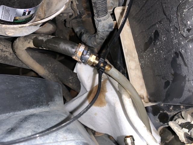

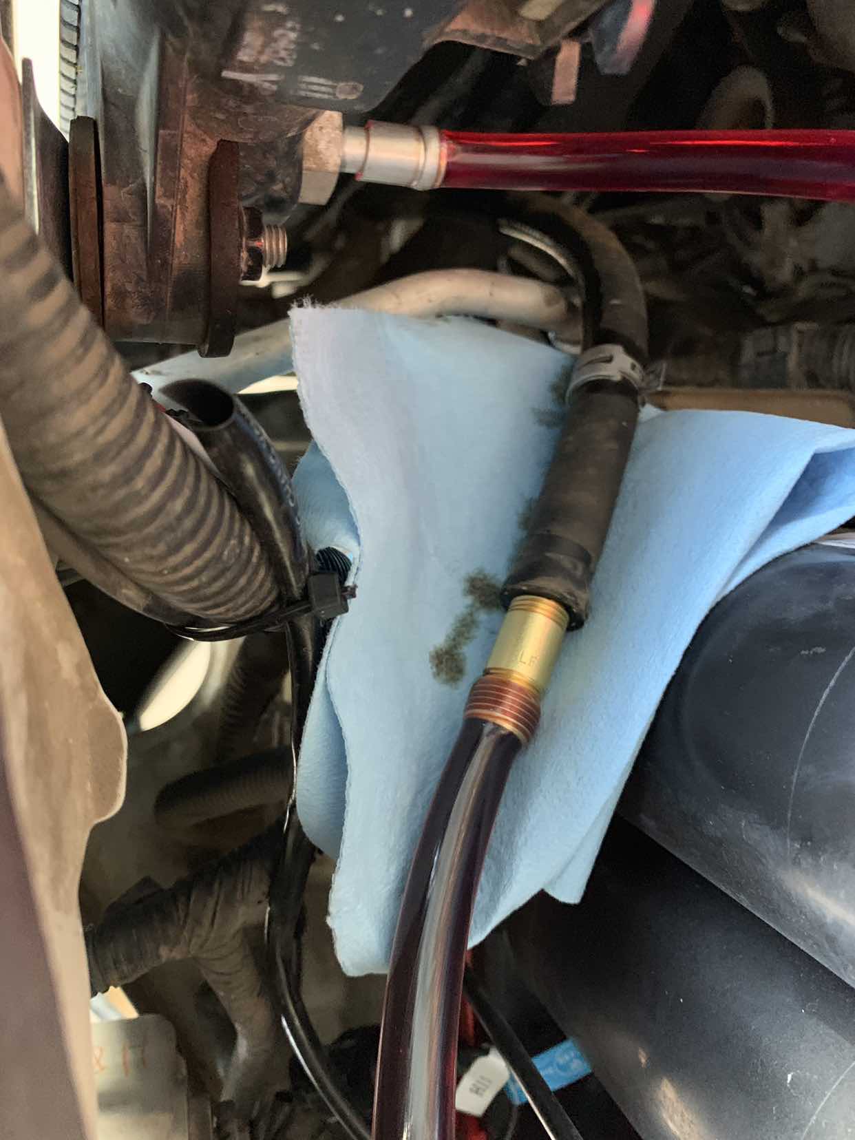

you need some clear hose
you need a metal fitment to go in the radiator cooler hose, i used a male and female air tool nipple. worked great
the science: the return line goes back to the transmission towards the pan, the fluid out of the tranny comes from the TC side, which makes sense because it needs to be cooled first.
Laying under the truck to pump fluid in with a small pump didn't make sense because the return line goes right to there anyway.
there are methods of heating the tranny to see the level is correct but its a sealed tranny, if it didnt leak, and your measurement is exact, i doubt it would be an issue. It was proven for 100k miles with my own truck.
  1. locate the top cooler line going into the radiator. that is all you have to disconnect in the truck. you do not need to go under the truck.
  2. you need (2) gallon jugs, both need lines that show exactly 3 quarts.
  3. connect a clear hose to the tranny hose that you disconnected, that goes to one jug.
  4. connect another clear hose to the nipple you disconnected the tranny hose from that is on the radiator. its the TOP NIPPLE, NOT THE BOTTOM

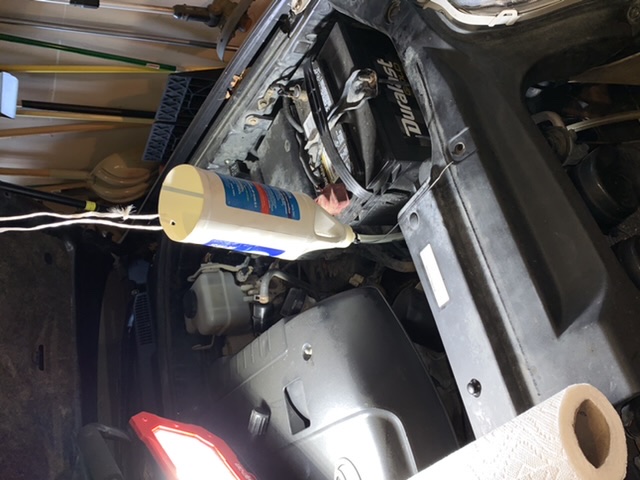

  5. add the clear hose and attach it to a funnel, get it high and hang the funnel.
  6. start the truck out the driver window, start the truck, watch the jug fill,
  7. TURN OFF TRUCK right at the third line.
  8. take jug number 2 and fill clean trans fluid up to the third line
  9. start pouring into the funnel.
  10. second time, only do 2 quarts at a time. second line. I did 12 quarts total, fluid was looking good by then. Black to Red with a little black in it.
  11. the siphon takes awhile, but be patient its going to go in no matter what.
  12. Thats it! be patient, be EXACT, and forget about the other stuff. Really no need. its sealed. just exchange and be AMAZED.

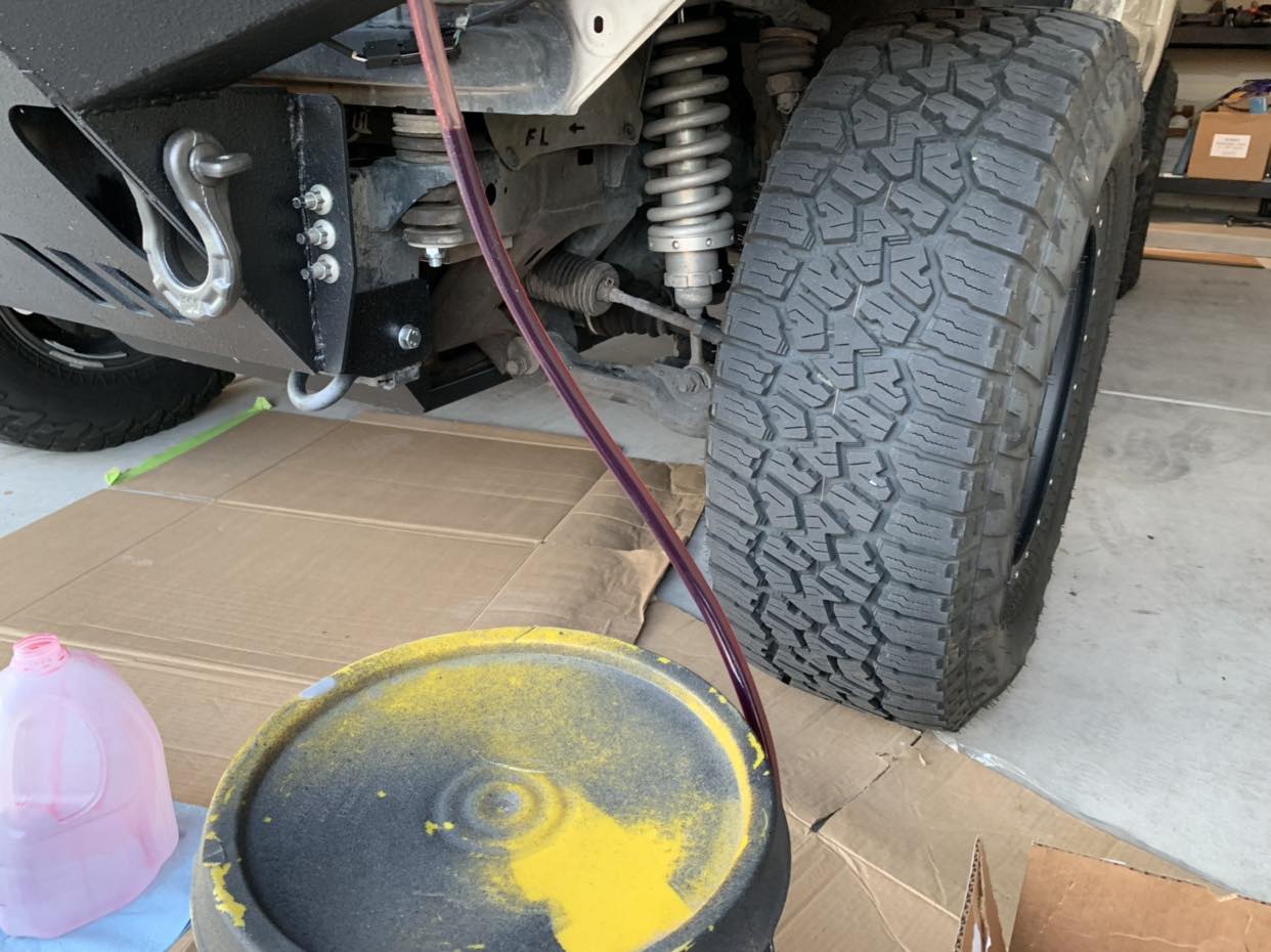

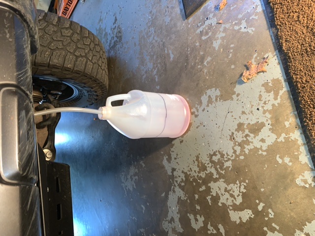

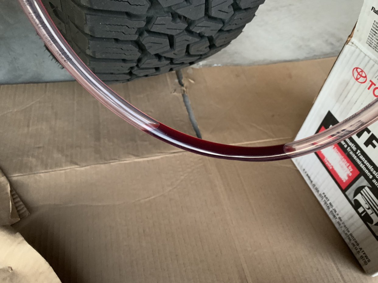

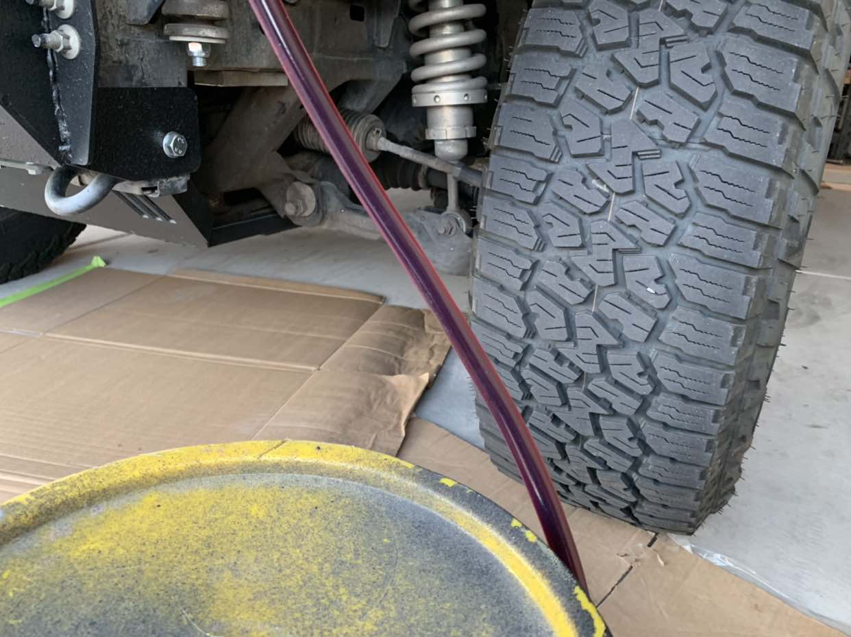

Finally got around to this, I’ve had the WS in the garage for a week or two. Super easy.
This is what came out the first 3 quart run.... not terrible surprisingly at 145k
Then the second 3 quart run
Then the first two quart run, looking much better
And the second 2 quart run. At this point I figured the last 2 quarts to make 12 were unnecessary, but I was in it so I figured why not.
The last bit came out looking like what I was putting in, which is awesome.
Only recommendation is make sure you get the right size fitting for the hose connection. I got a 1/4 inch inner diameter brass fitting and it worked, but barely. I couldn’t find a fitting that was 3/8 outer diameter at Home Depot, they must have been out. I got a few drips at the connection but nothing a towel didn’t soak up.
Can’t stress how easy this was, took less than 2 hours total. Thanks OP!

I preformed this exchange over the weekend. WOW what a crazy difference a fluid change makes in every day drive-ability. I truly couldn't believe it.
My trans fluid pumped out black as night (168k mi) and took about 8 out of 12 qts before i saw any change in color. by the time i got 12 qts in, the color was a deep red and satisfactory. probably could have taken another 2-3 qts to clear up even more but i was already $90 in at this point. im happy with the results.
my process took 3.5 hrs total. I equate the longer time frame to the fact that the orifice on my 'fill funnel' was probably smaller than others'.
for those that have not attempted this, do it!
also, as stated previously, patience is critical! the new fluid is not sucked in but rather gravity fed so...its slow!
I used Maxlife as other did. the bottle now states WS compatible on the label.

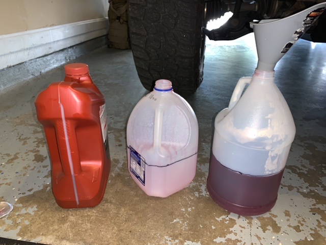

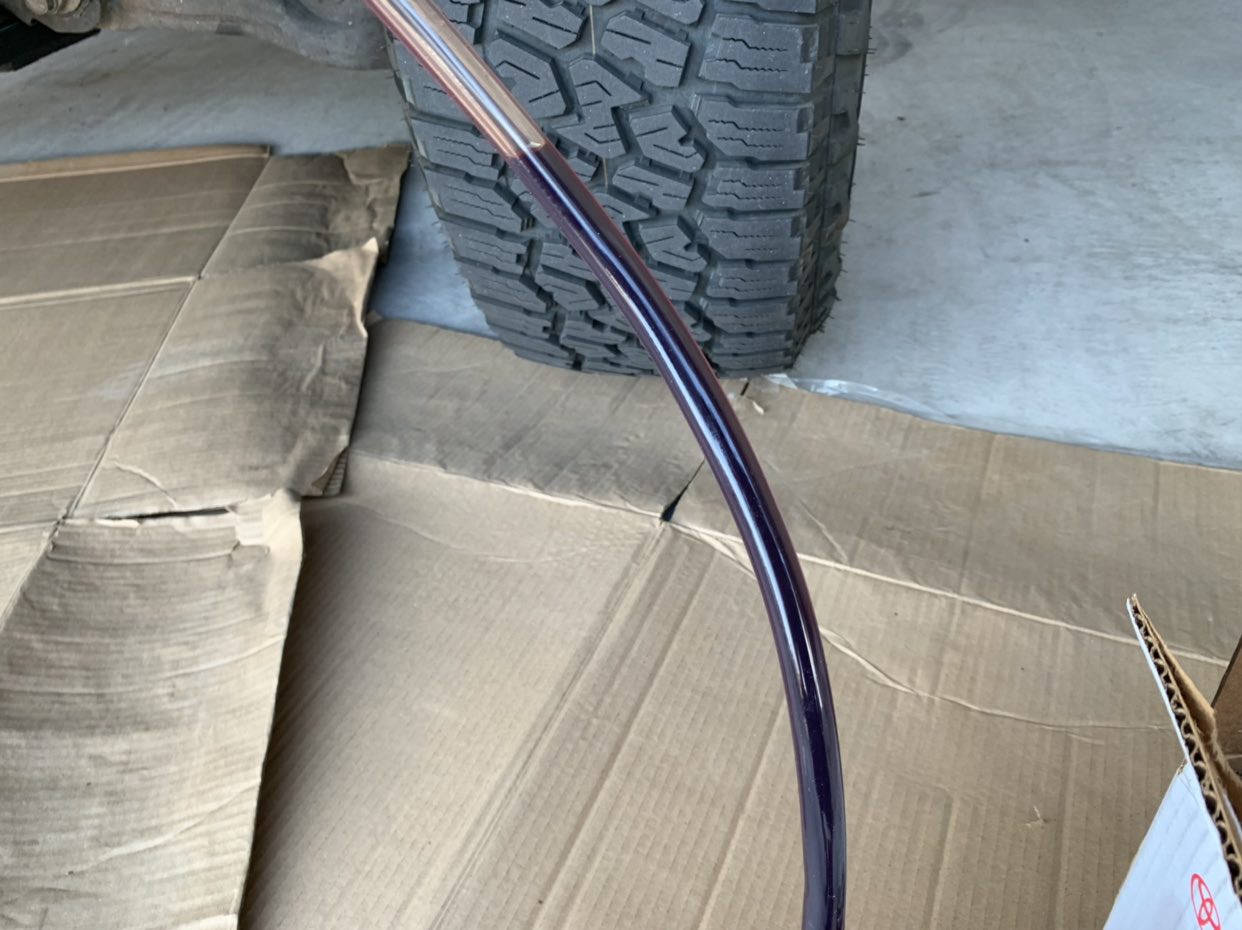

Here are a few pic of what I had to work with.
To get my marks on the jugs, I started by pouring in 2 qts from the maxlife to the first jug, marked it. Then poured from the first jug to the second jug and marked it.

After looking at countless ways to do this procedure, I went with the one Streetfighter wrote up.
I had been experiencing shudder when going up hill or at certain speeds. It wasn’t all the time but often enough to make me wonder if my transmission or torque converter was failing.
I used 3/8” ID tubing and 1/4” air fittings to attach to the factory hose.
Valvoline Max from Walmart as I couldn’t find it anywhere else. (I hate Walmart!) :-)
I replaced about 13 liters of fluid and it shifts so smoothly now and no shudder. Mileage is also better.
