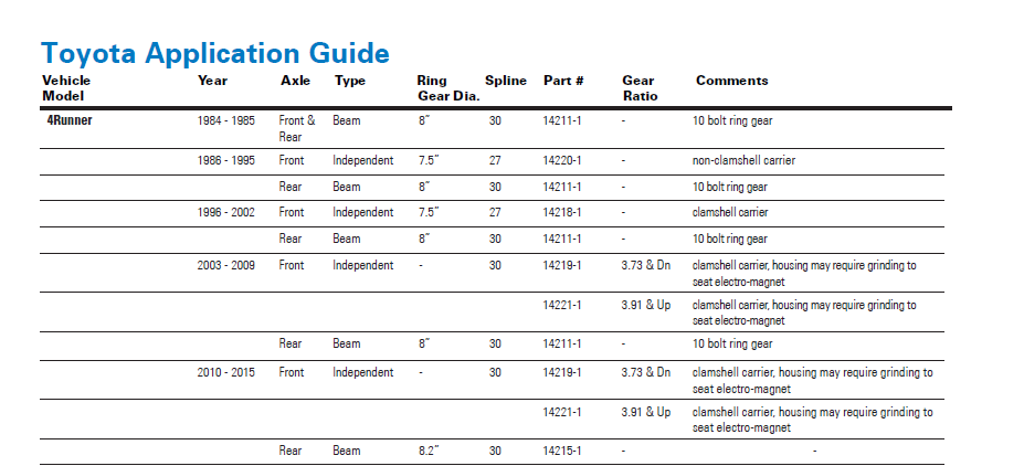

Yikes, given all these issues I hear about ARB air lockers i cant imagine why someone would use them. For anyone who is interested these are the official Eaton part #s
