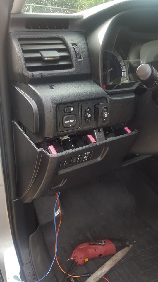

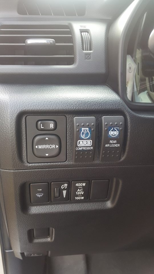

Do you have a photo of the Eaton locker switch? I'm getting conflicting info on whether they updated their switch to a toggle-rocker style switch. Asking because I would like to utilize the current switch slot where my ARB switch is, instead of fitting/cutting a new slot for the Eaton switch.

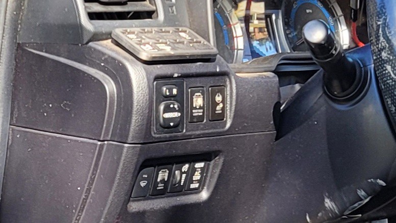

I used a different switch for it...
I used the switch from AOB instead but I've been deleting alot of my oem style switches and moving them to the switch pro
