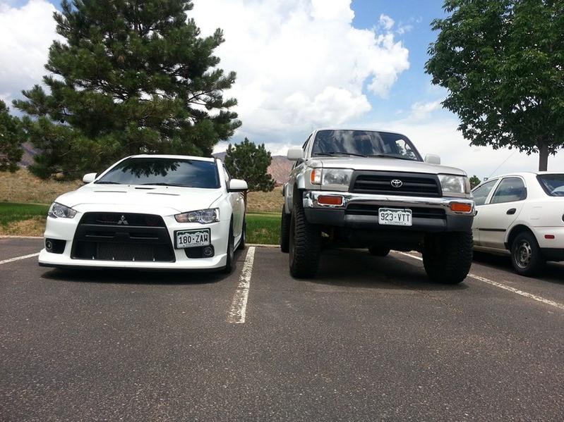

Those problems still happen on new cars. Even with a stock turbo charged, say evolution lancer x if you jab the gas real fast and back off you wont even feel it. Its not like a v8 where the power just comes in with the throttle, you litteraly have to get on it and wait for the power too come. I have been in many turbo cars and even new stock turbos feel like that.
All info I give is personal experience, you wont get hearsay from me, here is my buddy's evo next to my 4runner.

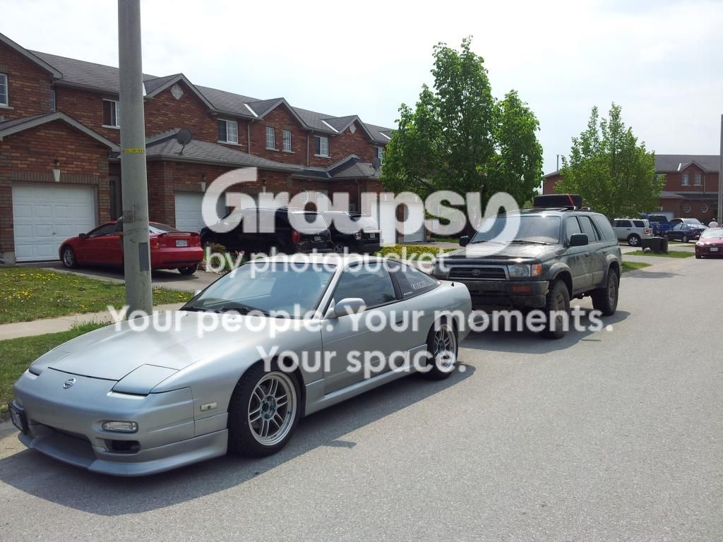

I'm not trying to say lag does not exist, i'm simply saying they can be reliable. I would not be interested in a single turbo set up on a 4runner, like i said in an earlier post a small twin turbo set up would be what I would, and hope to build in the future, main goal would be fuel economy.
that's my car, daily driven for 8 months of the year, 300whp out of a 2.0L motor, when you shift a 8000rpm lag is not an issue. I barely ever rev my 4runner over 3g so a single turbo imo is not the way to go unless your trying to make a drag truck. I'm just trying to make a point that turbos are reliable when quality parts are used, you have a good tune, and of course maintained.
