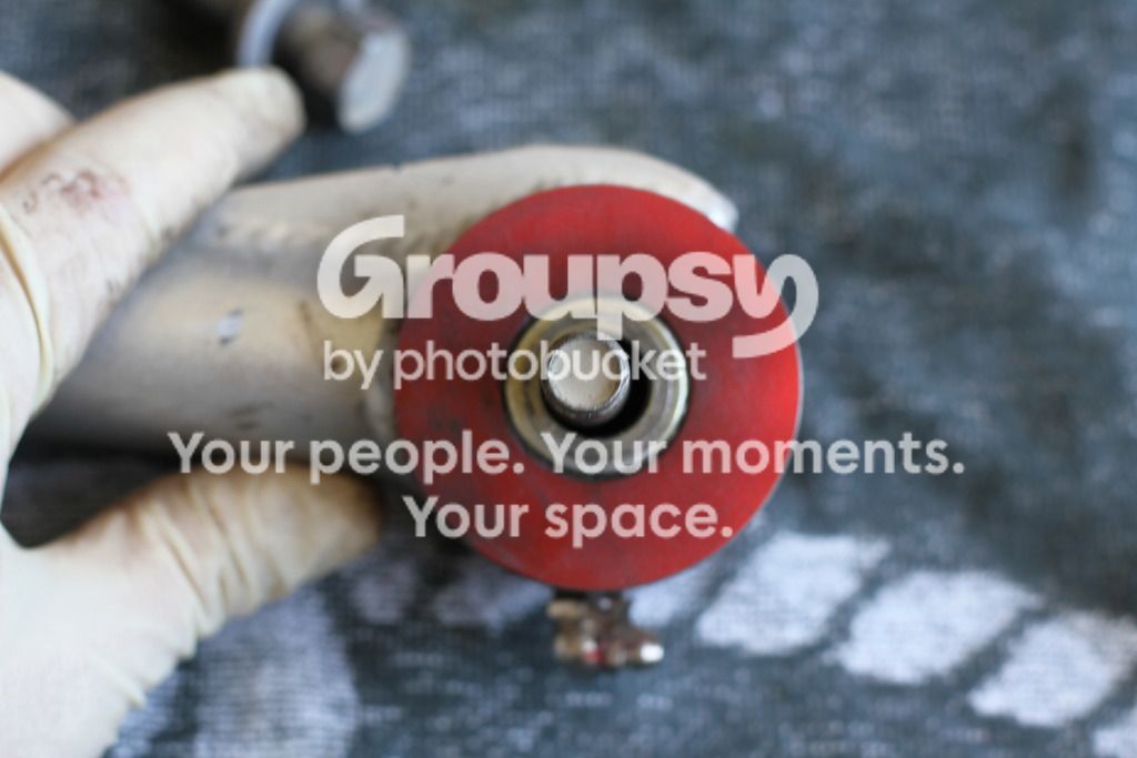

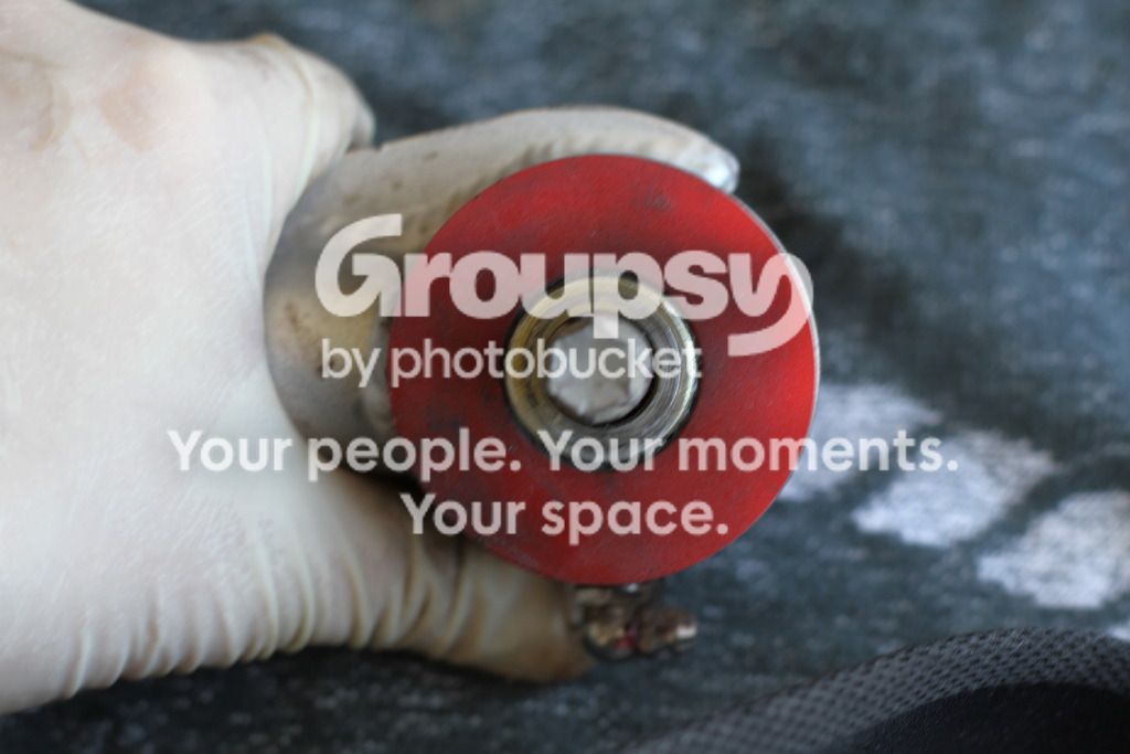

So I've been running these for a few weeks now including a camping and off roading trip. Overall, I've been pretty happy, especially off road. The rear end seems to float better and there's no binding/hitting on (almost) full flex. The only problem I've run into is with the rear uppers. The heims and bushing sleeves are set for a 19mm bolt like the rest of the rear suspension. The stock upper bolts are a 17mm bolt. 2mm difference allows for enough movement to get a clunk every time you stop/start. I'm undecided how I'm going to fix this, so for the moment I put my stock arms back in and that got rid of all noises. There is some noise on articulation from the panhard bar, but I don't think that's fixable. Otherwise I've been pretty happy. Pics are a little blurry, but you get the point.
What is the width of the sleeve? There might be an off the shelf solution.
I ordered my set for the 3rd gen and upon arrival I hope they work out! We will see if my set comes with the same sized sleeve.
I'll have to look. You would have to replace the sleeves and the heims to work with the stock bolt. Might be easier to grind out the stock mounts to fit the 19mm bolt instead.
Honestly I think you're way better off just going with new hardware instead!! Finding that sleeve, repressing it in, etc. Pointless!
Finding the hardware is the easy part, making the mounting holes big enough without getting too crazy is the hard part. Especially on the driver side, there isn't much room to get in there with a drill.
Die grinder with a 90 head would probably work. Juat sucks if you make the hole too big or out of round, you'll have the same problem all over again! Haha.
