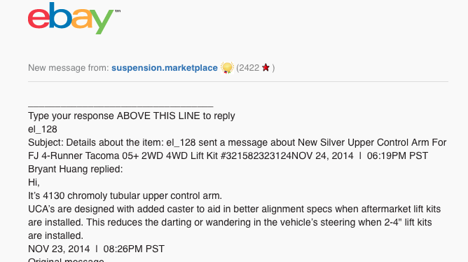

good news everyone, just got this message back when i asked what they were made out of and what alignment capability they had.
Wow thats actually pretty cool. Seems like they know what theyre talking about (at least to some extent). If I didnt have arms already, I would definitely buy them now haha
