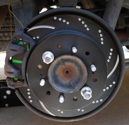

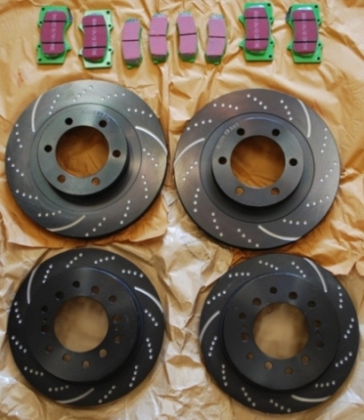

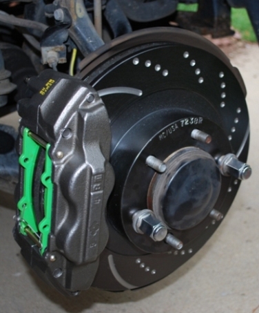

This weekend I installed a complete set of EBC sport rotors and green stuff pads. The upgrade went pretty easy until I couldn’t compress the frozen pistons in my front calipers. I ended up having to purchase new calipers which I picked up at Advance Auto. I didn’t want the bother of rebuilding the calipers. Measuring runout on rotors that are dimpled and slotted is a pain and hard to get a good measurement but hopefully I got the rotors mounted with the runout within spec. I bled the front brakes and the rear just to get new fluid in the lines. Now I’m just waiting for them to bed in. I’m a little disappointed with the initial performance but I’ve only got 50 miles on them right now. Does anyone else have experience with these type of pads and rotors? Is it normal during the initial bed in that brake performance is poor?

If we scoring brakes on looks those would be a solid 9.5:lmao:

Right now they don't stop very well at all. I'd have to say they're much worse than stock pads and rotors. They get very hot too for light urban driving. I imagine this is all due to not being bed in yet. They do look nice but the black anodizing has to be worn off on the rotor surface for the brakes to work in addition to getting bed in. If I really get on the brakes hard it does seem to work beter but I have to push the pedal way down. The fact that they're getting so hot under light driving has to mean they're not bed in and not grabbing like they should. Like I said I only have about 50 miles on them. The instructions say after 200 miles of light urban driving commence the final bed in by decelerating from 60 to 20 at least five times. I'm guessing that means hard braking. They don't make any noise at all. They're nice and quiet and smooth.
Right now they don't stop very well at all. I'd have to say they're much worse than stock pads and rotors. They get very hot too for light urban driving. I imagine this is all due to not being bed in yet. They do look nice but the black anodizing has to be worn off on the rotor surface for the brakes to work in addition to getting bed in. If I really get on the brakes hard it does seem to work beter but I have to push the pedal way down. Did you bleed the brakes? With the key on the whole time? The T4R has an electric brake booster and getting a good bleed is virtually impossible with the key off.The fact that they're getting so hot under light driving has to mean they're not bed in and not grabbing like they should. Like I said I only have about 50 miles on them. The instructions say after 200 miles of light urban driving commence the final bed in by decelerating from 60 to 20 at least five times. I'm guessing that means hard braking.Yes, hard braking, ideally to the onset of fade. What's critically important is to do it in the country, late at night.:confused::wtf: You want to be able to a half-dozen 60-20's then drive for 5-10minutes without stopping. The goal is to get the rotor temp back to a more normal range with a very even cooling process that can only be achieved by rolling with no braking. They don't make any noise at all. They're nice and quiet and smooth.
