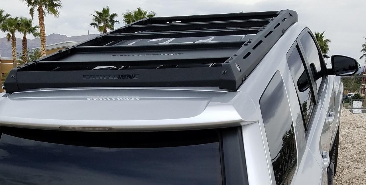

Here are some pics of mine installed. The other improvement that I would recommend in the future is even spacing of the crossbar mounting points along the rack. It would be nice to have the option to put the tray anywhere along the rack, but it seems that it only lines up with the front or the rear bolt areas. I saw that someone else had just drilled holes to make it work and I'll probably go that route with mine.

Now I need to get some black bolts I think.

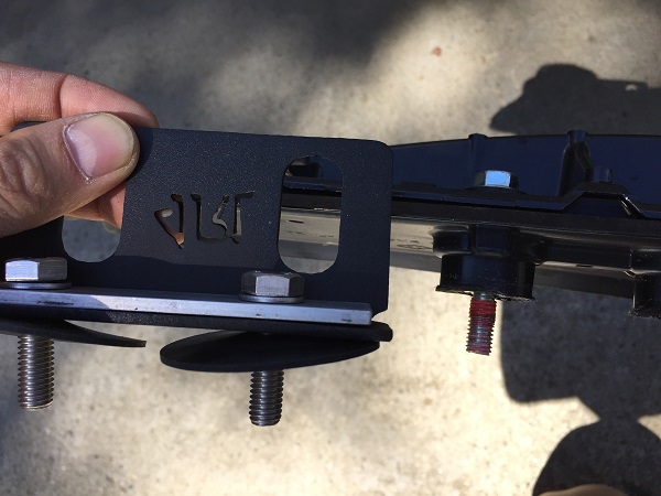

Overall, I like the rack, the price, and the customer service from Rorck has been great. I also spent quite a bit of time fiddling with the brackets that attach to the roof, as I think that part could use improvement, as part of the 3rd batch.
I made aluminum plates to go between the bolts and the brackets, filed/grinded down the edges on some of the brackets so it wouldn't create high stress spots when bolted to the car. I also used some rubber washers between the bracket and car to spread the load. I found that 30mm long M8 bolts with my stack up was pretty close to how far the threads extended on the OEM rack. After I bolted it all up, I wanted a bit more clearance between the driver's side front fairing and the roof, so I enlarged the bracket holes, and added an additional thicker rubber washer under the front brackets only, but it didn't add as much clearance as I was hoping for, so I'll have to try something more solid later.

I used the same setup as you. One of my brackets was low as well, I made another aluminum spacer and put it on the bottom of the bracket to raise it up some.
