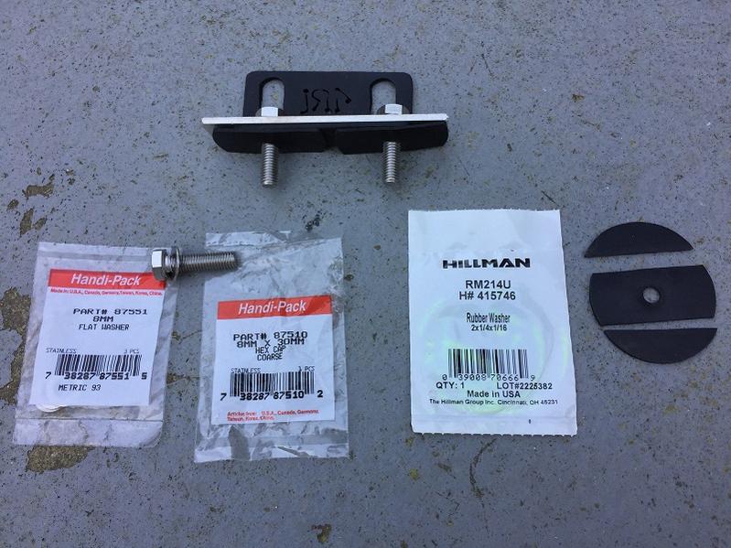

I grabbed some from the hardware store, I believe it was 3/4" wide by 1/8" thick.
Confirmed that I used the same dimension flat bar as well. Attaching a pic of the other parts I used for mounting the bracket.
I ordered black oxide fasteners from mcmaster.com, which seemed cheaper. I think 1" long would have worked as well, especially if you tighten everything down at once. Part numbers I used:
97763A363 18-8 Stainless Steel Hex Drive Rounded Head Screws Black-Oxide, 3/8"-16 Thread Size, 1-1/4" Long, Packs of 5
96765A150 Black-Oxide 18-8 Stainless Steel Washer for 3/8" Screw Size, 0.406" ID, 0.875" OD, Packs of 100
98514A041 18-8 Stainless Steel Thin Hex Nut Black-Oxide, 3/8"-16 Thread Size, Packs of 25 (maybe thicker ones would be stronger here)
Pic of the rubber washers installed around plastic sleeves attached. I added silicone sealant at every interface as well.

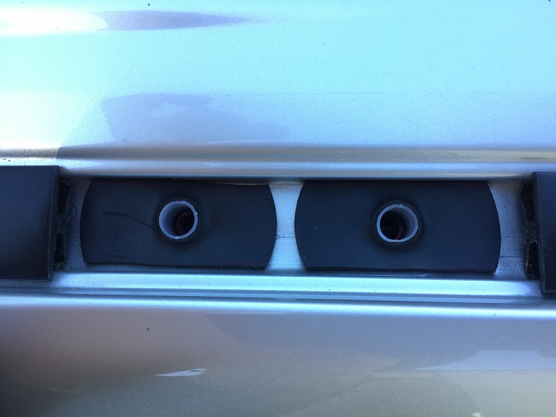

I am curious what the marine silicone was for. Do you mind explaining?
Post #629
http://www.toyota-4runner.org/group-buys/231393-ecotechne-roof-rack-group-buy-42.html#post2668010
If you look at post #629 by [MENTION=152421]4Radski[/MENTION] he shows the area where other members have put silicone. When you take off the OEM rack, there are four attachment points with these two holes... the 'L shape' brackets will bolt into these holes. With the roof rack's design, these holes could technically still be exposed to water when it is raining so it is just an extra precaution to prevent water from getting inside the car and onto the headliner.
