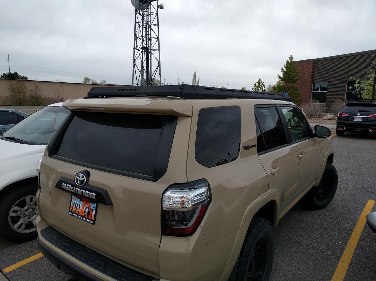

Finally got around to installing the rack and I'm digging it. Reading everyone's install and comments about the rack really helped and I totally agree with the major consensus. A very solid, awesome looking rack for a good price. Is there some rough cuts, dings, and scratches? Yes, but a little elbow grease and tuning , it will turn out just fine. I would have liked it even more if the "slots" on the side were true slots, but the back plate of those slots are held by small tac welds so I'm sure I can cut a slot there to give me an even better anchor point if I needed one.

Looks great! How long did it take to install, did you paint the bolts black or use different ones.
Been eyeing this one, just haven't pulled the trigger yet...
It only took about an hour with help from my roomie to get up top. I installed the mounts and waterproofed it the best i could, then loosely bolted the outer portions in my garage, set it on top, bolted to the mounts and went front to back and it all lined up perfectly.
I went to my local hardware store to find some black bolts since I didn't want to paint them but couldn't find any and I was too excited and couldnt wait any longer to install it so I went with the bolts it came with.

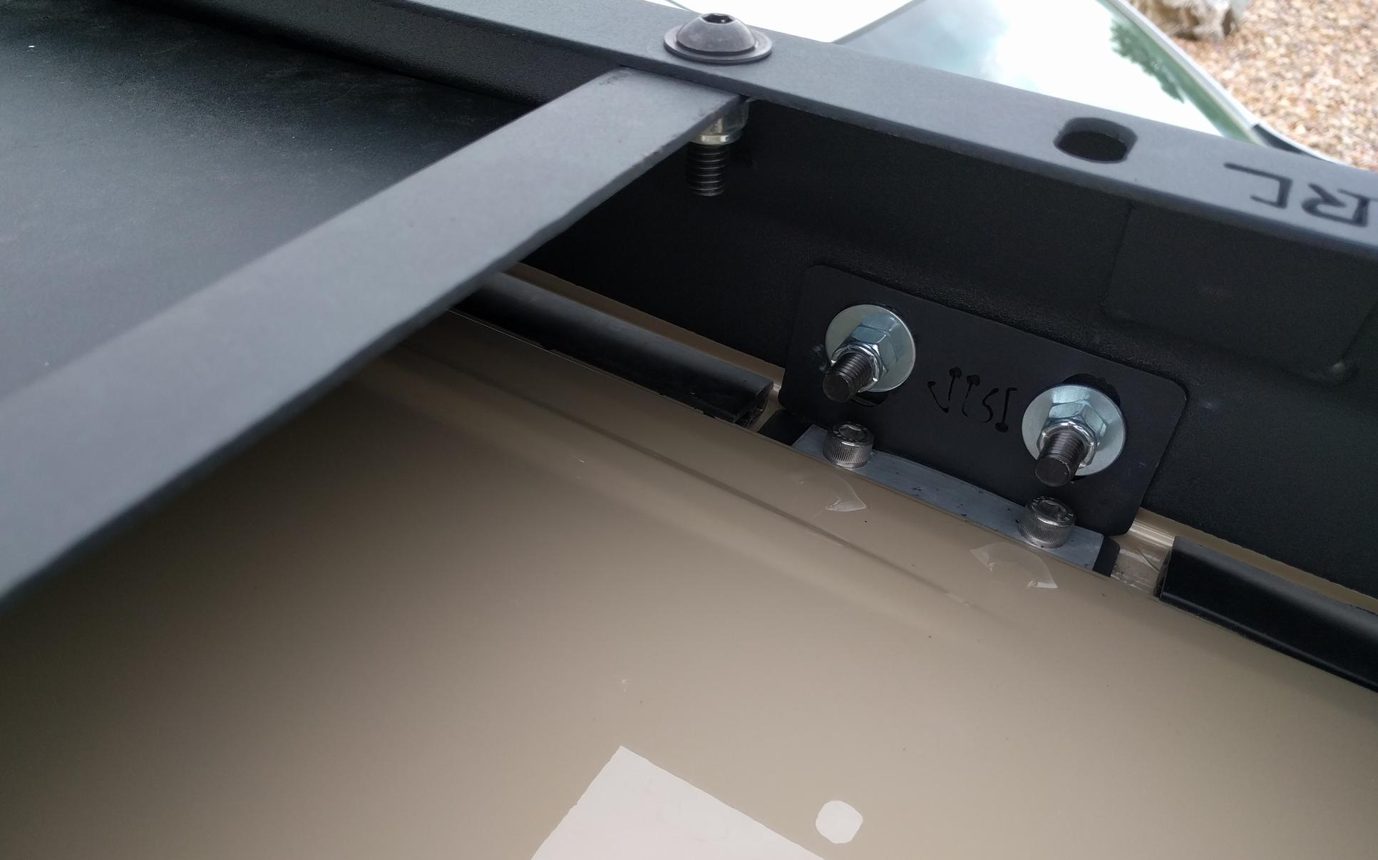

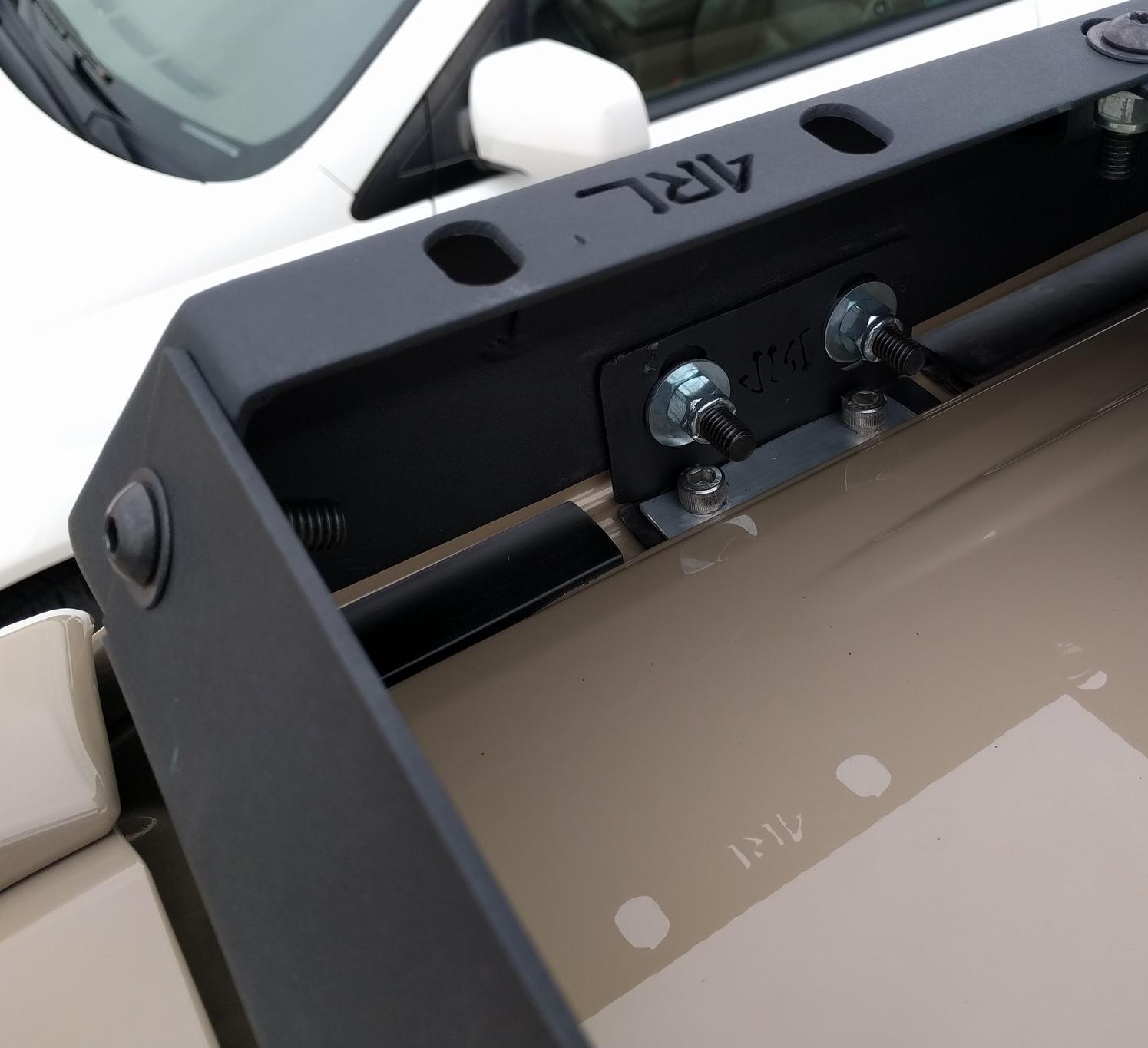

Confirmed that I used the same dimension flat bar as well. Attaching a pic of the other parts I used for mounting the bracket.
I went back and removed the whole rack this weekend to add the aluminium flat bar (3/4 x 1/16, 1/8 might be better) to all 4 brackets. I would recommend this be done to really give the mounting brackets the integrity they need. [MENTION=109477]Rorck[/MENTION], I don't know if that was discussed with Ecotechne, but adding the aluminium flat bar (or even in steel) would be a HUGE upgrade over the washers meant for the L brackets. Great stuff guys, keep it up! This is what a forum or group should be, helping to make things better for everyone. I still love the rack, and look forward to any improvements and accessories they put out.
