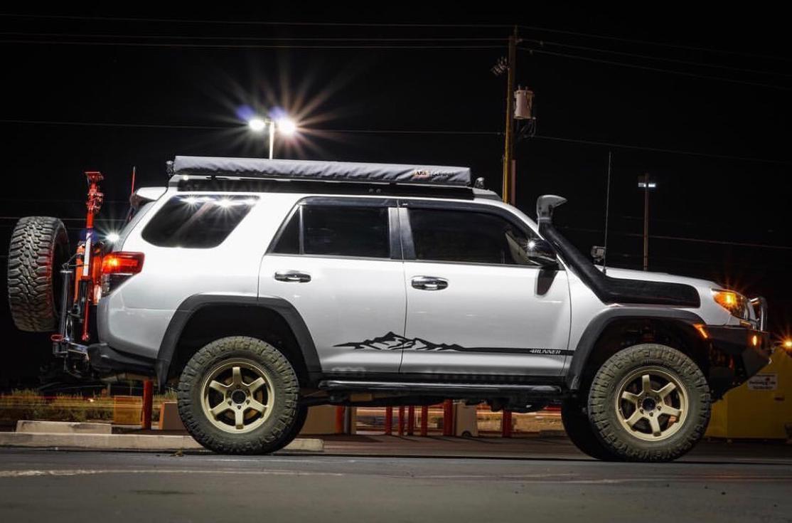

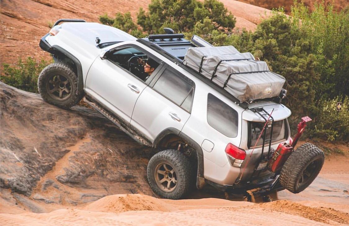

Has anyone been able to install an awning on the roof rack? I'm about to purchase one now and want to make sure I can mount it to the rack.
I have my ARB installed. Super easy! Since the rack has multiple mounting holes, already pre-drilled. Just buy some brackets from Rhino Rack, and your good to go.
If it is possible, can you snap some pics of the awning mounts on your new rack? I got the 2500 and I am waiting for delivery on my ecotechne rack. Thanks!

Assuming you just bought the universal awning brackets?
Correct, Rhino Rack has a great set. Here's what I used: https://www.amazon.com/Rhino-Rack-U...=1496945650&sr=8-5&keywords=rhino+rack+awning
I also used grade 8 hardware, with SS washers & ny-loc nuts to hold it onto the rack itself. A Little overkill, but I had some cheaper bolts snap while driving home from the mountains once, leaving my awning fluttering on the side of the truck. No scratches, thankfully!

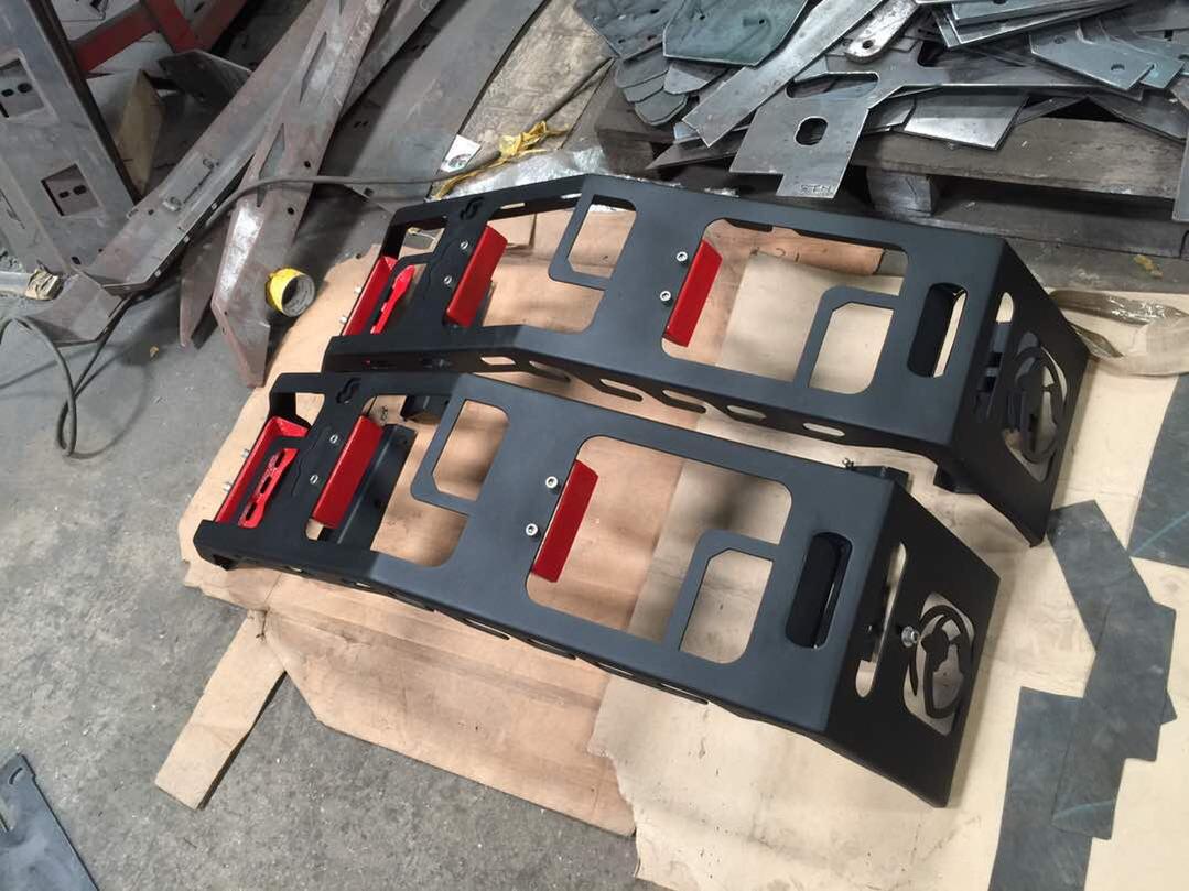

Finally! It looks like one will ship this week with order 7 so I can get good images and feed back. Once we give the go, they will start mass producing these.
