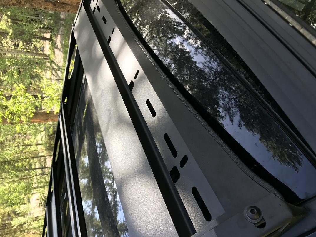

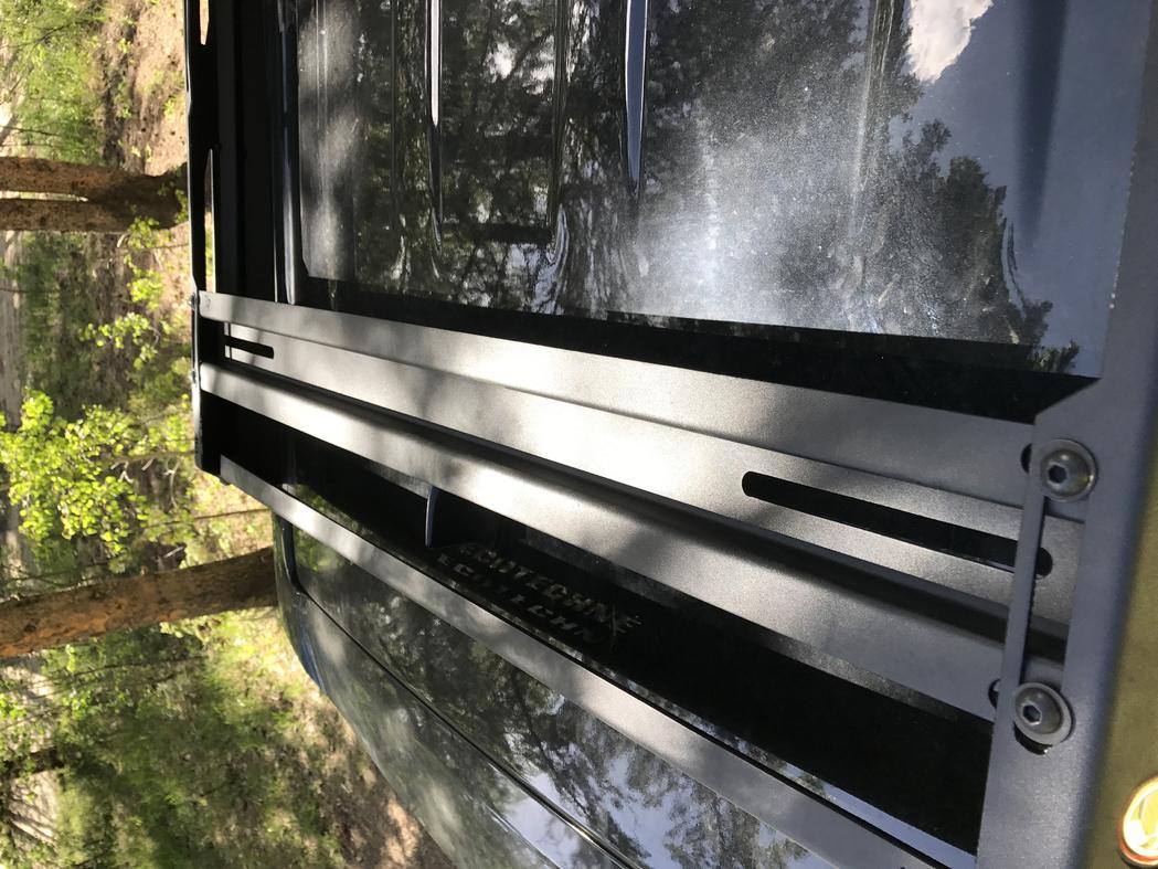

nice! Can you take some pics of the new front fairing and the crossbars?

Thanks! I think the tray, cross bar and sliding side rails are definitely an improvement. Im still not as sold on the front fairing. I think it makes getting a light bar almost necessary. Maybe the step is not as noticeable from ground level. I have a rack coming (9th batch) and was about to buy some black oxide hardware. After looking at your pics, im wondering if the bolts or washers need to be larger than the 3/8 everyone is picking up. Here is a list of what I was about to pick up from mcmaster.com https://my.pcloud.com/publink/show?code=XZOYEGZTe4AcmsrLk4c0XPgybl1LjFbJA1y

Looks like you could get by with your current size, but with the rack changes I would most likely go larger than 3/8 myself. Oh, and I think the new changes look pretty good. If they could offer a blank fairing for those not adding a light bar up top, that would be great too.

New design looks good, but before I powder coat it, looks like I need to drill more mounting holes (3/8") on the top sides of the crossbars and tray. The holes are for awning mounts, Tred Pros, hi-lift, rotopax, and Plano rifle case. Shovel will go on the side of rack with custom mounts and Quick Fists. I am debating buying the rhino rack mesh rack and securing it on top to expand my mounting options.
I ordered my rack (v 2.0) with the original front fairing as the parts are interchangeable. I think the new front fairing looks nice, but will probably whistle like crazy with all the holes.

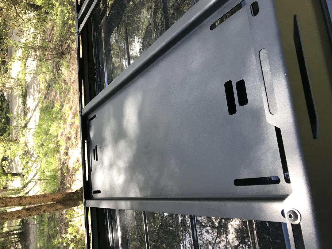

With the new changes to the racks( size of the slots) looking at the last photo, I would go larger than 3/8, the head screws and washers are not biting enough of the rack to safely secure the cross bars/trays for strength. For that application the washers should also be bigger and thicker too.

Well that's a bummer. I ordered the 3/8 hardware before the lastest photo of V2.0. Any idea what size we need to go up to?

01100101, Turn a crossbar upside down, place a screw with a washer in it to see what size will fit with clearing the wall of the crossbar. Repeat with the tray. That will get you the size option to use. Or measure the hardware it comes with and explore your options. With the new changes made to v.2 maybe someone who already has v.2 can help you with that. The v.2 ECOTECHNE Roof Rack looks very nice! I would even consider to add larger SS washers as needed, etch, clean, dry, paint black , and clear coat them with clear Lacquer.

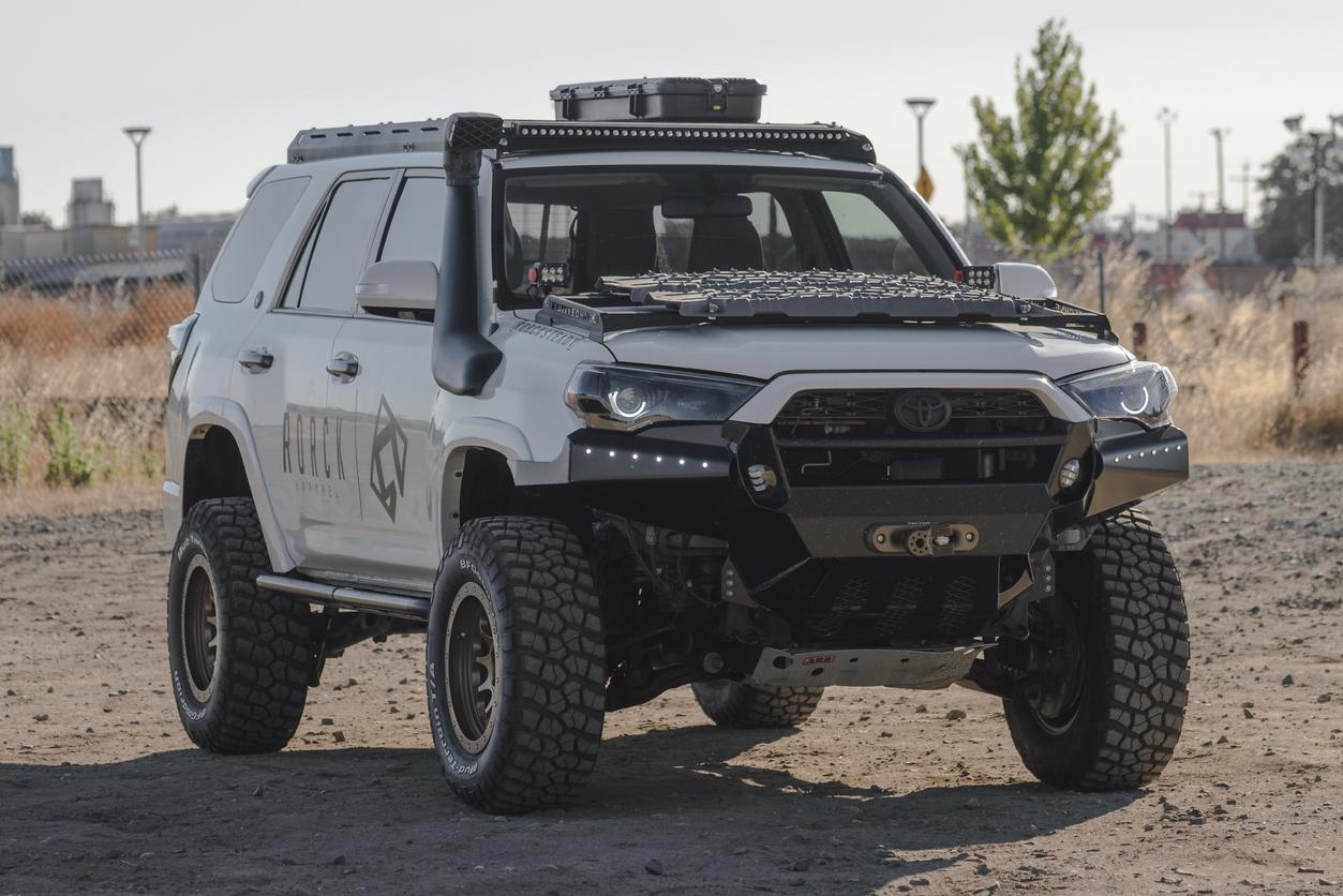

I finally got to install the prototype rack. This rack took almost a month in a half to get here because of FedEx shipping and then a little longer Getting painted but it was well worth the wait. All I can say is Ecotechne has listened and I had no problems installing. The only problem I ran into is not having the bolts to bolt the L brackets to the roof...
For those of you asking if you can just purchase the front faring, I've confirmed that it will not work. They had to make adjustments to the whole rack so that the LED cut out fit properly.
Over all I think everyone will be excited with this new design. I'll try and get more photos this weekend.
