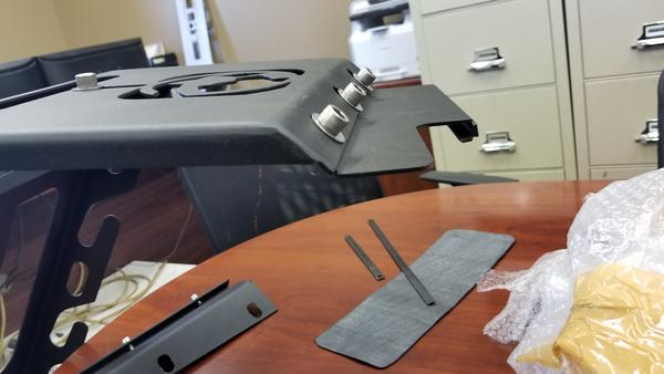

Thanks for posting that photo. My top ladder bracket is just like yours. My bottom bracket is just like yours was before you used your skills to flip that bracket angle. I'm impressed ! Great install, all the install angles look nice and straight/level with the vehicle lines. Looks like a new bottom bracket will do it for me. I have no welding skills. Thanks again.
Is this correct? The top ladder bracket is correct, and the bottom brackets are bent wrong (except for L-Forces bottom bracket due to his talented abilities)
The bracket on the lower left has the flange cut and bend flipped from what is needed, everything else looks good. Do you have the two slim strips of steel like in my pic? You need them for the 3 caps screws on the mount to push against for install so they don't push directly into the doors skin. For the record, I didn't weld it up myself, I took it to a locale shop here so I knew it would be strong. Cost me $30, but worth the piece of mind.
