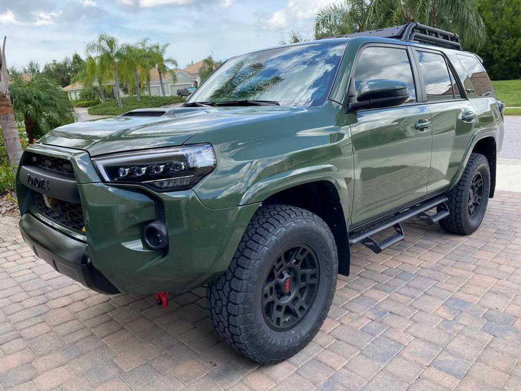

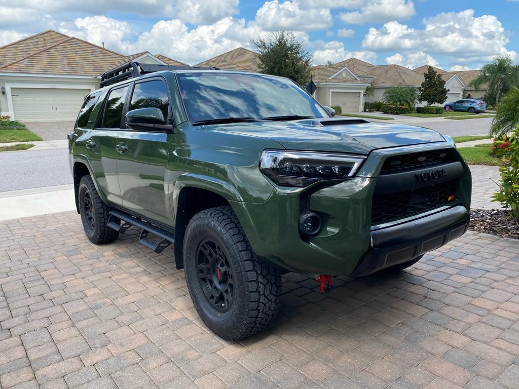

Here's my wanna be pro. Eibach set 2.5" up front, 1" rear and 285

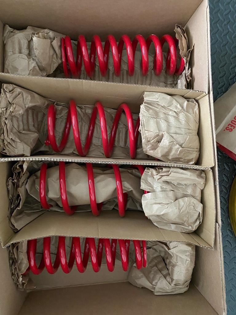

My springs have arrived. Monday or Tuesday I’m hoping they will be installed.

I went with the 285s. Thrilled with my decision. I have only the slightest rub at full lock on my aftermarket mudflats when reversing. I was expecting to do a little trimming or warping but I don’t need to do anything. I am clearing the uca by 1/4”. I could not be more pleased with the quality of the ride after the switch.
