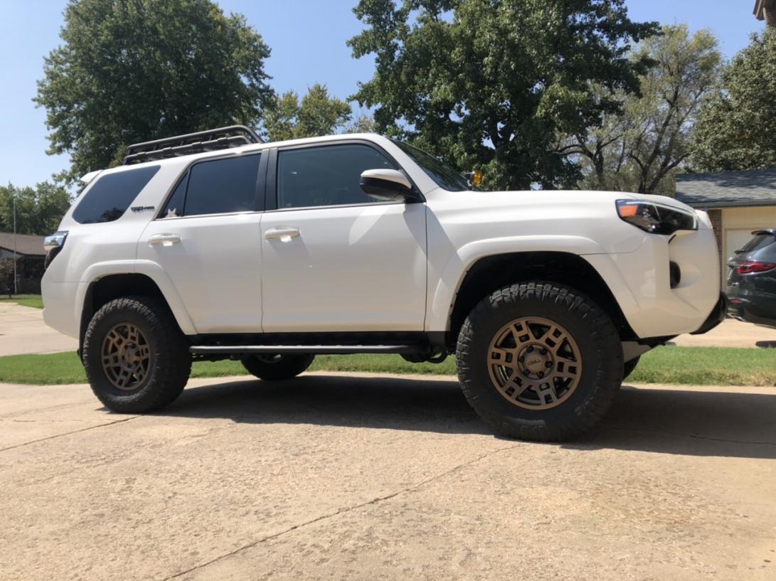

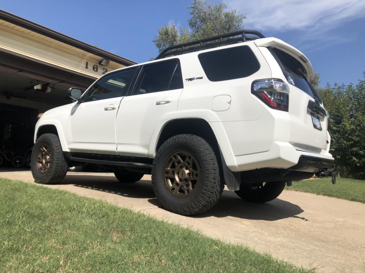

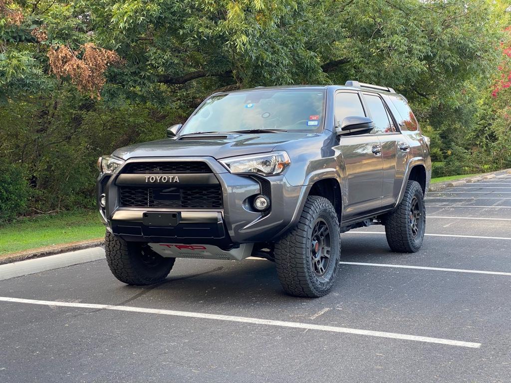

Now with the 285 Falkens. They look way better in person. I have some rubbing while backing up. If I didn’t have spacers I don’t think I would rub.

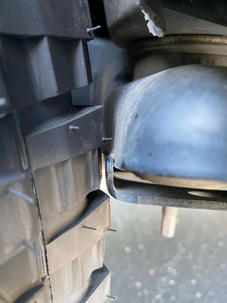

Before I go hacking up the bumper, I'm going to remove my spacers today and see if that will help with the rubbing. I checked the space between the UCA's and I have at least 2" of space so I know rubbing won't be an issue once removed. I will report back later today.
So I removed my spacers today and now there is zero rubbing anywhere. So glad I didn’t have to hack up my bumper. I actually prefer the more tucked in tire look. Now the tires are almost flush with the fenders.
Looks good DallasTrdPro!! Just curious question why with tires pushed out cause rubbing? Now I’m concerned my 8.5 inch wheels the tires will rub.
Just the arc is bigger with them out further. I have over an inch clearance on the UCA so I would say with TRD wheels it’s an easy fit with this lift as long as no spacers. With spacers you will be cutting. That’s how close I was to the body mount. It was way worse on the fender liner.

You will be fine with 285/70/17 with your SCS wheels. I have KO2's in that size and as long as you have aftermarket UCA's to dial in as much caster as possible, you should even be able to possibly keep your mud flaps in the front. My setup is Ray 10's, 285/70, with no BMC and still have mud flaps. If you also go with spacers you will definitely need to remove mud flaps and have a BMC done. In my opinion with the offset and width of the SCS wheels, you dont need spacers.

That’s how close it was with the spacers. Now I have over an inch or more without the spacers
I think it looks much better without the spacers. Nice truck :)
