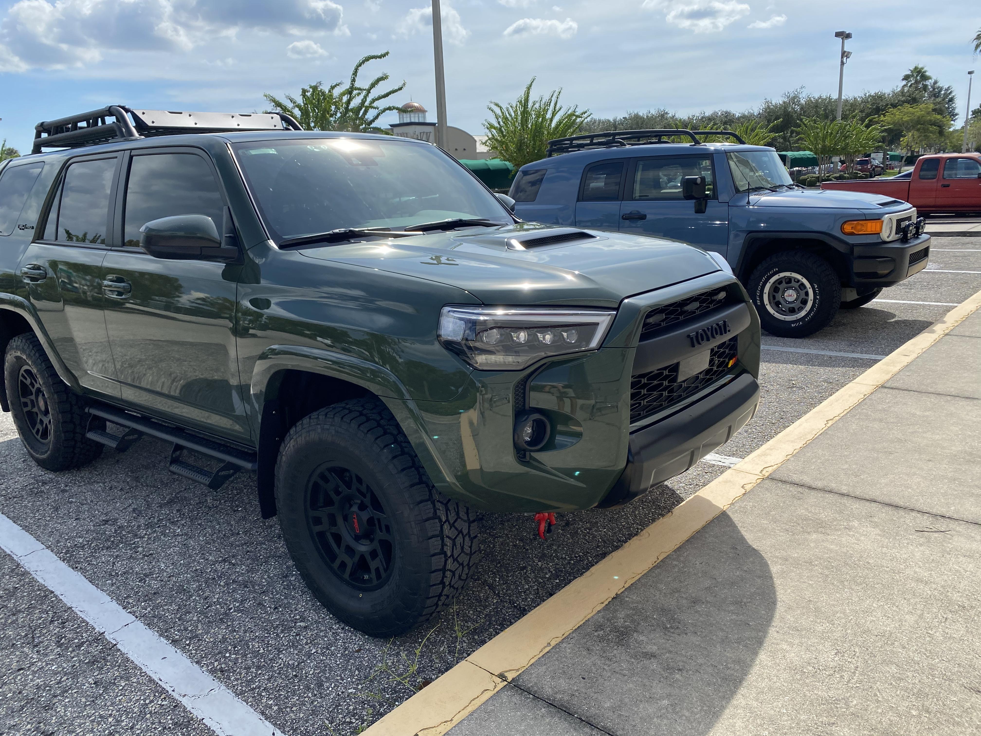

According to the shop I was able to clear because of the JBA upper control arms. They were set around 3.7 I believe. Hope it fits for you!
And I found a nice FJ to park beside lol :)

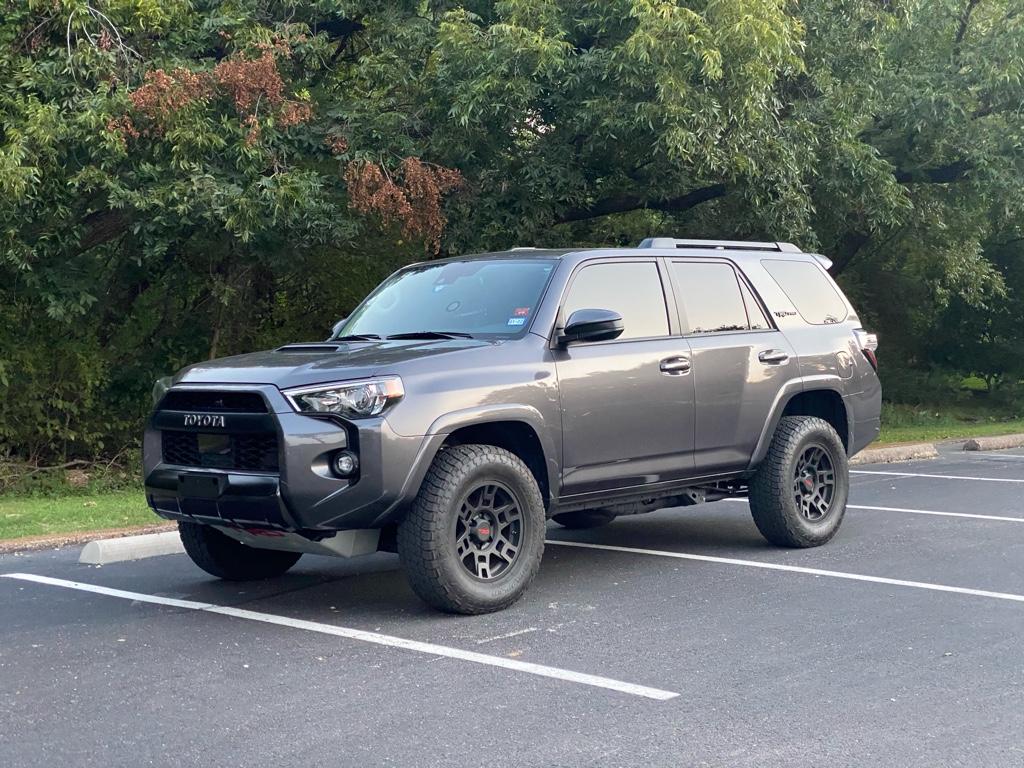

I would like to know what your center of hub to top of fender arch front and rear are. TIA
Driver Rear: 22 3/4”
Driver Front: 22”
Passenger Rear: 23”
Passenger Front: 22 1/4”
Note I do have a couple of bins in the back that might weight 50-75lbs

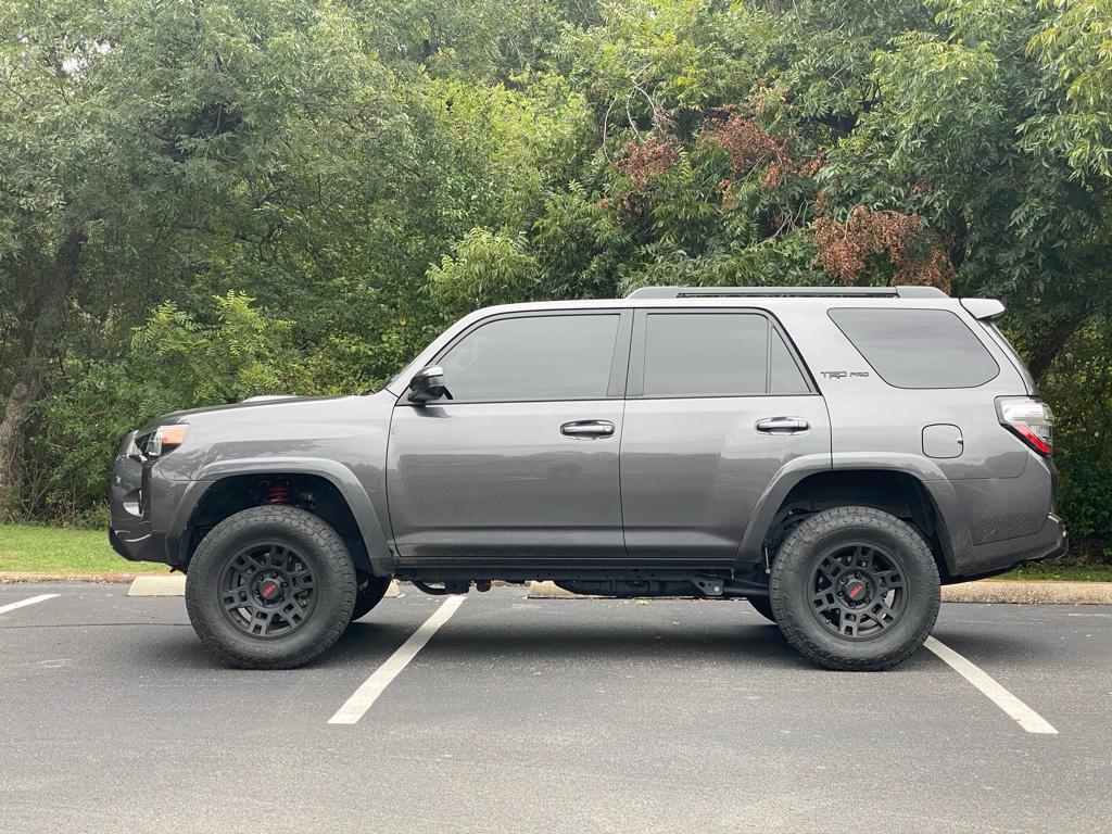

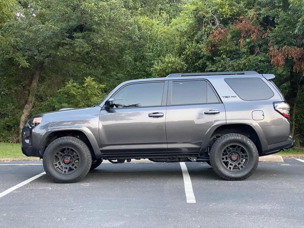

Thanks for sharing this information. I was wondering because I have zero clearance issues at slight to moderate articulation with my Cornfed 1.5/1” spacers and 285 AT3W Falkens. My front is 22.5” and rear is 23.25”. I know all these 4Runners are different, but, the Pro with the wheel width and offset along with the fender liner mod clear better than the other models. Would be interested to feel the difference in ride quality between the specific length springs versus the spacers. Mine seems to ride pretty well. I am running a SL tire also.BTW, your 4Runner looks great.
