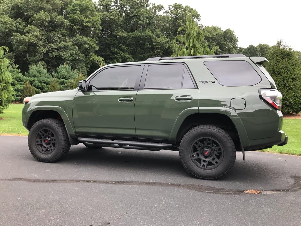

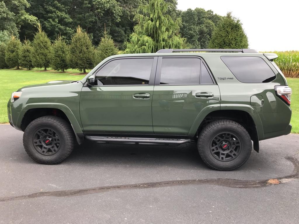

Thats good to hear! Thanks for the additional photo. I know 285’s can be done with some effort but the 275 C load Wildpeaks are looking more and more appealing. Hoping to get more feedback on ride and off-road use from people.
Thought about 285s, but since a 7" rim is too narrow (per manufacturers) I didn't want to go down the rabbit hole of finding new rims (yet). More than enough tread and capability in this setup for me. Time will tell how the F Wildpeaks hold up, but I'm seeing them more and more with great reviews.
I know people run 285s on the trd wheels, but I like to follow spec (#engineer). Will likely stick with this setup for some time, maybe a winch install later.

Your pictures convinced me to go with 275 as well. I think it looks perfect :) How do you find the Wildpeak road noise versus the terra grapplers? About 1mpg loss?

Not sure about the mpgs yet, I was really loaded down on most of the miles on a trip out west, now I'm driving around the city and getting about the same city mpg as usual.
Not really noticeable noise change from my perspective, the TRD exhaust kinda drones out the tires anyway :rockon:
Here's another angle for reference. 275 wildpeaks
Super stoked with the kit. Did great on and off road. I've put 3k miles on them at this point. Very satisfied customer.

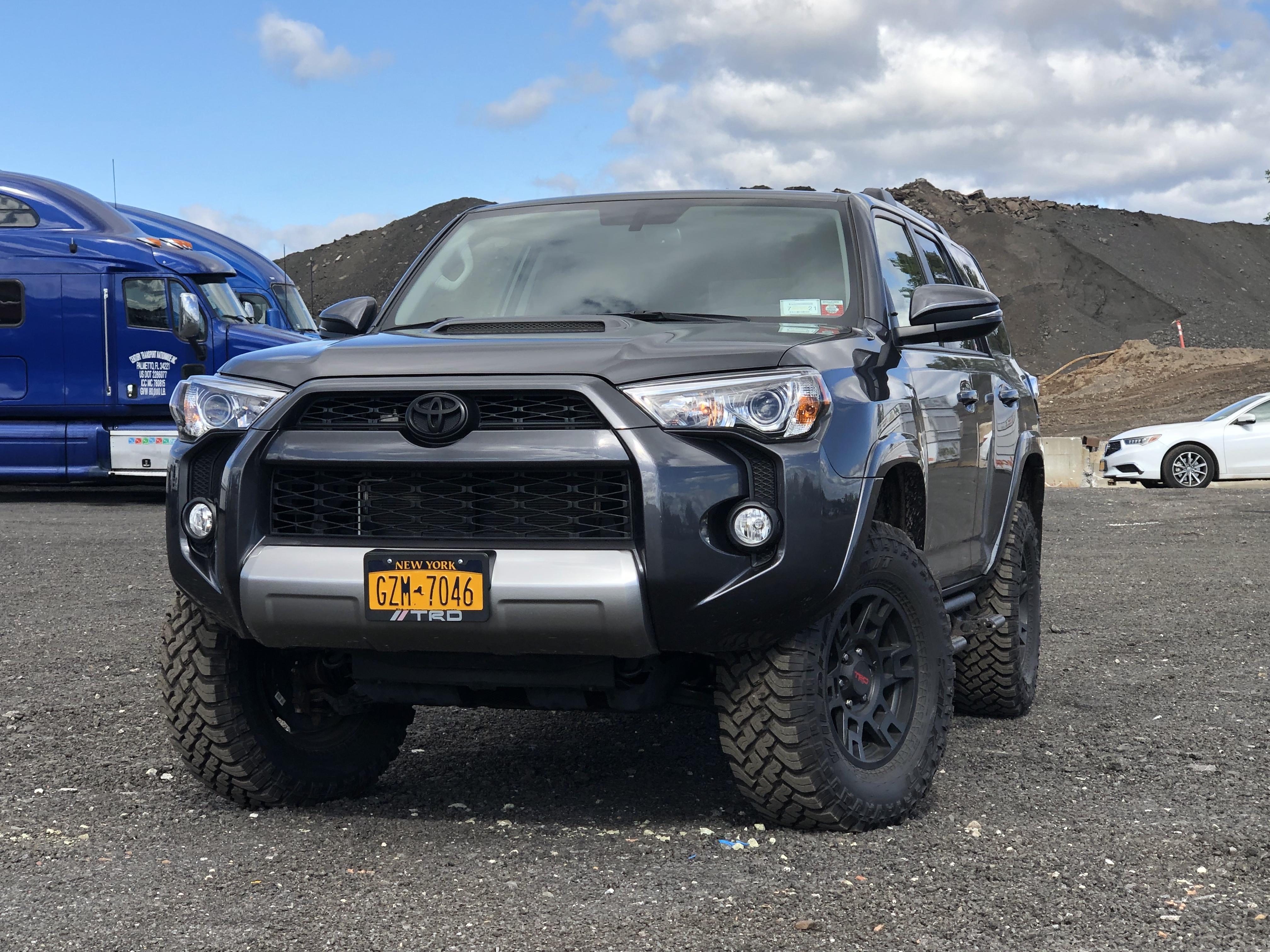

When I went to a 1.5/1” spacer lift on my Pro with BFG KO2 275’s in an E load I lost 2mpg city and 1.5mpg highway. I went up to a Falken SL rated 285 with the same lift and my city mileage is close to 1mpg better than the 275’s due to the tire weight.

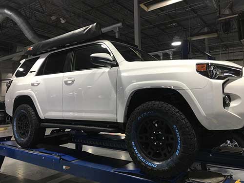

Just had the springs installed with and 285/70/17 Cooper Discoverer AT3 XLTs. Caster set to +5 on JBA UCAs. ABS line had to be relocated due to the UCAs Had to push fender liners in and needed some trimming to bumper. No rubbing at all. Rides pretty much like stock even on 10 ply tires. Road force balance was also done.

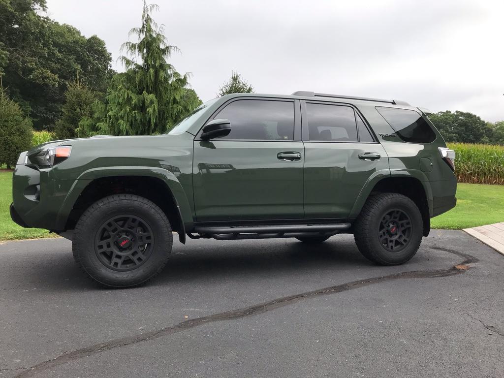

Put my eibach fronts, Toytec 1/4” front shim, c59-505 rear springs with DR side 15mm shim on today. Took longer than expected working with my 5yr old. Didn’t have time to get the SPC UCA on today. Will need to do that later this week.
Ran into an issue with my DR side front LCA cam bolt. Couldn’t get it tightened. Hoping alignment shop can get it done. Not sure if it’s just rust or if it got cross threaded going back together. It’s not easy keeping the cam steady while trying to tighten to 129 ft lb on jack stands.
Took before measurements. Will post up b4/after #s after I take it for a spin and remeasure. It looks high. Hope it settles in front some. Slightly nervous the springs didn’t seat perfectly. I used the no spring compressor method and it was hard to get them bumped up against the edge/end of the rubber isolator.
Front B4: 20.5 DR / 20.5 PS
Front After: 22.4 DR / 22.5 PS
Rear b4: 21.75 DR / 22.25 PS
Rear after: 24.25 DR / 24.5 PS

Just picked it up today. Loving how it rides. You can tell driving it that it’s higher. I will check measurements when I have it sitting on a level area. The pics it’s on a little slope. Checking the clearance for the front tires turned I think if I go with 285’s on my SCS wheels 8.5 will clear with mud flaps removed and making adjustment with the lower front fender the black part.
