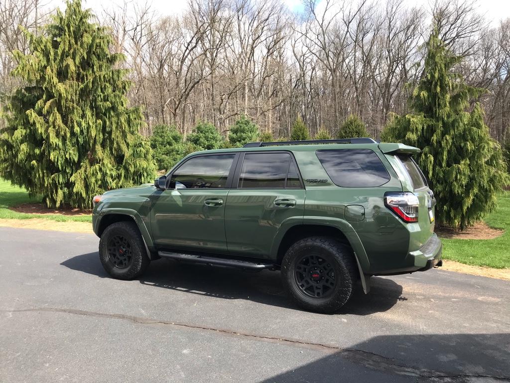

Also my friend that does all my work pretty much on my vehicles for a long time. Doing the rear took him about hour. No need to remove the tires in the rear. Now the front were a different story. Compressing the springs were a little harder for him because the one set he uses to compress the springs did not work out so he had to make adjustments with his other set. Trying to make a long story short. Lol.
Before pic it was done.

Do you have a spacer in the rear in addition to the Eibach spring? Looks like it has a nice rake still compared to other pictures I’ve seen with this kit.
No I don’t have a spacer. I noticed the same thing when I picked it up at my buddy’s garage. I like that it sits a little higher in the rear. Maybe after it settles it will look different. It cost me $370.00 to have it done.
Love it :) Do you mind measuring to confirm the rake at some point?

I was planning on measuring it some time tonight or tomorrow. I will post it. I did it before the lift. I’m also holding off on the alignment because my friend said put some miles on it before you do the alignment.

Hey peekaboo, I did some measurements this morning. I got the 1.6 front and rear 1.0. I know every 4runner is different as far as when you lift it. Some guys get different measurements when same lift is installed. It seems when my Pro is sitting on a level area the back looks higher like the factory rake. Pics are deceiving. But seeing it in person my rear looks just like factory which I prefer it that way. Hope this helps.

Beautiful, thank you for following up. I intend on buying this kit and this is very helpful.
