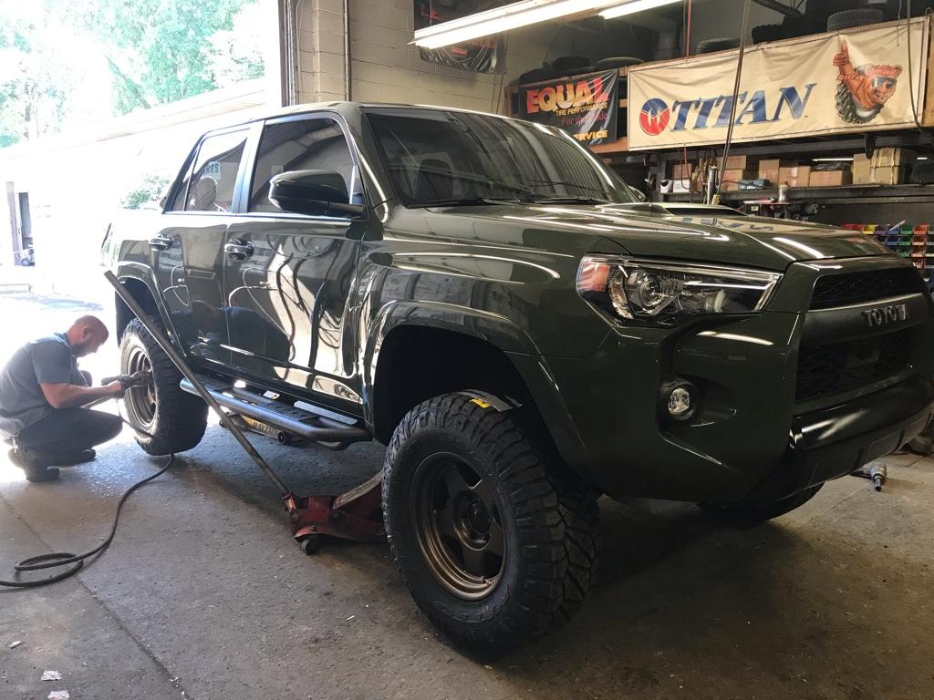

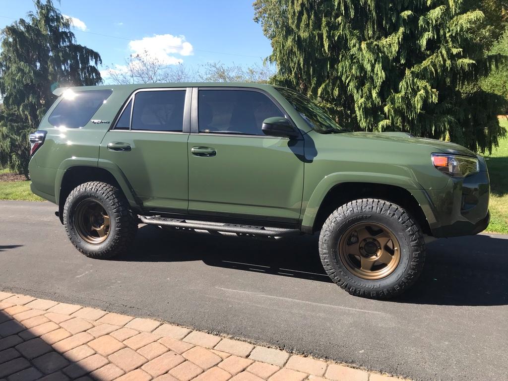

Had this lift installed for a week and I want to say I love it. Love the way it drives and love the way it looks. I've never installed a lift that I didn't find something wrong with it, but this lift is perfect for my needs. Now the long term ramifications of the Fox shocks are not known.

Looks perfect! So all you did was install the springs and 285's then go for alignment? No UCA's, no BMC, no trimming the bumper? Do you know what your caster numbers are? I'm hoping it's that easy for my lift too.
No UCA's. No trimming of any kind. All I did was add the springs, then the 285’s, went for an alignment and then remove the spacers because it was rubbing. They were able to get 2.4* for caster. Toe and camber were in spec. It drives straighter than it did from the showroom. I’m very happy with how it turned out. No idea if it will need trimming once I see it flex off road.

Here is some pics. Added my SCS wheels and no rubbing. Removed front mudflaps. Planning on adding the Rockbloz flaps.

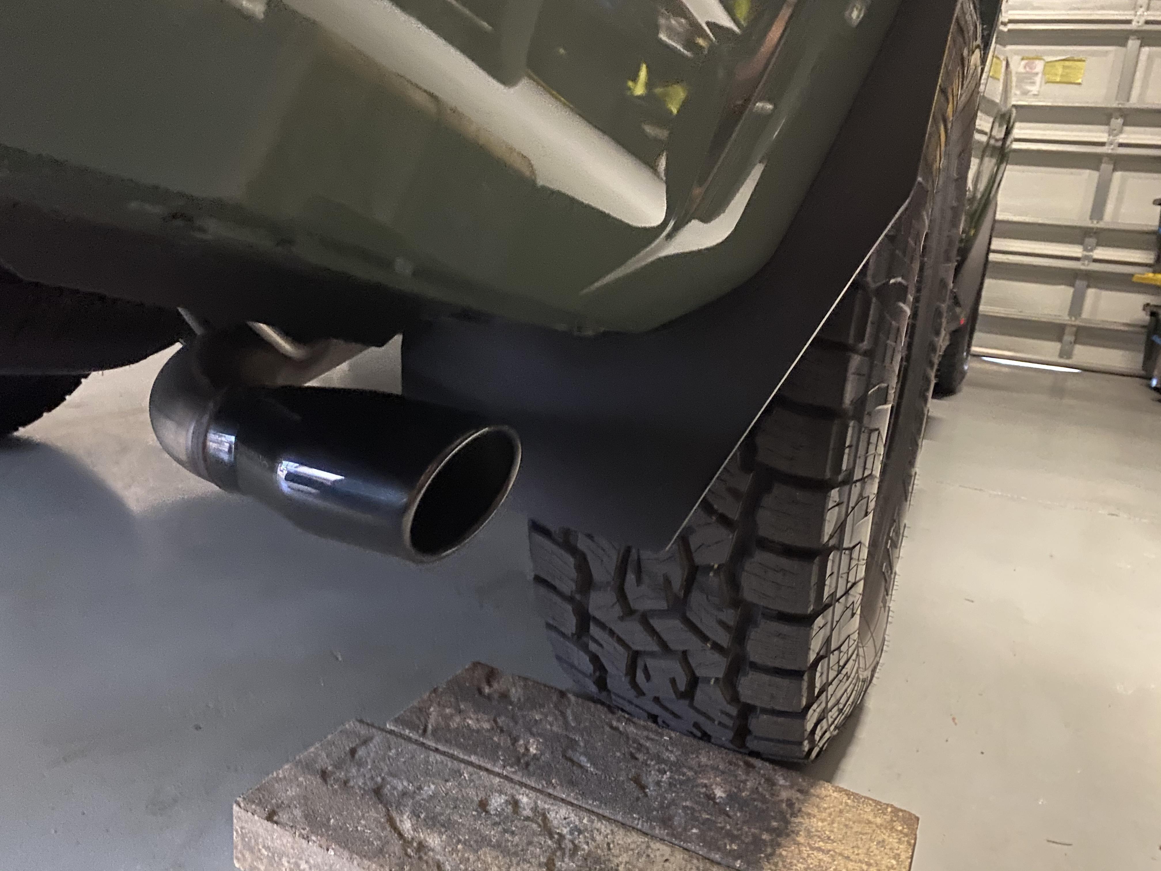

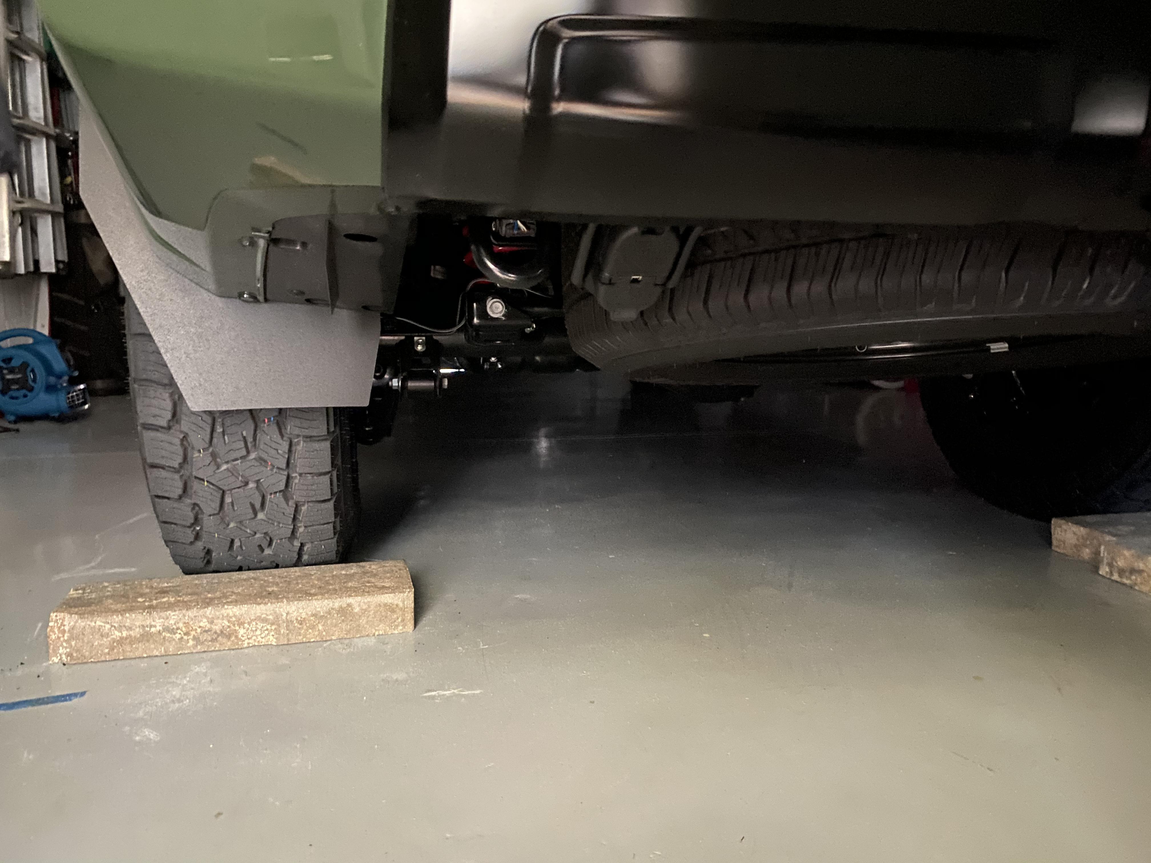

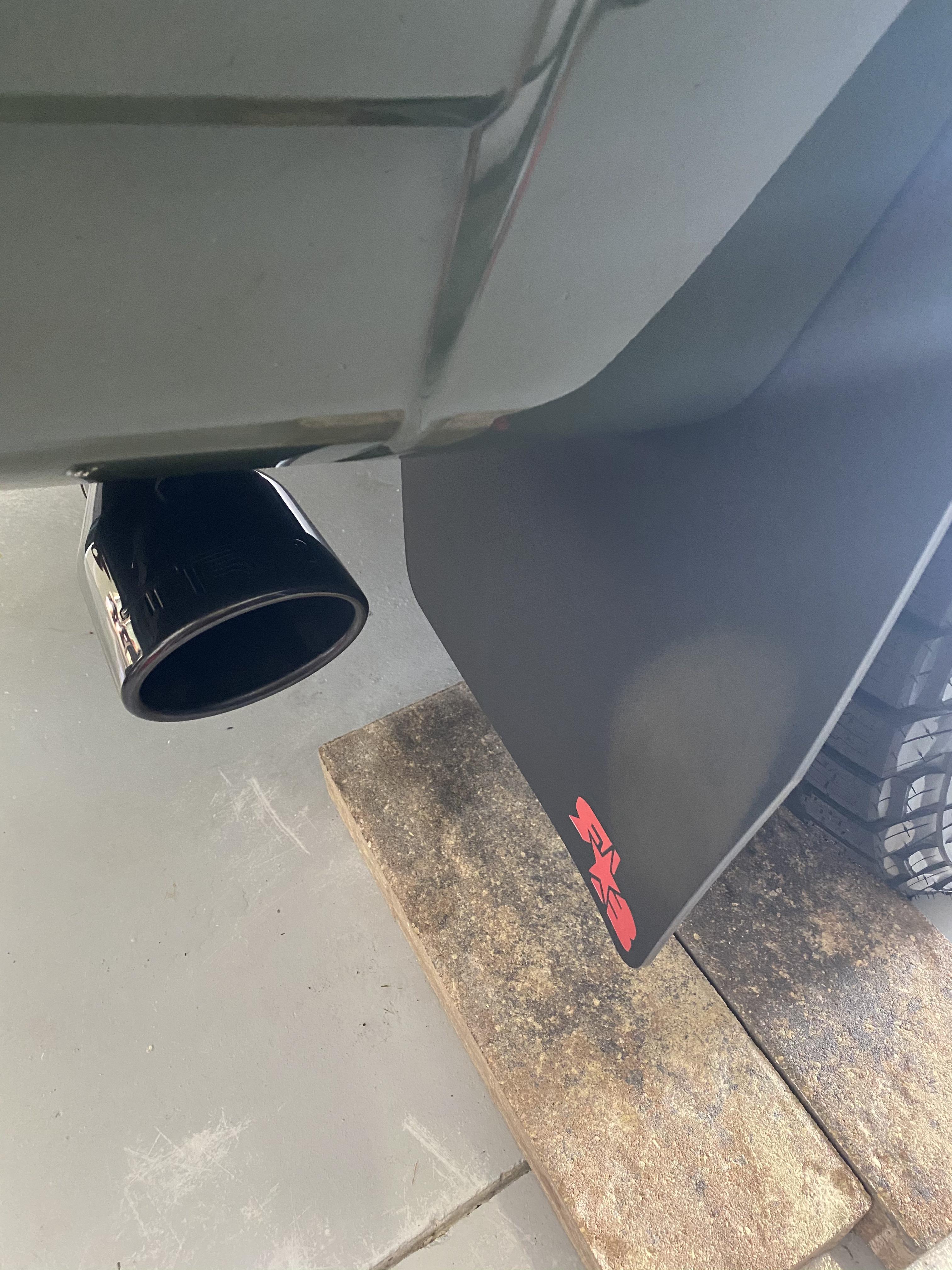

So I got the Rokblokz mudflats because I did not want to have any clearance issues. The problem is that my rear passenger flap started to warp and look shiny close to the TRD Pro exhaust. Ended up contacting them and they send me two new ones for 10 dollars shipping. I ended up just cutting the warped area off the original and matched the other side. Hope that helps :)

For sure. That was another major consideration for changing them for me as well. Now that the Rokblokz’s are modified I like how they look and no more warping and much better than no flaps at all :) I scored and snapped with a blade and sanded the edges after. Happy with the end result.

You also have the Rockbloz on the front correct? So if I get the Rockbloz I will need to do that to the rear correct?
Yes I installed them in front and back. And yes I would recommend cutting prior to installing them at the back to avoid the warping. I cut the bottoms so they are just below the exhaust and cut the sides where the warping happened on the right side. It’s where the exhaust hits the flap when it exits the exhaust.
