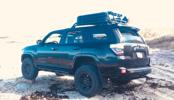

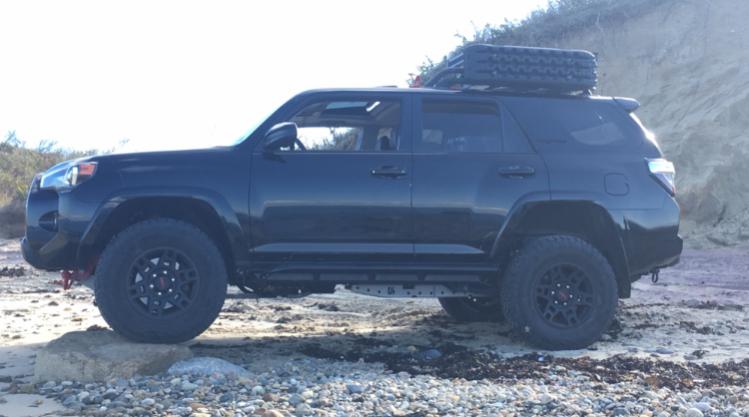

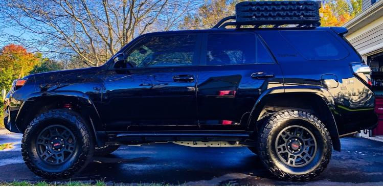

Finally got around to taking a pic (can’t seem to post it though) after installing my Eibach pro springs in the front with toytec 1/4” top hat spacers and SPC UCAs. In the rear I have Dobs c59-509s and a 15mm shim on driverside. Added 285 KO2s. I ended up with 2” lift all around. Love everything about it so far. Had it on a rocky beach in a Montauk NY two weeks ago and it felt great. Will get it on some trails soon.
I had Spidertraxx on but the overlanding shop that did my tires and alignment didn’t have time to do my BMC so they took them off when installing the tires. I thought I needed them to clear the SPC, but the shop said I’m fine. No rubbing and no trimming. I even put the mud flaps back on.
Chopped the size of the pics...
