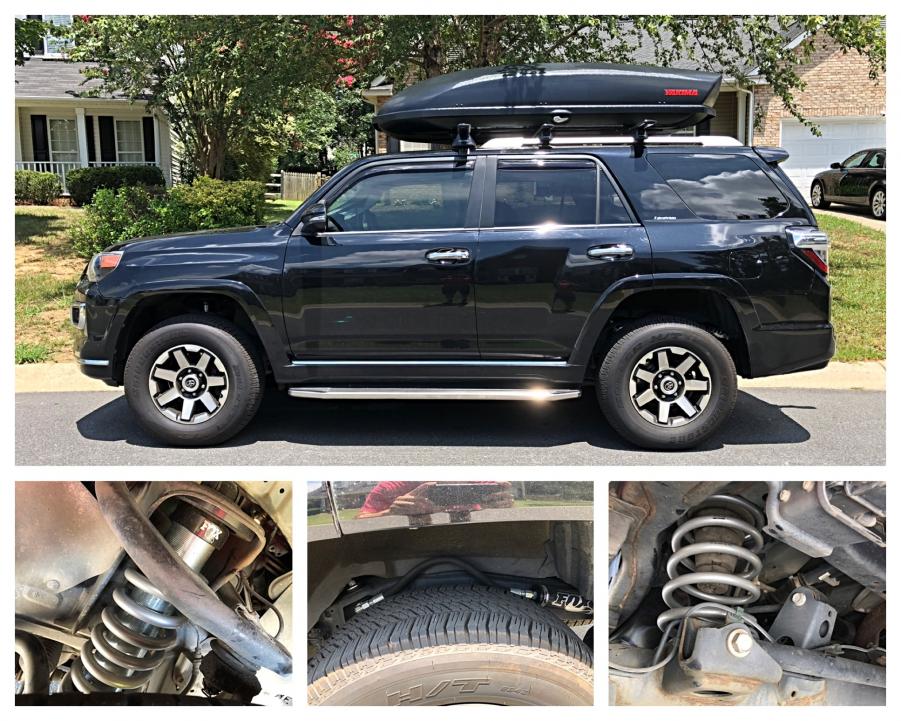

Leveled 2014 Limited w/ Fox 2.5 front coil overs and rear shocks w/ factory rear springs, but with passengers & any weight in the back, it rear raked and bottomed out the rear shocks on big bumps and undulating hwys.
Day1 w/ the rear Eibach springs and they are firmer but very comfortable. Sitting almost +2” but maybe they’ll settle some. Gives a noticeable slight front rake that I’m hoping will be better when loaded. Will update with more miles
Called Fox prior to buying and they said the Eibach’s are a perfect match for the 2.5s and +1” should bring the shocks up into the softer initial stroke, where they were riding a bit low on the factory springs in the firmer mid-travel valving
Just got back from a 160mi trip, loaded with family and gear, and the 4Runner is SO much better. No more rear squat, and the ride was so much more controlled and comfortable. The Eibach springs are indeed a perfect match and feel totally controlled w/ the Fox 2.5 resi. If you’re on the fence, do it! Now sitting at 36” to fender front, and 37” rear, unloaded, so about an 1” settled from initial install
