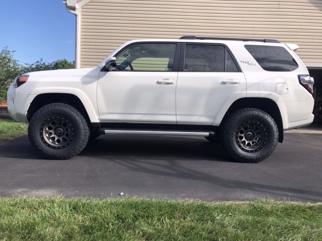

Eibach Pro lift installed yesterday. As many others have said, noticeable improvement over stock, overall very pleased. 285/70/17 Toyo AT3’s.
Sliders are on order, leaving the running boards on for the time being, better half is somewhat vertically challenged.
Alignment is meh, long story short shop left a little to be desired. Going to let it settle for a week or two and try another. Installed SPC UCA’s with the lift, been down this road before.
Not sure if it’s your picture but looks like it ended up with some reverse rake....what settings did you you on front struts?
Yep it’s the image, noticed that myself after I posted it, truck is sitting on a slight incline. Struts are set on the first groove and still have about 1/2“ of rake.
