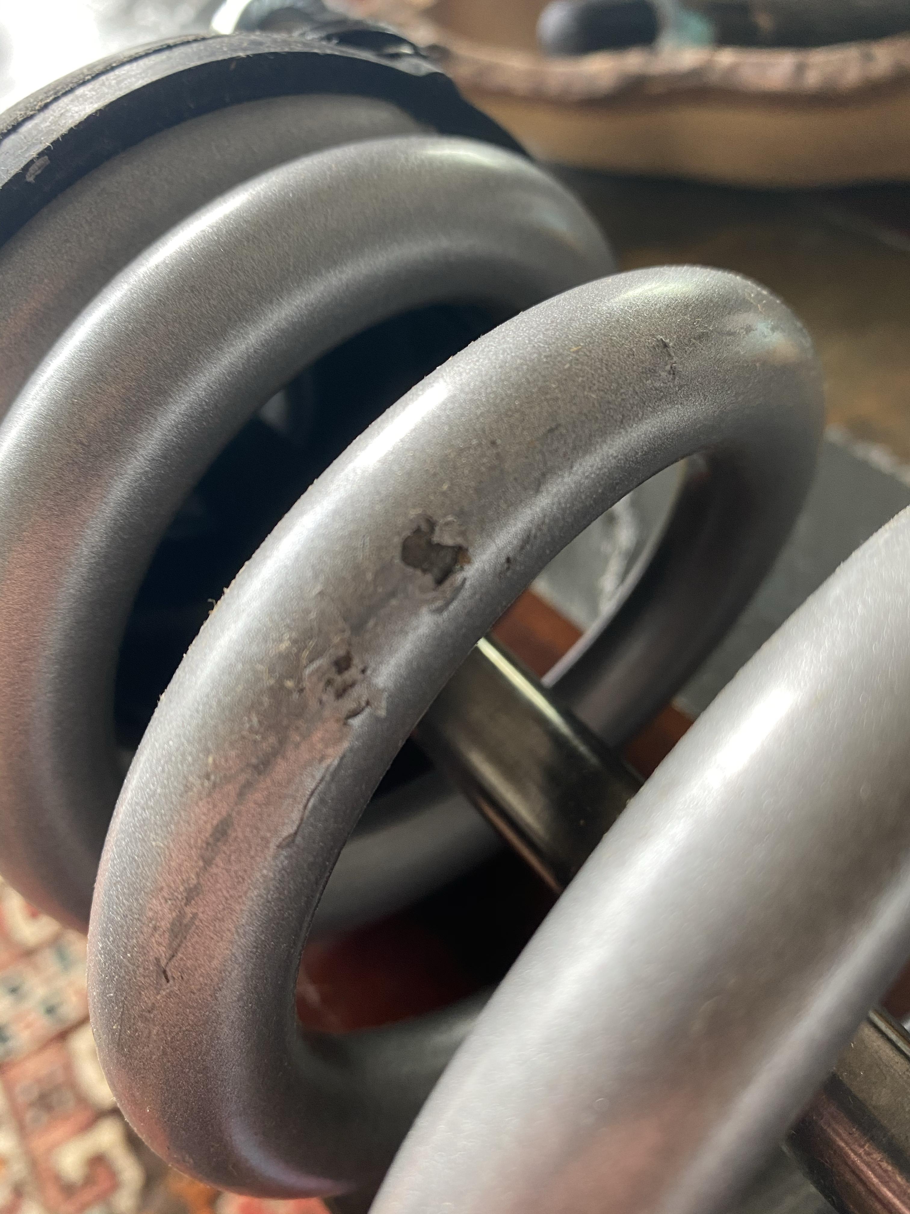

Just got my kit. Is it normal for the finish to be chipping off the coil already? These have never been installed fresh out of the box.
Do you have tophats installed on them. Taking a wild guess, whoever installed the tophat damaged the finish on the spring.
