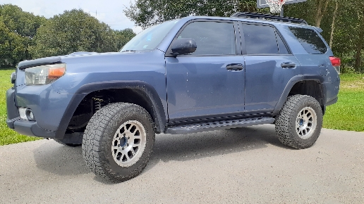

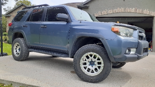

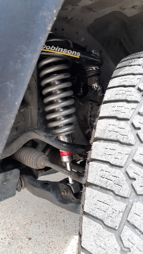

Shocks: 4 Eibach Pro Truck, fronts are installed on the bottom ring.
Front Coils: Dobinsons C59-302 (advertised at 2.5" lift)
Rear Coils: Dobnsons C59-325 (advertised at ~2.0" lift)
Stock Hub measurements (I have 3rd row seats):
PF & DF: 19.5
PR & DR: 21.5

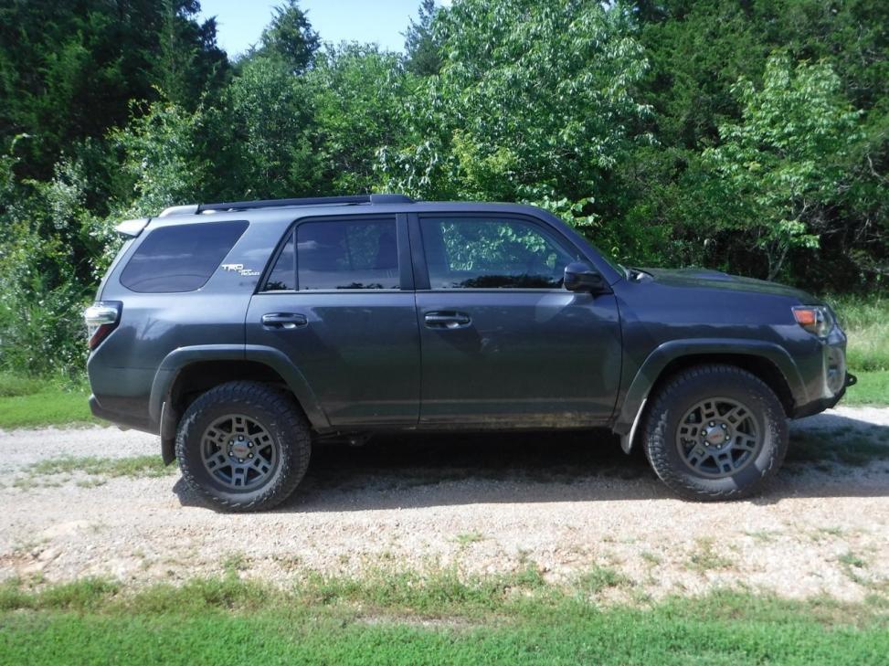

IIRC, the springs provide the lift.
My shocks are at the lowest / 1st clip setting.
My complete Pro Truck lift has been on for about 15,000 miles.
I have a 80lb Warn hybrid bumper with 100lb 10K Warn winch & steel cable.
Plus Sliders.
Looks good to me:

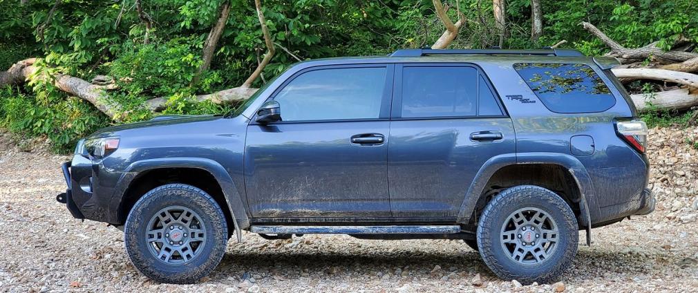

^ Your front end looks like it has sagged a bit in that picture due to the bumper and winch. (compared to the pictures of the white one posted before yours)
Unlike the white 4Runner, there are 200lbs of winch and bumper hanging off the front of mine, plus the sliders and skid plate.
Here's what it looked like with winch and bumper before the lift went on:

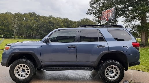

Finished install today. Added the Toytec 1/4" top spacer up front as I wanted to hit the 3" mark. In the rear I went with Wheeler's T12 springs which have given me about 2 3/8" the day of install. I do not have a third row seat. Better pics will follow.
