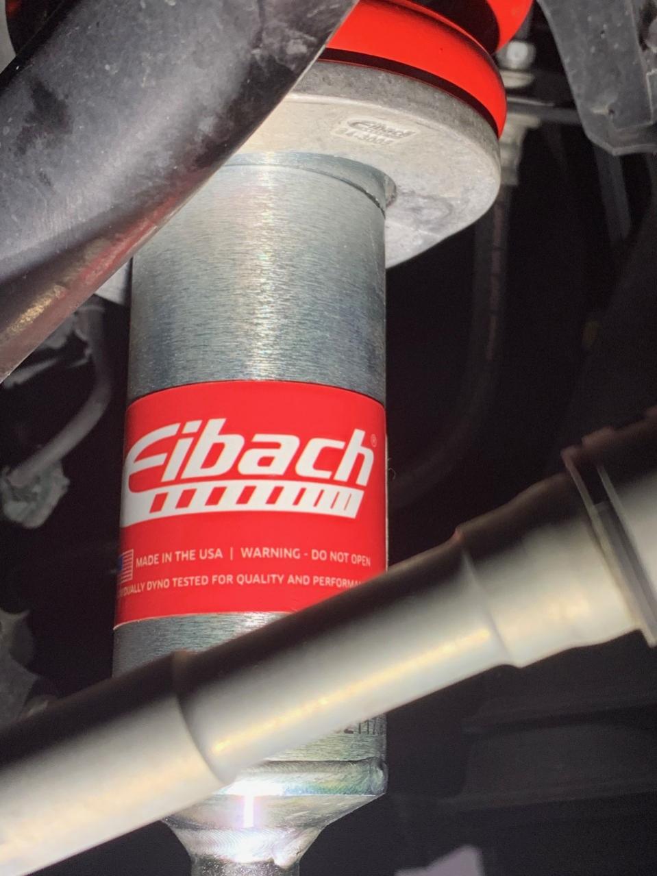

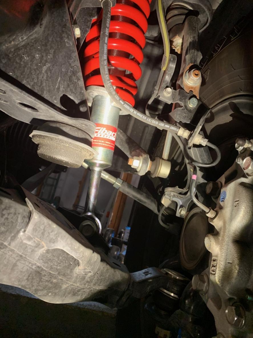

I finally was able to get my wife's Pro-Truck lift installed on her 4Runner. We had it installed at a local shop. We asked them to install the lift on the 1st snap ring perch, which would have given us a 2.75 lift in the front. It looked a little high when I picked it up, but I just thought it needed time to settle.
It's been a few days since the install and the front still appears higher than the rear. I crawled underneath her 4Runner and took some photos to see if I could figure out which perch had been used for the install. I've attached those photos for review. Can any of you guys confirm whether or not these were installed on the 1st perch or 2nd perch by reviewing the photos? Happy to take more if you need them.
Please note, I had the front coils powder coated red before the install so that is why they are red instead of silver.
Definitely don’t see the snap ring on the first pirch. This leads me to believe that your shop might have put the snap ring on the “first” pirch from the top, opposite of what you wanted and yielding the highest lift possible. Take it back in.
