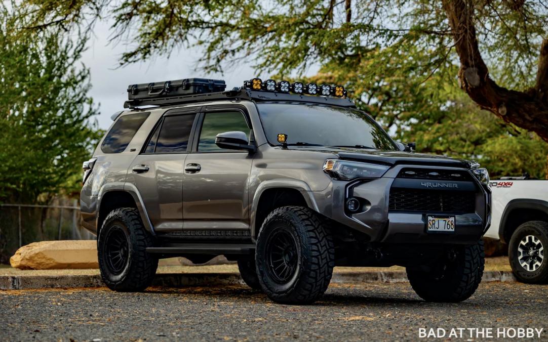

Installed my kit a week ago. Only thing I did differently was use Wheelers T1 coil for the front to get 2.5 lift. Thought the 2.75 up front was too high for my liking. Also went with Freedom offroad UCA to keep my alignment perfect. Kept my stock size 265/70/17 Falkens At3W
hey man, it looks grea!, so you bought the whole kit from eibach and did not use the front springs and instead bought the ones from wheelers? just wondering what is the most effective way to achieve this look
