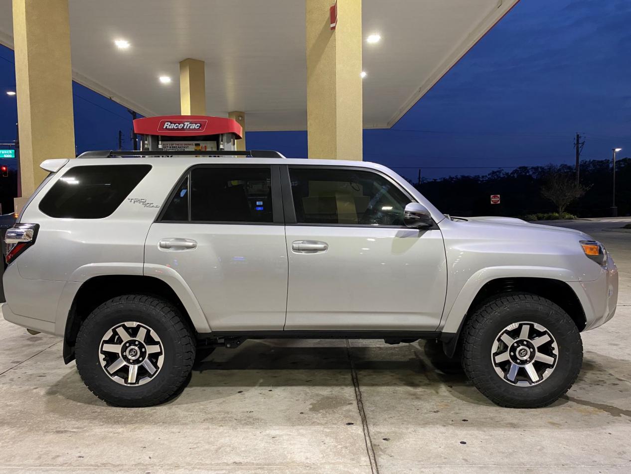

Eibach stage 1 shocks, Wheeler's (Eibach) T1/T13, SPC UCA, Energy Suspension 8.9104R bump stops up front. 3.5" Durobumps will be going in soon for the rear bumps.
I've had this setup installed for a little over 7 months now and I've been very happy with the way it rides.
<a href="https://ibb.co/JrmGHBf"><img src="https://i.ibb.co/ZcGFxLn/4runner2.jpg" alt="4runner2" border="0"></a>
<a href="https://ibb.co/kDpMsZp"><img src="https://i.ibb.co/t2S3TRS/4runner1.jpg" alt="4runner1" border="0"></a>
your sig says you're running 265's? Is that correct? I have the same lift and my 265's look tiny. lol Trying to make a decision on new tires. Probably go with 285/70/17 KO2 C's. Just worried about acceleration and braking.

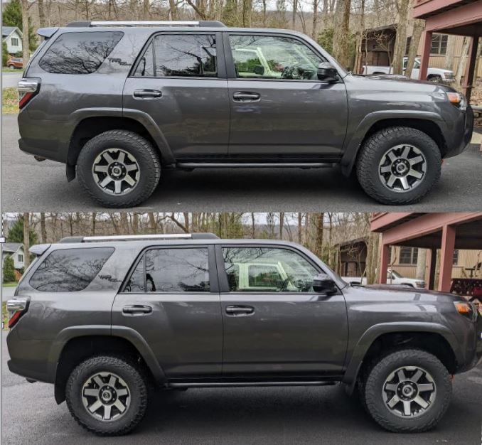

Before after with Eibach Pro Truck lift. Was worried about butt sag but looks great to me. The drive is great. One of the things I chose Eibach for was that it was supposed to feel close to stock and not too stiff. It doesn't feel stiff at all just tighter. Still very comfortable just less lean and nose dive.

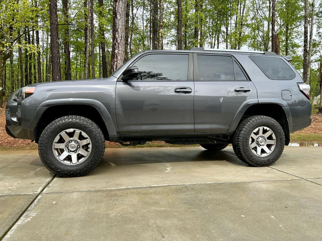

Got the full kit installed a couple of weeks ago on my ‘16 Trail. I decided to go with JBA UCAs while I had it apart. After 500 miles, the ride is much better, but can be stiff at times with the KDSS. Overall I’m happy with it, the stability at speed is a huge improvement. The alignment shop set me at 4° of caster on each side. The tires are 275 Wildpeaks that I’ve had for about 30,000 miles now.
2021 ORP, Eibach Stage 1 kit, JBA's and 285 Open Country AT3s.
Only trimmed the front bumper, kept the mud flaps. Caster is 5.0 and 5.1
Rides great, tiny UCA tire rubs in reverse.

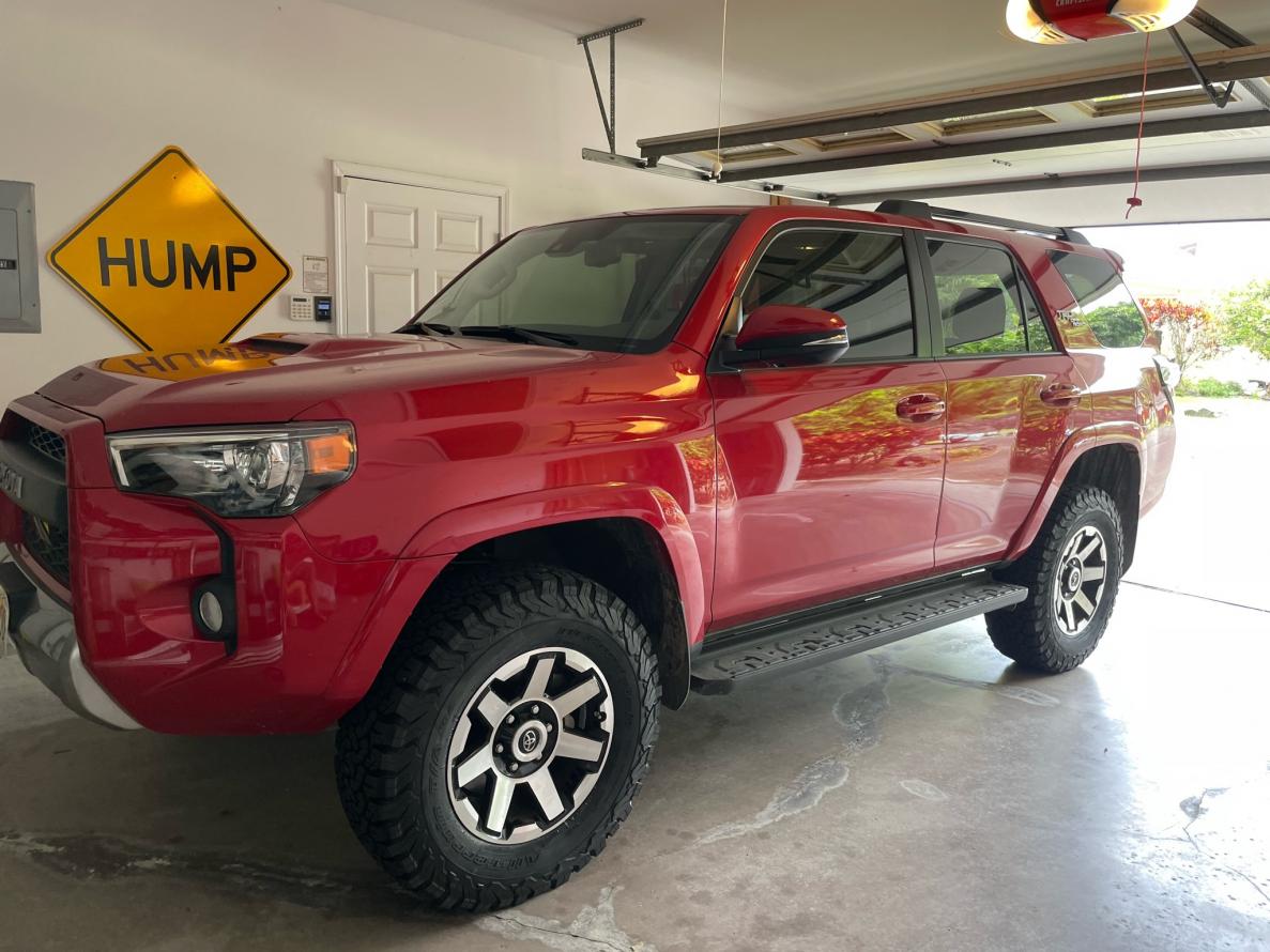

Another happy Eibach customer here. Installed my kit a couple weeks ago and just put some 275/70-17 BFG KO2s on it this weekend. No rubbing so far, but it’s reeeeeeally close in the front with the wheel turned all the way.
