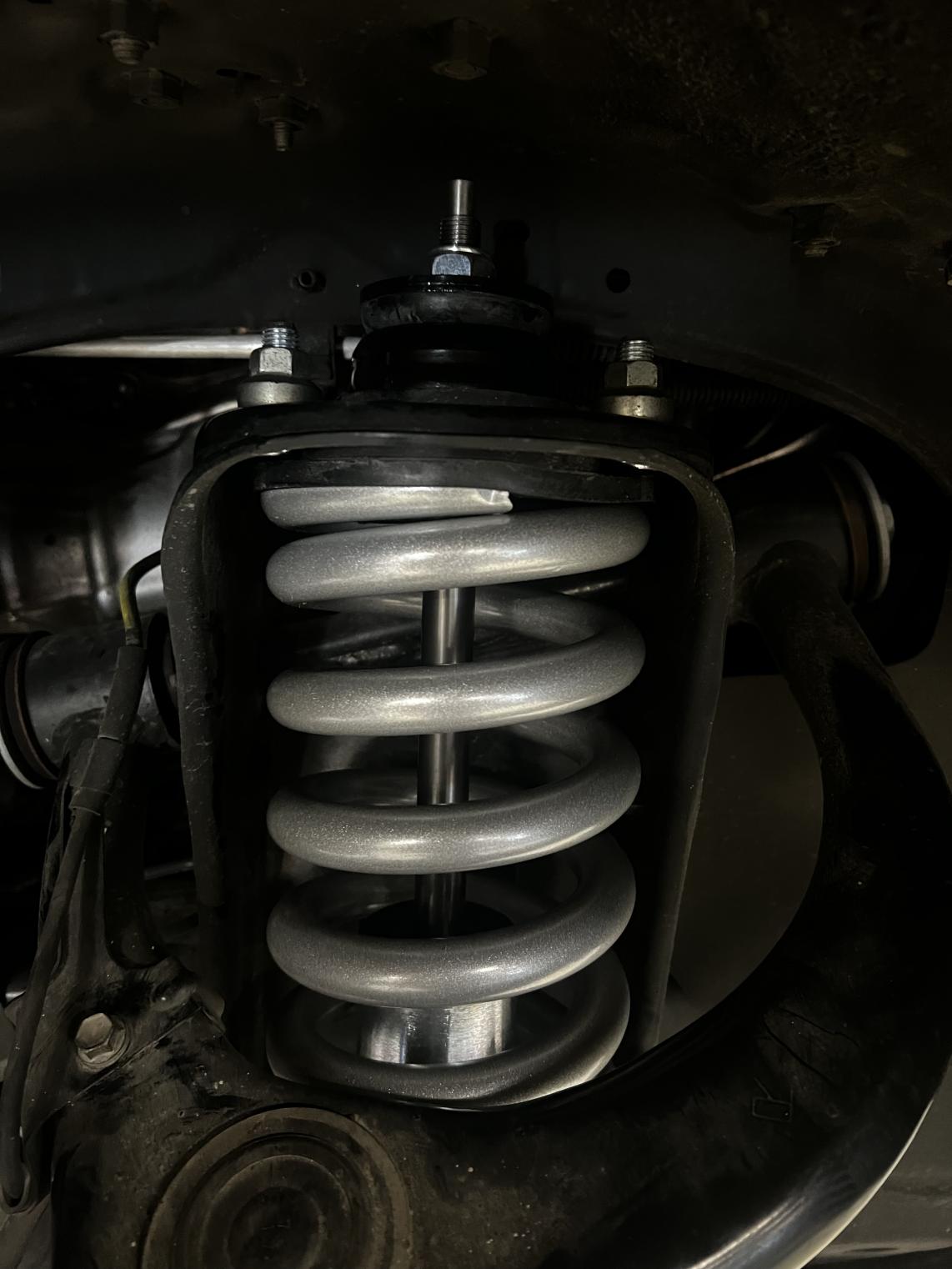

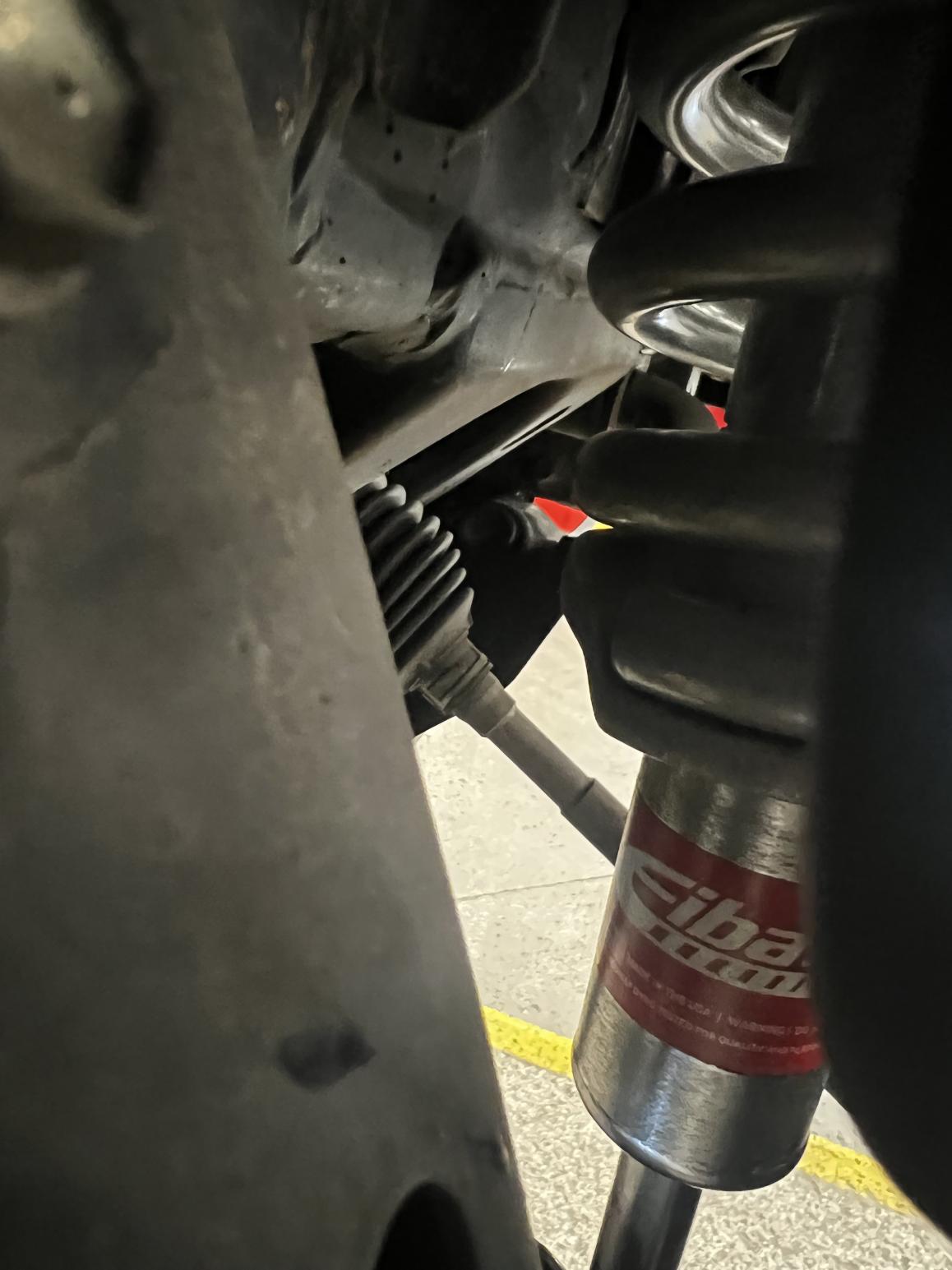

I installed my kit today on my 2017 SR5. It took me about 5 hours using a hydraulic lift with no help. This is my first time doing any work on a vehicle aside from changing a headlight bulb so I felt it went pretty well. My only concern in the passenger side coil over. The only way it would fit was with the "Eibach" logo facing in. If I rotate it 180-degrees, the top bolts will not line up with the holes and I rotate it 90-degrees the bottom wont fit. The drivers side went in perfectly with the logo facing out. Attached are pictures for reference.
I got the kit from Wheelers fully assembled on the first ring. Everything seems to be assembled correctly and the coil overs are seated like they should be. Is this a problem? Pics are of the passenger side.

Is it possible they are assembled/installed incorrectly?
I followed the Trail 4Runner install guide and put it in the same way as the drivers side. There was no forcing or extra work that had to be done to get it to sit properly so I believe it was installed correctly.
EDIT: Correct guide
I was speaking of Wheelers assembling them possibly incorrectly.
My 2.0’s came directly from Eibach, the Eibach logo on the coil and on the top hat are facing outward where they can be read.
I don’t recall being able to see the end of the coil on the top…… maybe look at some others!
Doing some more research I don’t think there is anything “wrong” and it won’t cause any problems since everything is seated correctly. Just drives me a little crazy looking at it. If I have it apart in the future I may change it but it should be fine for now.
