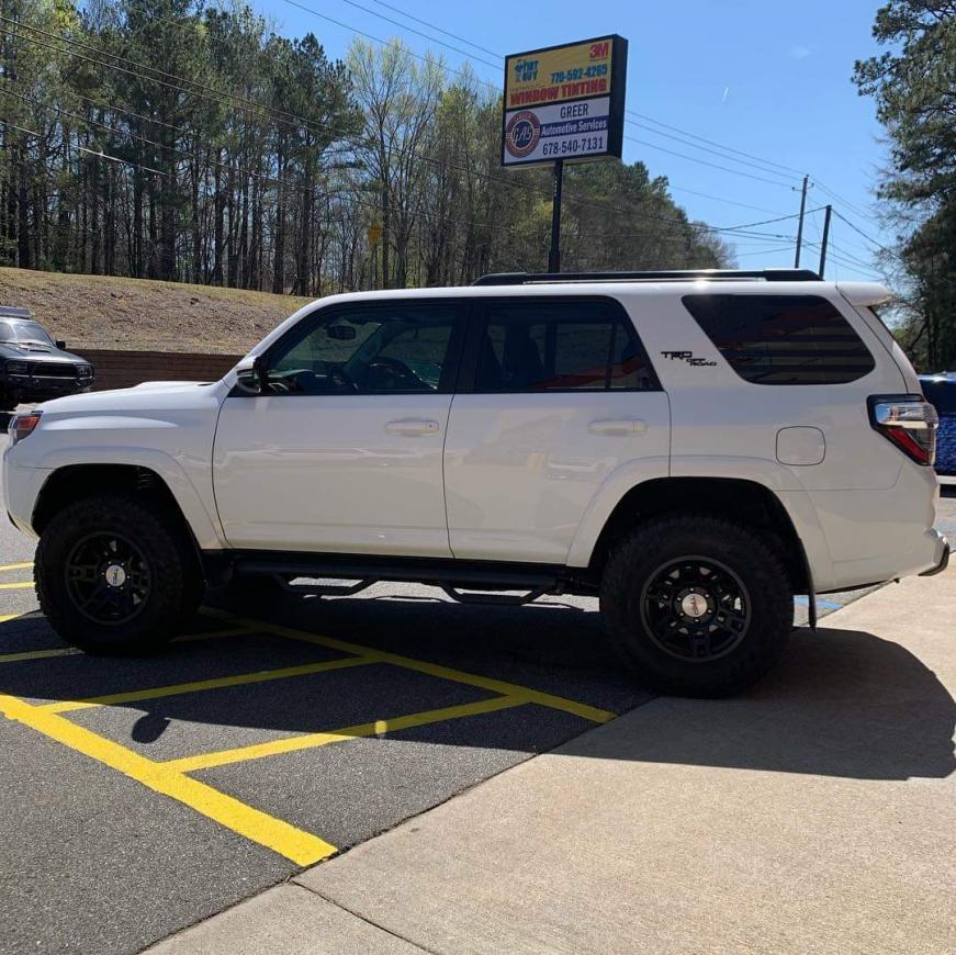

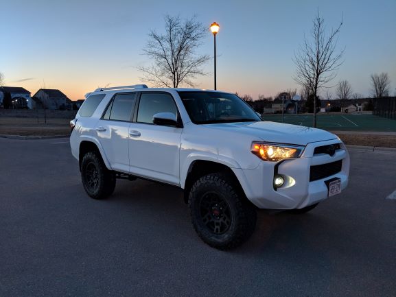

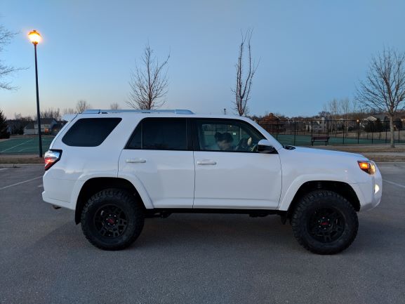

Picked up the 4Runner today and man is it sweet! FN wheels and Falken 285's.

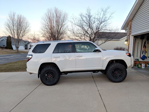

Got the lift installed! :)
Still have to get my bumper and winch mounted and then alignment, then I will take some finished photos.

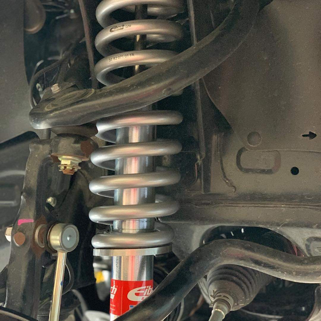

Eibach told me to set the front to the second from bottom notch since I have the added weight of the bumper and winch.
I am just hoping the front sags at least 1/2" or so once the weight is on.
Right now the front is sitting slightly higher than the back.

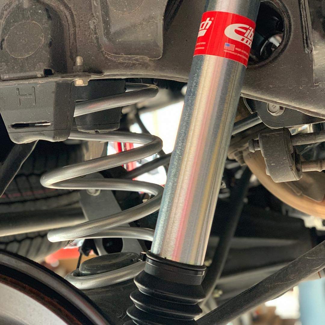

I was slightly surprised to see the kit didnt come with new "hats" ? at the top of the front struts.
Was ok, mine is a 2016 with low miles, I just reused the factory ones.
I think thats maybe why some sights offer the fronts assembled for $100 extra? They have to include the hats then.
Wondered why it was so much money if it was just for assembly.
BTW,,,,, am I the only one that finds it amazing that the only thing holding up the front of the 4Runner is a little snap ring?:eek: haha
