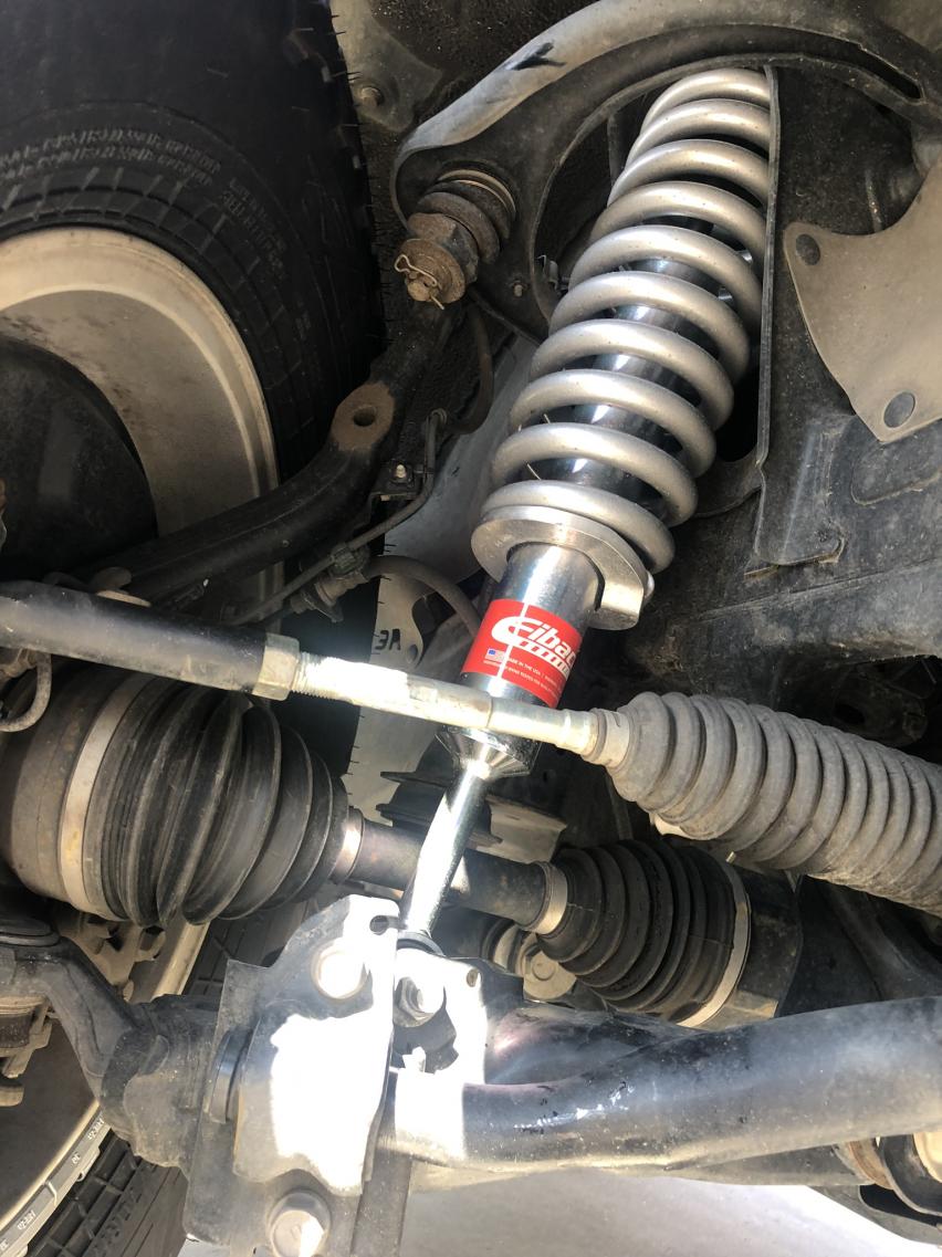

I will do so when I get better light. FWIW, the Eibach label printed on both front springs is right side up, if that matters. Does that, by chance, indicate if it's correct?
Edit: I just looked at the instructions online, and they indeed say that the logo on the springs should be right side up, so we should be good there.
That's not the part I was referring to. When you have a chance, take a picture of the bottom of the spring and how it sits on that plate that is resting on the snap ring. This will tell us if that plate is upside down or not.
Driver's side:
Passenger's side:
Confirmed, your lower spring perches are 100% upside down. Also, the ball joint looks damaged (ball joint could just be bad picture).

Hopefully I did this right. Someone reply if the images aren't here.
Like I said, the front needs to settle a bit. Looks good overall, though.
the 9" wide wheels looks good IMO. Get those spring perches swapped and you'll be good to go.
I believe it should look like this.
