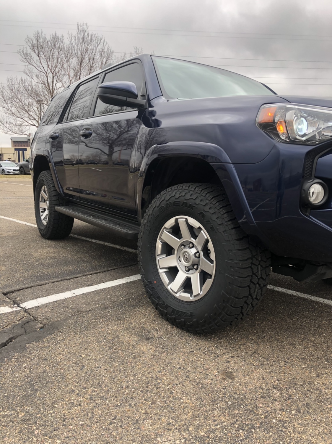

I agree with the majority of your review. The ride improvement is remarkable and the nose dive is virtually gone. I opted for the heavier LT285 Falkens on the stock trail wheels at the advice of the install shop. As expected, I did immediately notice a decrease in power and MPGs - I think I am getting somewhere around 15-17 MPGs combined. The independent lift shop did not encounter any issues on the install (with KDSS equiped) or with the alignment with stock UCAs. Currently, I have not experienced any floating at highway speeds and everything trails straight. I think/hope the stock UCAs will be fine for the occasional light to moderate trail riding. I am considering UCAs if I plan to attempt anything with significant articulation.
The fender mod was needed and the front flaps were removed because of the rubbing with the 285s. I do think I have some minor rubbing at full lock reversing to the right and I will confirm this when I get a chance.
Overall, I am very happy with the kit. In hindsight, I do wish I had the opportunity the compare a 285 setup to a 275 setup - I am wondering if there is a noticeable difference in loss of power between the 275s and 285s.

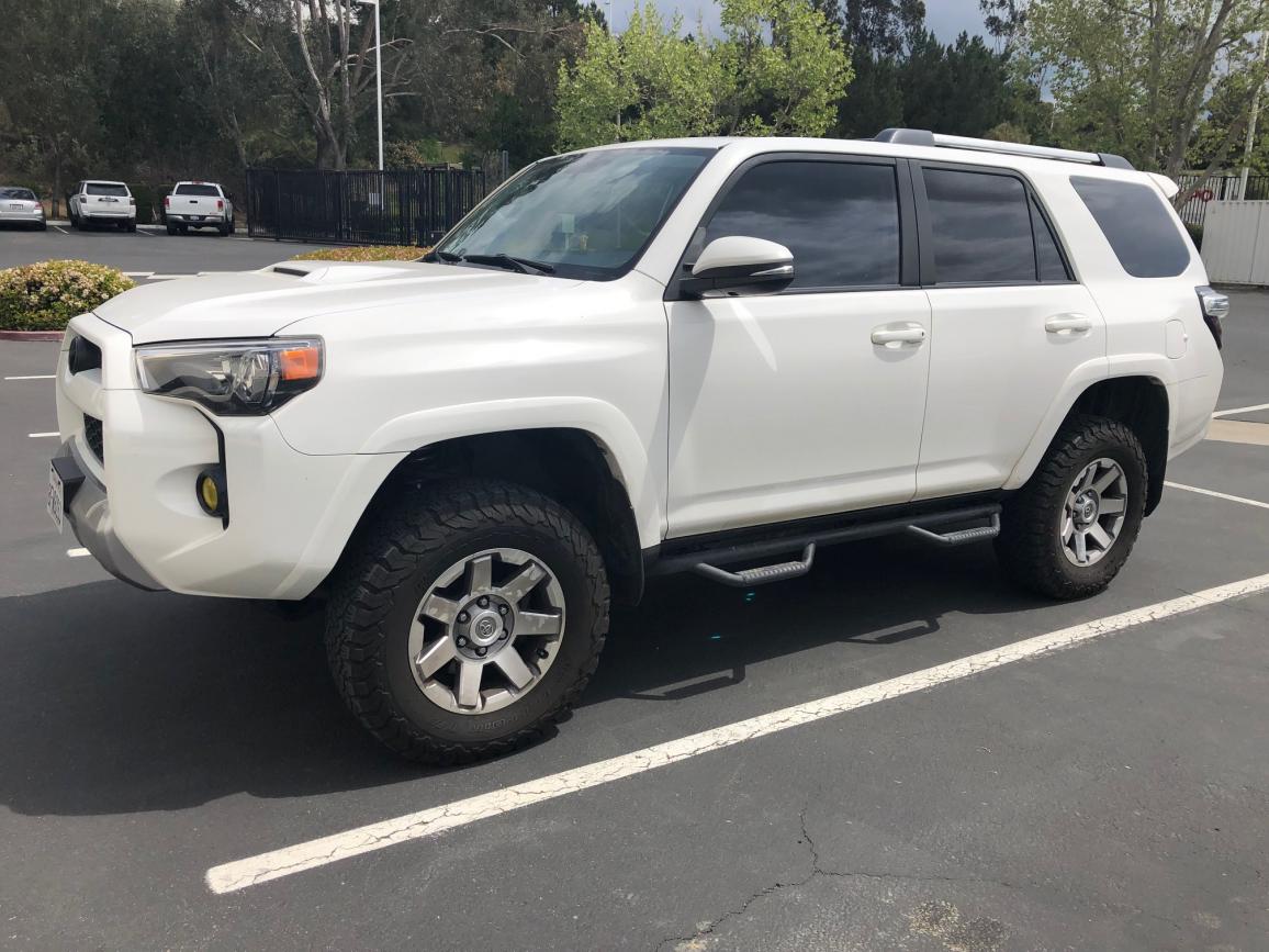

Hopefully I did this right. Someone reply if the images aren't here.
Like I said, the front needs to settle a bit. Looks good overall, though.

Looks good!
I think your issue is that you lifted the front 2.75" and didn't lift the rear, correct?
If so, this will put you 1" higher in the front. If you want it level, then you need to lift the rear 1".
Looks good!
The rear is lifted 1" with the kit, and supposedly, the goal of the kit is to lift and level. I'll give it some time to settle. We're on the lowest setting in the front.

Are you certain the lower spring perches on your front suspension are correctly oriented? Sometimes people put them in upside down and it gives the vehicle more lift in the front than intended.
If it doesn't improve, I'll have them check again. Like I said, I'm a bit new to all of this, so I have to go at their word.
Yes, this is common. Get a pic of the bottom of the front springs.
Where was the snap ring set? When I received mine it was set higher for added weight. Took me more time then I care to mention to figure it out. The instructions kind of contradict each other.
I will do so when I get better light. FWIW, the Eibach label printed on both front springs is right side up, if that matters. Does that, by chance, indicate if it's correct?
Edit: I just looked at the instructions online, and they indeed say that the logo on the springs should be right side up, so we should be good there.
