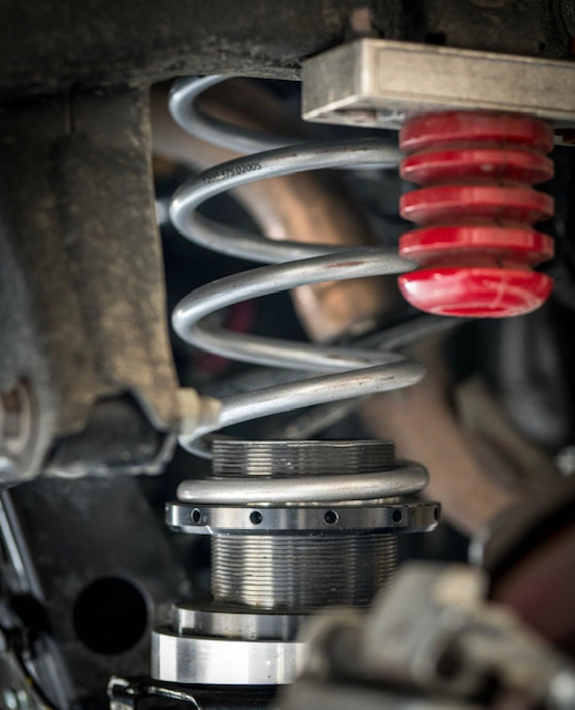

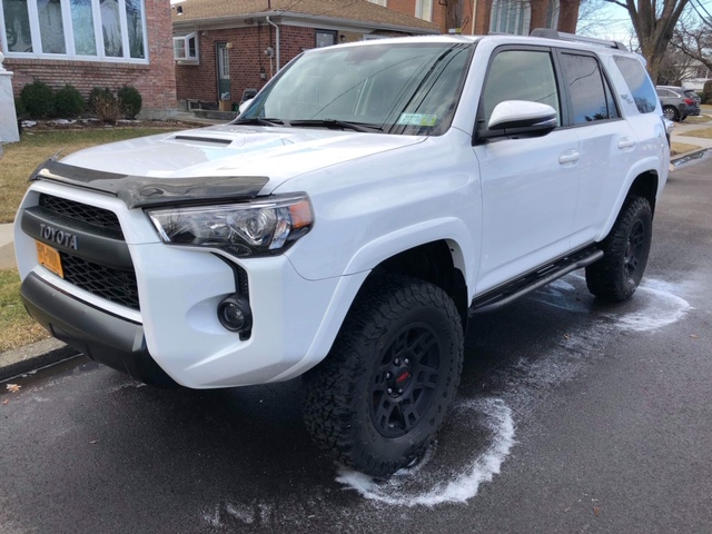

Had my Eibach Pro Truck kit installed at RPM Garage yesterday. Still running the 265 BFGs that I bought my TR4 with, for now.
V_4U2v-ICsHA60zGI90chZv5VfE8QO276PiTevl5D3Wm3KMpLMblqaNpKlbFvPm067X8Fgfrx3ws0ynM_7rcwCn30ICD-5aA0LnVARwKjNGkImPT46aSL6eApauLczH5FMX2_HR9Yg=w2400
dH_kQQLXc8YnvEGPg1Jjhpl7UwLrbufFEAAhtYSp3ycVD-yTBnYL_H55YXjfs6rXaMAyGIk7HsckhY4xLNqDeKzlSzsJsz25lqhPnTUL4wwXC0TthB55x2YXb3e850vyN50edeyQuA=w2400
j8slsaDaVeUe4HRj0RQfwPUvTjsTi9AlyURCG2C18bgIv5z3I4bj13vdBFVC-9qiHTj0U5z6mKW28bhPQIFRuQ2InT6QP-L0jNFg0S5jaUox1cyobksKJ4BDJZkFgTloYUrtrybp2A=w2400
9FnlYpiu1okWSOO2Kn4Az-WTER8a6oUola7Bro-AIwKR1vcrrOVKqG9ahe6vF2cBvTfYdEzxACzLjTyls2k4HhUub-qD3ffTYhNaslRE2wdIDVJTLgluzOQkgnoDfOGqZ_3b7OvO5Q=w2400
What settings did you use? If you already posted this, I may have missed it.
