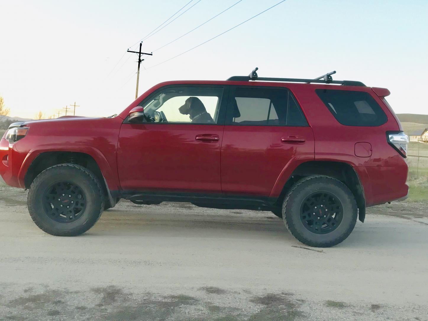

I'm not running that size but I'm running this lift with 285/70/17 Wildpeaks for about 7000 miles now. I love the look and have no issues, minus a slight rub at certain times in reverse turning all the way. I am sure someone is running 285/75/17 and it's floating around on this forum somewhere, but I don't remember seeing it in this Eibach lift thread. I think 295/70/17 would take some work to clear but would look great.

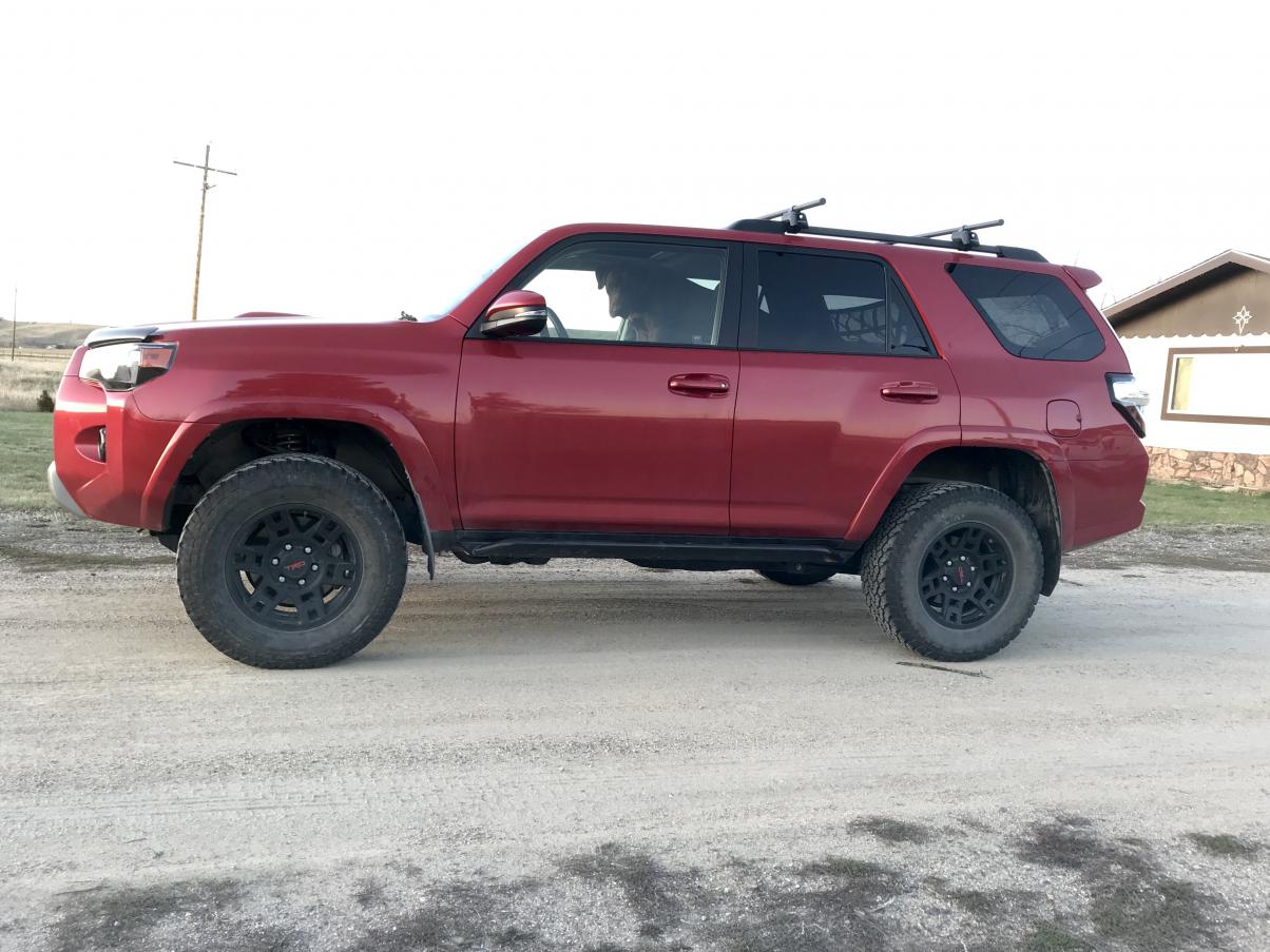

Now that I've had the kit installed for a few days, here's a summary of my thoughts.

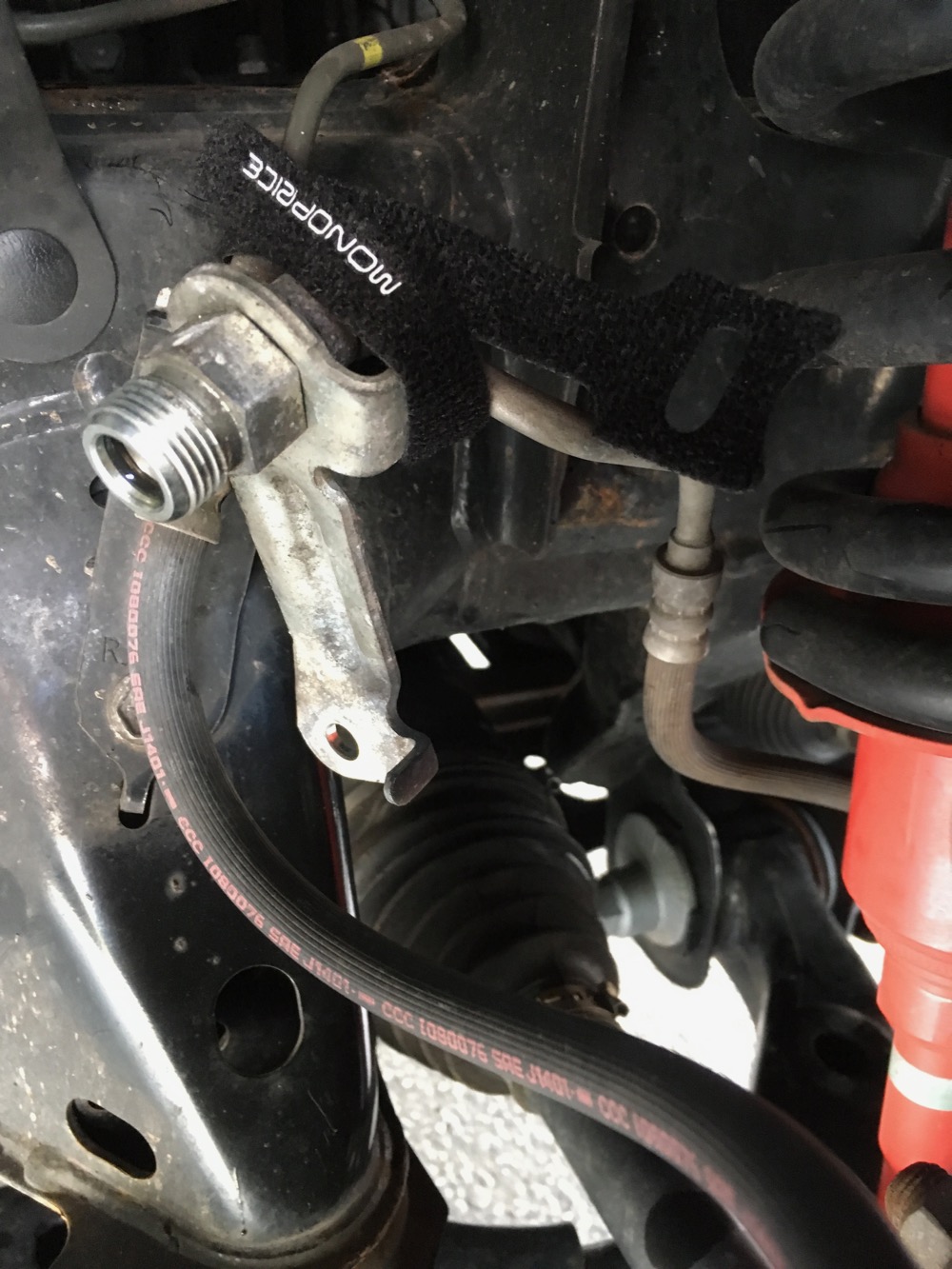

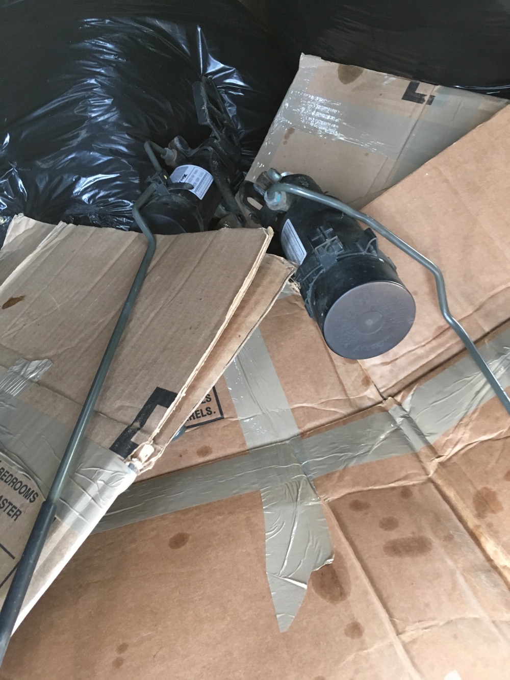

So I started doing research on suspensions and finally decided on the Eibach kit. Once it arrived, I made an appt to have it installed about a week out. Knowing my time with X-REAS was limited, I started to tinker. First, I disconnected one rear X-REAS shock by unscrewing the fitting at one of the check valve points. I read that you're supposed to have the vehicle on a lift when doing this, but, hey, I was feeling adventurous! So I SLOWLY unscrewed the fitting, and surprisingly it came apart without losing a drop of hydraulic fluid.
So I took the truck for a little ride. Hmm, it doesn't ride any different at all. Exactly the same.. So I then disconnected the other rear shock, when for a ride, exactly the same! I came to the conclusion that my X-REAS was shot. No evidence of leaking, so maybe it lost it's gas charge from the center absorbers - I don't know, nor do I really care... I then proceeded to disconnect all of the X-REAS plumbing (still while the vehicle is on the ground) and tossed it into the dumpster..
Once all of the plumbing was removed, I used some cable ties to hold up the lines attached to the shocks while driving. I drove like this on the disconnected XREAS shocks for a few days with no ill effects.

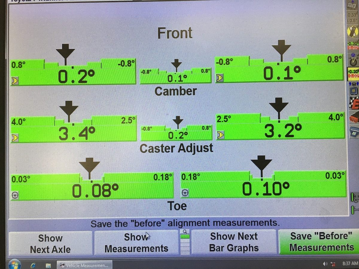

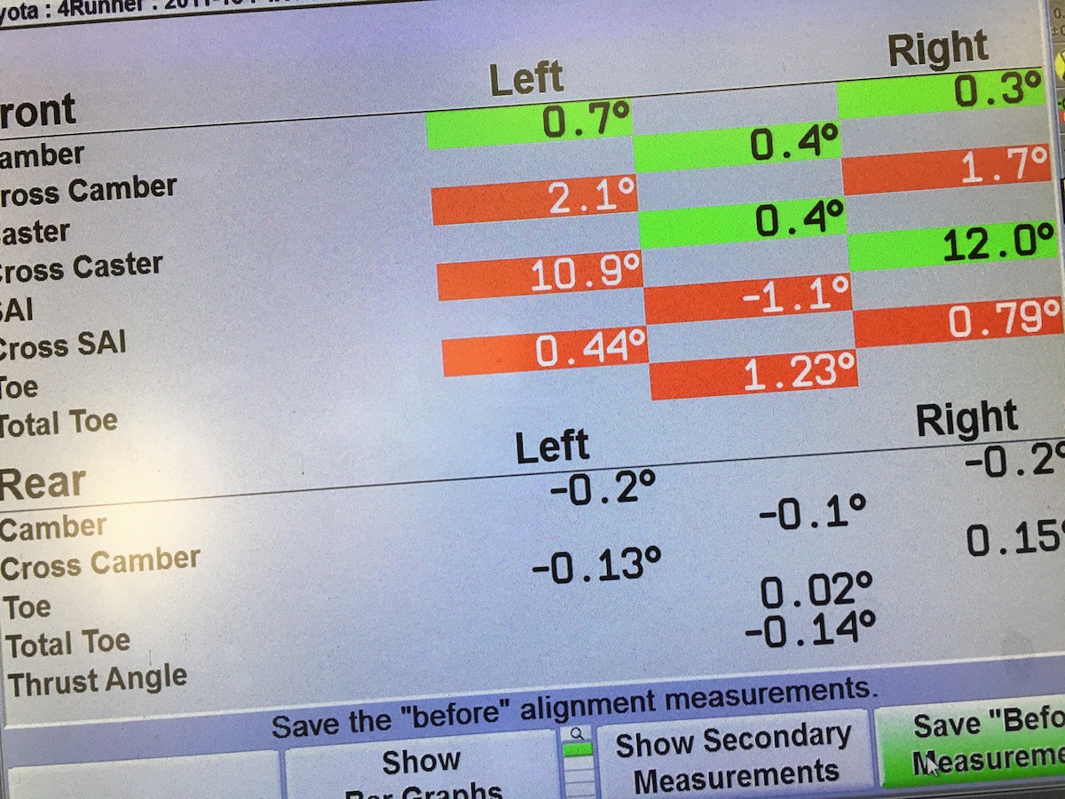

Now that I did this installation myself instead of having my shop do it, I used my original installation appt to have the shop check over my work and perform an alignment.
Pleasantly surprised how the alignment came out being that I have stock UCAs.
Before:
After:

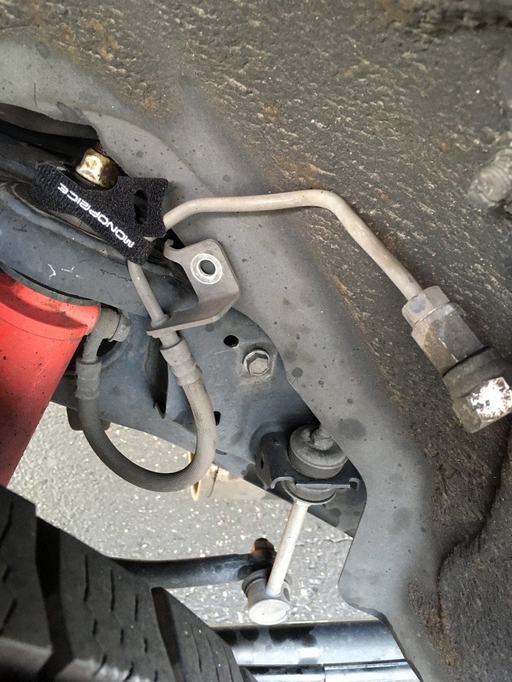

My shop tech commented on how nice the Eibach kit rode and says he now wants the same kit for his truck (an older Taco). After the alignment, we also noticed that I had a little rub on the front fender liner while in reverse. I fixed that in 10 minutes by doing the fender liner mod. I now have about 1/2 clearance at the tightest spot in front of the tires. Plenty of room behind the tires and a BMC isn’t even close to being necessary (with 265’s that is..).
Thoughts on the ride:
** I have no experience with other 4runner suspensions other than my probably-broken X-REAS so take my opinion with a grain of salt.
The ride feels firm and sporty, yet not harsh. Honestly, I was expecting it to be a little softer, but it rides great and the truck feels tighter now. Big bumps get soaked up nicely. No dramatic body roll or nose dive (which I didn't have before either) so that's good. Highway driving is excellent. I haven't been off road with it yet..
All in all, I have no regrets. It's a major improvement over what I had, that's for sure. I think the truck is quieter now too, if that even makes sense.

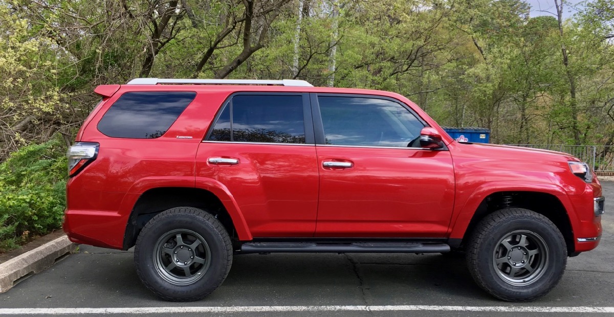

I got everything button up today. The rear was so much easier. I'm very happy on the stance. I went over a lot of potholes this evening and it just soaked them up. Heres a pic I took late. Still running stock size 265 70 17 general grabbers.
