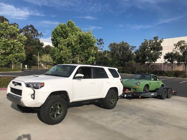

Since installation in March, everything has settled perfectly and the truck handles corners fantastic. Sometimes I forget that I am in a 4runner when cutting corners around town. I did end up having to swap out the set of LT285 Falkens E load due to balancing issues. I am now rolling on 285 Ridge Grapplers (which were successfully road force balanced on the first attempt) and everything is running smoothly. As far as I can tell, no rubbing with the 285 RGs on stock UCAs and with the fender mod - I did have a little rub in reverse with the 285 Falkens. Overall, the kit was a great purchase and I highly recommend it. I have a few trips planned this summer in CO & UT - I will report back on the off-road performance.

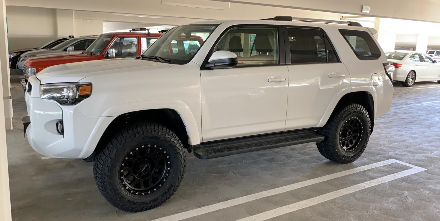

Lift installed today on my 2018 SR5 with Method Mesh wheels and Falken P285's. Stance is perfect and like the previous reviews have mentioned - a significant improvement over stock ride/handling.
Eibach adjustable front shocks set to 1.6".
Stock front coils.
Stock rear end.
Firestone Destination A/Ts P285/70/R17
Love the way it rides. Great on and offroad handling.
looks good!..any rubbing
Thanks! The shop pushed the fender liner forward and removed the front mud flaps prior to install so I don’t know if it was necessary. No rub on the body mount at full lock on the street... I guess it’s possible there will be a little at full lock when not on a flat surface. (Running stock UCAs)
