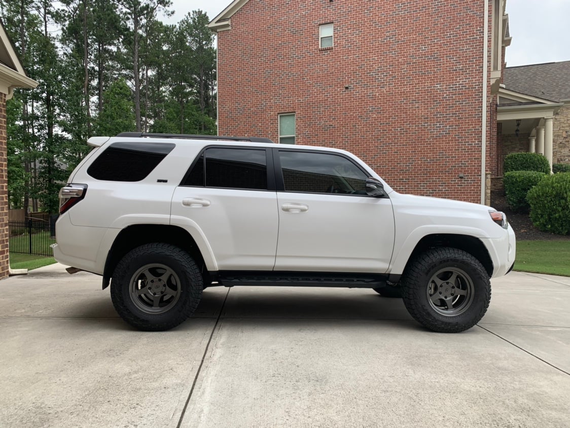

Yes. The pic is after about 3 months and 3,000 miles on the Eibach Pro Kit. Lift height measurement hasn't changed.

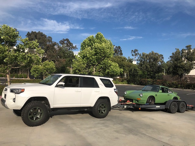

yeah I saw that pic, nice 911. I have a 996 turbo
Looks real good.
However, now you "need" a TRD or other brand skid plate.
I kinda wished I bought this Arb skid plate set instead of the Toyota TRD Skid plate.
